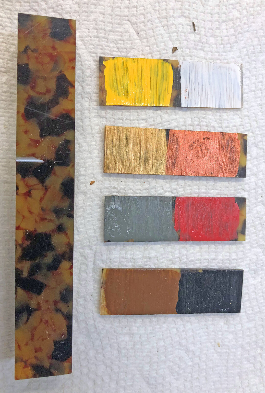

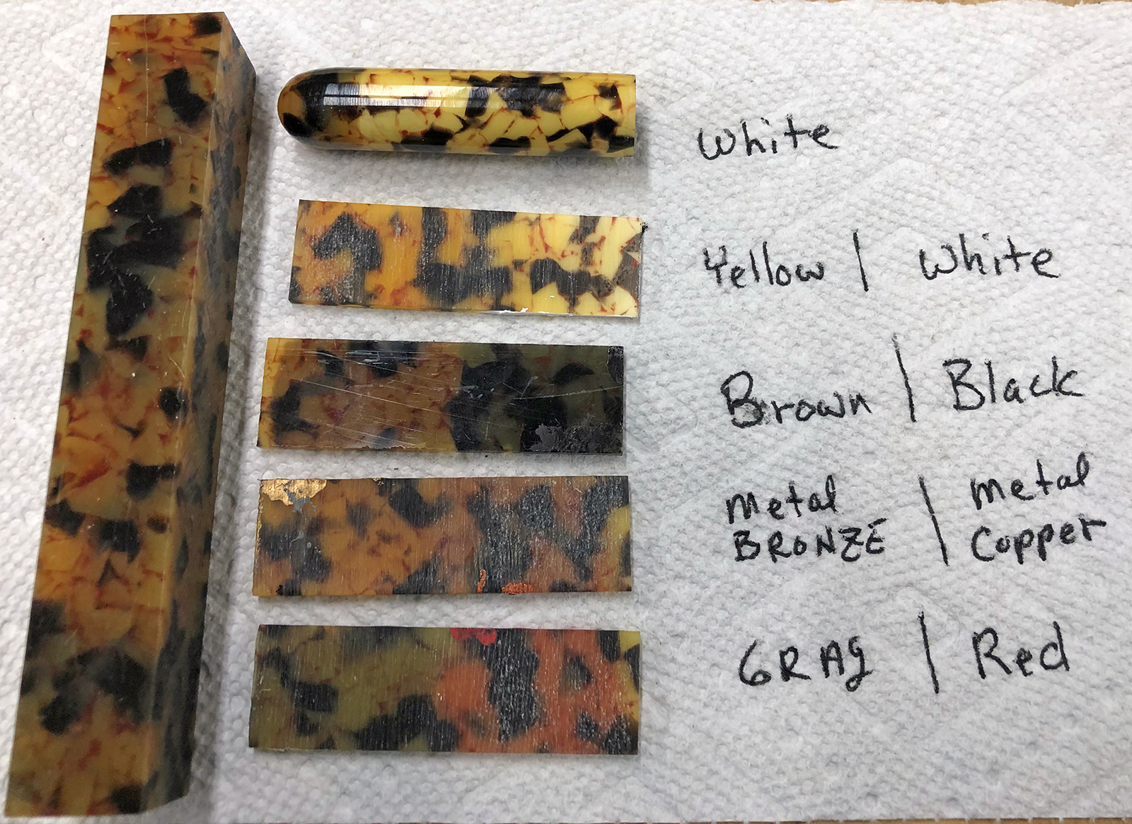

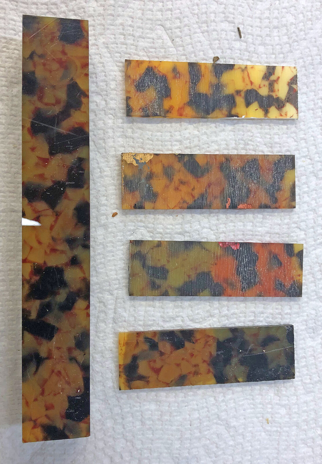

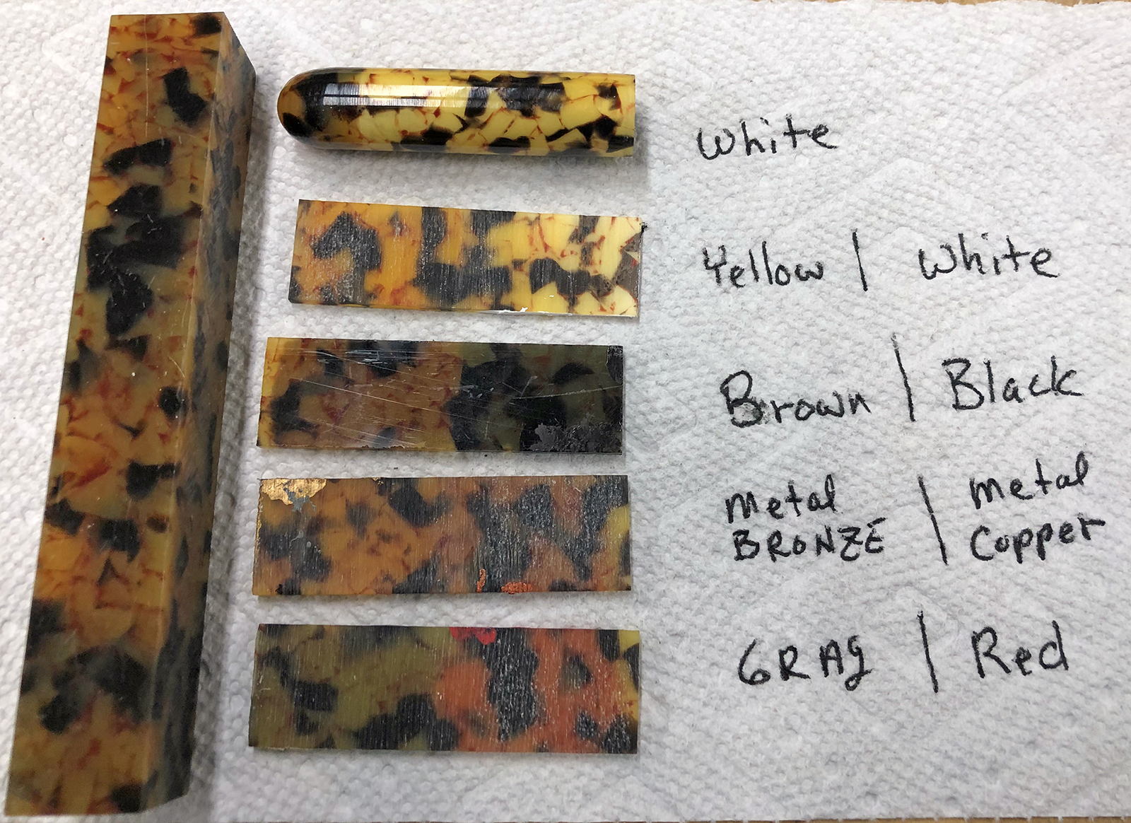

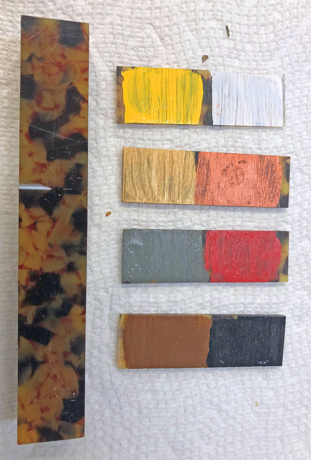

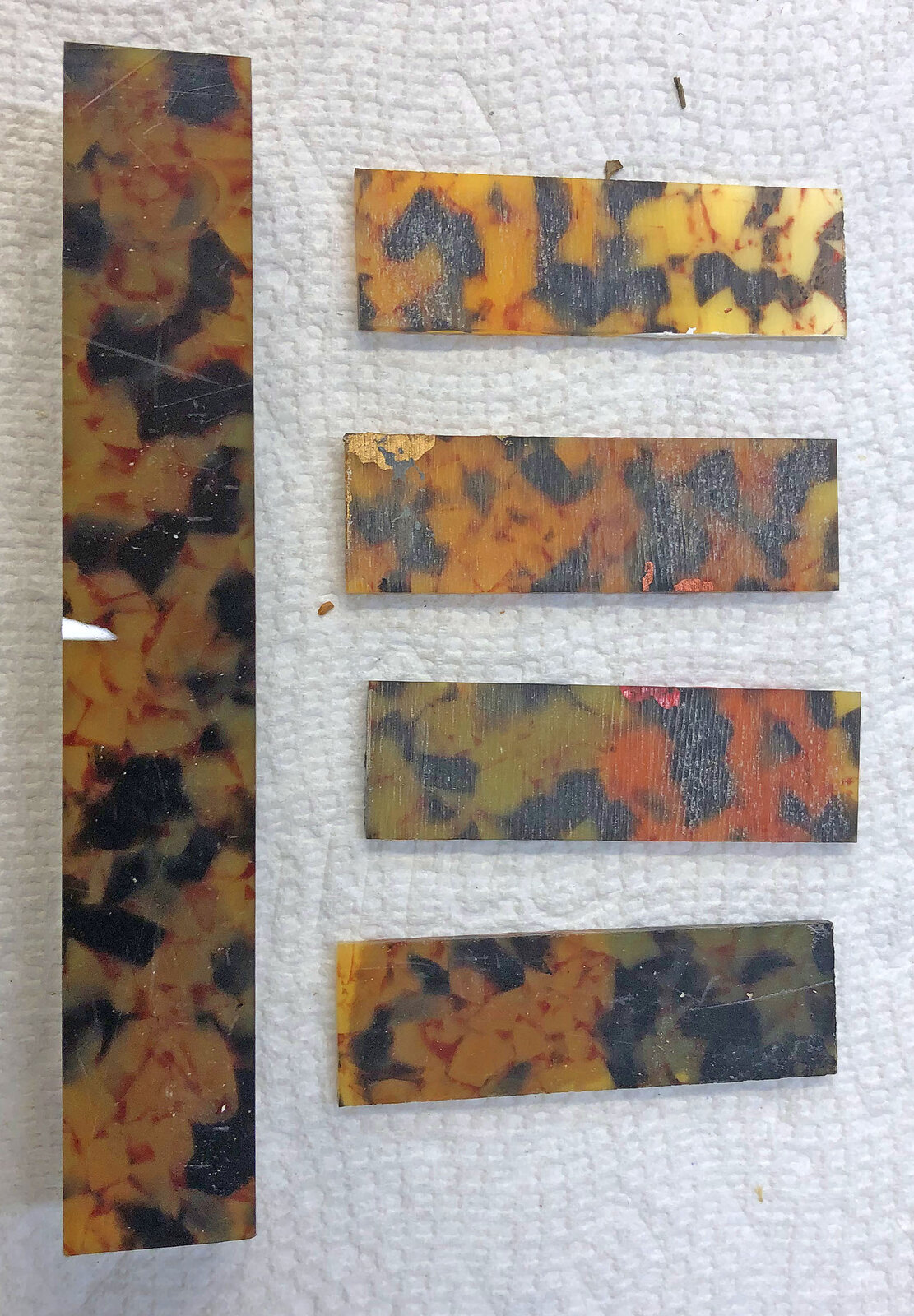

Here is another one of my anecdotes. I have some really nice Acrylic Acetate blanks called Tortoise Shell that I bought with the intention of using it on a kit-less pen. One day I decided maybe I would use it to make a closed end kit pen because I haven't made the leap to kit-less yet.
Anyhow, I prepared the blanks, drilled, and glued the tubes in. I made the assumption that the inside of the blank would need to be painted, however, being too impatient to do any kind of testing, I chose white -- usually a good choice for most plastic blanks as it usually keeps the brightness and vibrance of the blank after turning.
Much to my dismay as I turned the cap of the pen down to near it's final dimension, my folly became grossly apparent. The closed end (undrilled 1/4-inch or so) of the blank looked great, but wow, the area that had the tube was significantly different. The gorgeous reddish browns in the blank had turned a pale yellow!
So, to prepare for the next time, I sliced off a scrap piece of the blank into 1/16 inch thick pieces and painted one side with various colors that I had on hand. My experiment confirmed what John Underhill already said in this thread, painting with a color similar to the blank helped significantly in preventing the color loss - and preventing a dramatic color change.
The picture is a good indicator of how dramatic a change the paint back color can make. Obviously the next time I decide to use these Tortoise Shell blanks to make a kit pen, I will paint the inside of the blank and tube with brown or maybe brown with just a drop of yellow added to lighten it up.
Regards,
Dave
This was my original picture that shows the turned piece along with the blank and painted samples:
These show the blanks along with the paint on the backside (not in the same order as above).
Regards,
Dave
Regards,
Dave
View attachment 372982 View attachment 372980
Great samples. Heck of a good idea.

Dave, great idea to cut a lengthwise slice and check the blank colors against paint colors.

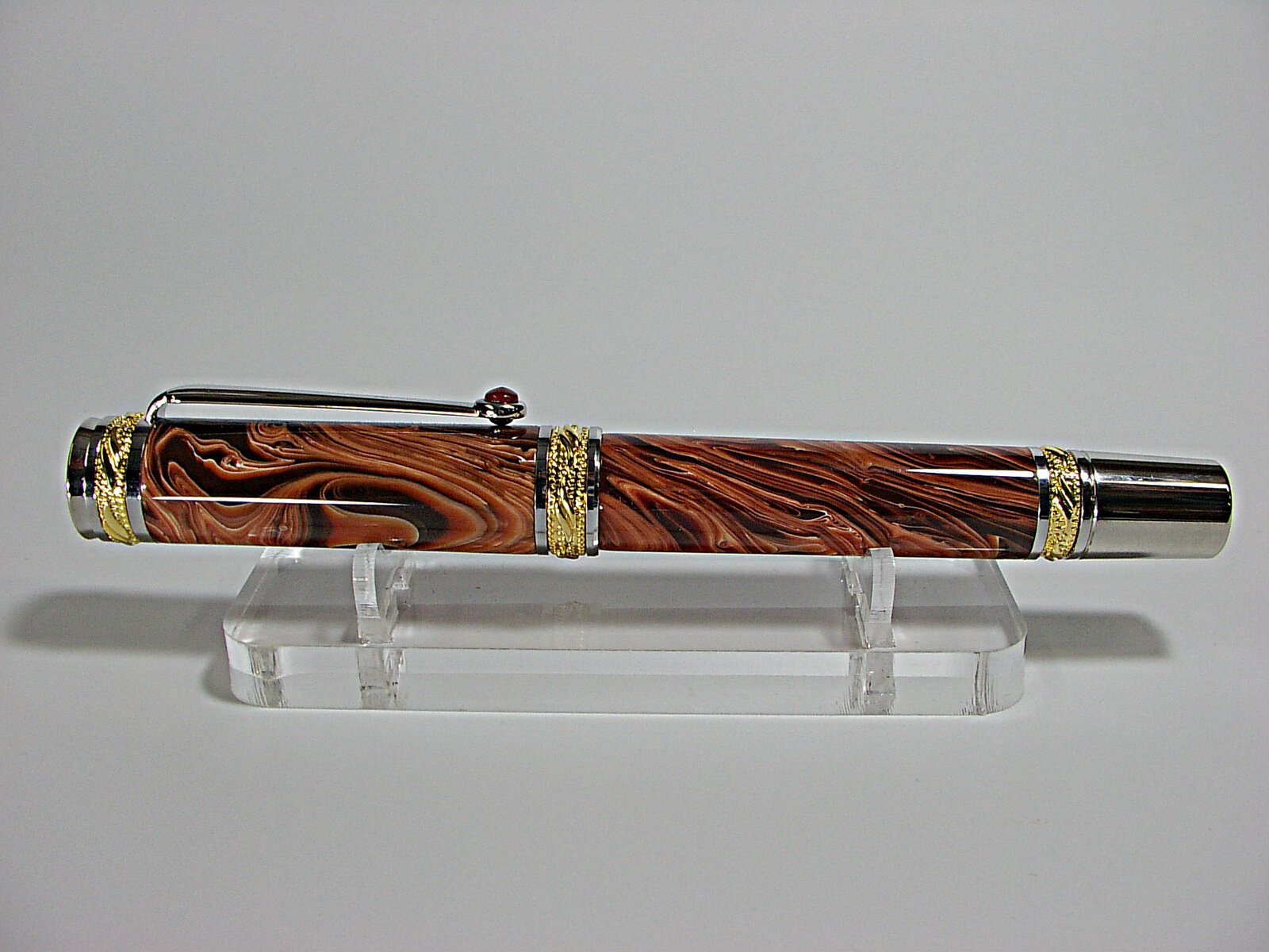

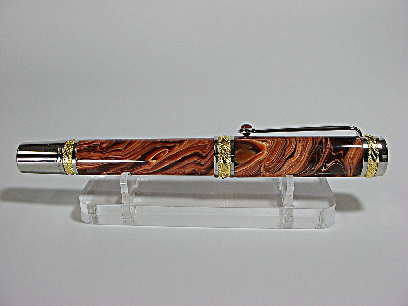

No casting. This was a trustone blank called Mexican Agate. One of my favorites.
Never head it referred to as trustone before. But I know what you are talking about; they make beads/rings/bracelets out of that in asia. I have never (knowingly) seen a pen made out of it. Its resin "stabilized" rocks.
Getting a 7mm hole in that thing must absolutely murder drill bits. the lapis/jade/opal bead operations around me; they buy 3mm drill bits by the kilo! And the polishing/shaping is done on very expensive wheels.
How did the glue up go? Did the brass stick to the "trustone". What about the finish?
Almost - it's rock dust mixed into resin. You are right that it messes up drill bits very quickly! Here is a link to give you an idea what is available: https://www.makermaterialsupply.com/collections/trustone
This is where I get all my TruStone from. https://www.randbcrafts.com/items/tru-stone-blanks?a=1&page=1
As far as working it goes, it is really not bad. Some colors are easier than others because of the make-up. drilling needs to be done slowly with good cooling of the bit. Finishing is just polishing with MM. Turning was done with carbide cutter and final laps with a good sharp skew as I always do all my blanks.
Here is another TruStone blank that I love to use that I think is spectacular color. It is called Banded Malachite I also have used Black and White Mother of Pearl Trustone. Again all turned and finished the same way.
