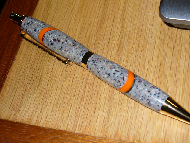

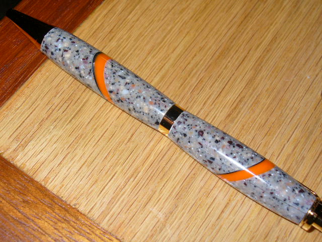

Maybe others have noted this, but just for grins, I polished one end of this pen with One Step Plastic Polish, and one end with toothpaste. I can't tell the difference; see if you can. The pen is corian, sanded to 1500, one end polished with One Step and one with Crst. And now my lathe smells minty fresh! Crest is cheaper, I suspect.

Just for closure, the cap end was toothpaste, and the nib was plastic polish. As for the Toyota plant, it is pretty much completed and so far slated to stay empty for now. Lots of people made lots of financial commitments, and I hope they will do as they say, and start making the Prius there , maybe next year.
