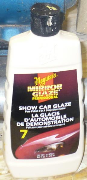

I think you are right on the grit, I was going by memory and that is dangerous for me. I can not find a grit comparison chart either. I did find a reference on the Yahoo penturners group stating Tripoli is about 1200 grit and white diamond is about 2000 grit.
I do know that I tried about 5 different types of buffing compounds and I was not happy with the results. I tried the McGuire's after a recommendation and I have been extremely pleased with the results. I have been trying to remember the McGuire's product name of what I use (*%#& memory!). There will be other brands that will work as well, the point is to stick with a very, very fine grit.

I finally found the info:
Meguiar's Mirror Glaze; Show Car Glaze, #7 grit rating. Great stuff.

McGuire's is spelled "Meguiar's". Hi Brad, I'm not being a smart a$$. If someone were looking for it, since there is a McGuire's Mirror Glaze as well. Google knows!
