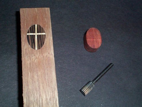

Perhaps, but I do know my method will work, because I made one today very similar to his. I don't plan on turning it into a pen, I just wanted to see how long it would take to make it.
Out of curiosity did you have the cross in your test piece?

Yes. I can post a picture of it later on. I didn't bother to measure anything, so it didn't come out perfectly aligned in the blank. I just eyed it, to see if my way would work.

Well, this is it. I also show the tool I used and the pattern I used to mark the cross inlay. The inlay itself was used to mark the blank. The inlay goes about half-way through the blank. It is rough, and larger than the ones you have made.
You say it is larger than mine.
That is a big problem with designs,The width.
I try not to have them "wrap".Are you planning on turning this to see what it will look like after it is turned to the dia. of a pen?
The othe obstacle I found was getting the cross "centered" to the vericle line of the blank and yet have the "cross bar" right angle at the same time.
I see you encountered that also.

No, I don't plan on turning it. I know this will wrap around if turned. I was just seeing how this would work.
I really just eyed things up for placing the inlay. A small "square" tool, and guide lines would have helped get the cross straight(er).
I found the smaller I made the inlay the more difficult to "execute"
It came out great considering you were "eyeballing" a concept.
