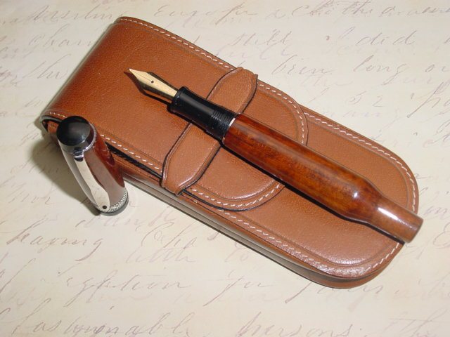

Well boys and girls... It CRACKED!
[:D]
I knew it would. Too many people talking about it not to. [;)] Right on the bottom portion of the cap near the center band. Since I decided to keep it for myself, I am not too worried about it. I think that when I get some time, I will strip the parts off of the cap and fix it. I should be able to make it invisible.
Looking at the pen closely, there is only the one crack. Snakewood though when looked at extremely close has a very whispy grain. Loose in some spots. Imagine dry bambo, or celery. I noticed when I was turning it that it was very similiar to Ebony as far as the heat characteristics causing fine fissures. Especially when sanding the blank flush to the tubes. More open grain than ebony though.
Anyway, I will let you all know how the repair and refinish goes. I have too many other pens to turn right now to mess with it for a few days.
If nothing else, I got a great front page photo for my website out of it...Since I took the photo before it cracked [:)].

Here is El Grande Streamline I did in snakewood. It has been around for over a year and has not cracked. It is tubless on the body and a tube in the cap. I think leaving as much meat on the pen helps, I also think leaving a tube out may help. That is just speculation, as my tubeless ones have not cracked. Also, they have not left the office and under the same temp all day. I still think it is just a crap shoot using this wood. That being said, a split snakewood pen is sure alot prettier than many other wood pens that have no cracks. [:p]
I think the cracking should not deter someone from trying to make at least one snakewood pen. Then you can form your own opinion about this gorgous unfriendly wood.

I picked up a new set of punches today and got the Baron apart without further damage. I put the snakewood cap back on the lathe. I think it is going to be more trouble than it is worth. There are cracks devoloping everywhere on the cap. Not on the body though. I think I will make the cap out fo a contrasting wood. Not sure what yet.
James
Fangar,
This is undoubtedly one of the best pen I've seen. My wife and I feel so sorry that it cracked. [V]
