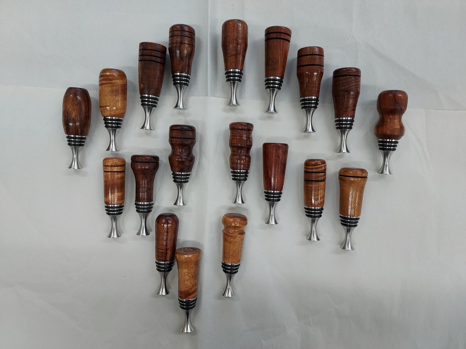

I've tried many finishes, some with pretty good success and some not so good. CA and I don't get along and the first time I tried it I got a bloody nose that lasted for a 1/2 hour. And I mean a bloody nose almost ER worthy. Needless to say, the piece was ruined and my clothes were stained after that. A big mess indeed. And my Doc told me I was probably allergic to CA and to knock it off...so I did. I won't say what my wife called me or any of that. I've also received CA finished pens from others and I've found them to be a bit "lumpy", if that's an adequate response to the pens. A few years back there was a turner from Canada (I think Canada) that has a system that he calls his "dipping method" using wipe on poly. If any other turner reading this knows his name please post it for Steve. I looked at it and realized I'd never used poly on my stuff so I thought, "what the heck, I'll give it a try". Took some practice but I think I've got it pretty well drilled down. I will also say that the "dipping method" the above mentioned turner uses turns out fantastic and is smooth, glossy and without any lumps. I have used two of his blanks that I'm sure were done using this method and I would put it up against any CA finish. So here's what I do on both turned items and my knives.
Day 1
Turn your item and sand down to a minimum of 400 grit, more is better. Make sure it's good and saw dust free and using a blue shop towel (that's what I use) apply a smooth but even amount of WOP on the piece. My lathe is turning at around 2000 rpm. Let dry 24 hours (all of my items get a 24 hour cure time even though it can be done again in around 4 hours in a heated shop).
Day 2
Sand the piece on the lathe using 1000 grit Abranet cloth. You can drop the rpm to around 800 for this turning. Kick the rpm back up to 2000 rpm, wipe off the piece to remove any dust and apply another coat of WOP. Let it dry for 24 hours
Day 3
Do the same as Day 2 but advance the Abranet cloth to 2000 grit. Same lathe speed as shown above.
Day 4 -if you need it
Do the same as Day 2 and 3 but use a 4000 grit Abranet cloth.
Some will say that applying WOP at 2000 rpm is too fast. I've not found that to be the case but instead all the little chunks on the turned item seem to "fly" off leaving a very smooth finish. You'll also "fling" some WOP on your floor or wall but it cleans up relatively easy. I've used this finish for the last 4 or 5 years and never had a complaint at all about my finish. I can't say that for the other finishes I've tried.
Knives I basically follow the same method, no lathe used for obvious reasons, except I use the Beall Buffing System at the end.
All of the stoppers below were finished using this method above.
Good luck on your research and I hope this helps whittle down your research.
Day 1
Day 2
Day 3
Day 1
Day 2
Day 3
