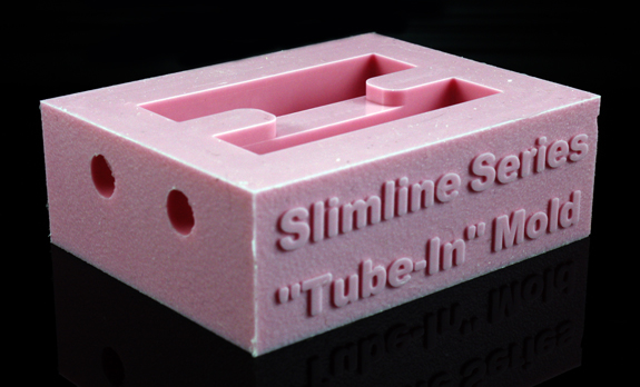

Was wondering if you can use one of these molds with alumilite in a pressure pot?
PTownSubbie.com - Sierra Series Silicone Molds
SierraSeries.html
Seems like it would either shrink or collapse under the pressure.
