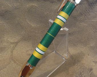

Some pens using thread wrapped blanks

Not to be negative but Ted is not the first to do this . I saw weaved patterns on a sierra pen about 5 or 6 years ago. Like I had mentioned before that is what got me interested in the idea. I dabbled a little but did not dedicate the time needed to learn tying to begin with. There are also many people that make pens using thread but no weaving patterns, They use them in place of doing a segmented blank. Here is an example.
Now the dedication to doing what Ted is showing us is extreme. Not at all easy to do on such a small tube. I marvel at his work. I will continue to enjoy every minute of it as long as he continues to show us mere mortals.

Use a nylon rod or PVC pipe rather than a wooden dowel for your backer rod. If it's long enough that it gets too floppy, you can run a steel rod inside it as a backbone to keep it straight. CA doesn't readily stick to nylon or PVC, and epoxy also has issues with nylon. In this way, you could line up several pen tubes (perhaps spaced a half inch apart on the rod) and wrap a multitude all at once. Apply your color seal and a few layers of rod building epoxy or whatever you wish to seal with ...
Cut the blanks apart and trim back to the brass tubes ... then send them off for casting or sell them as is to someone who wants to do the casting themselves ... or cast them and sell them like that. Don't cut the backing rod, just slide them all off the nylon rod at once!
This technique would work with any kit pen style that uses short tubes of ANY size, you just need the properly sized nylon rod to use as a backer.
This technique would also work best with any static pattern ... especially if the pattern's signature matches the gap between brass tubes perfectly.
