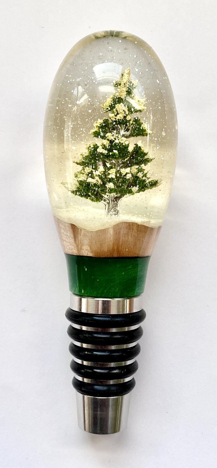

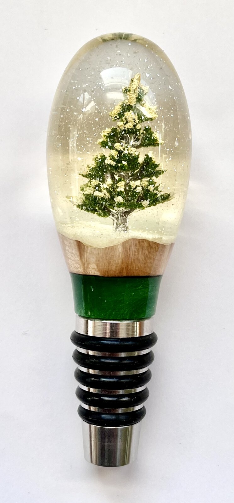

The first pic is a clear cast I made of a lone evergreen tree in snowfall, on a burl base. The wood I had wasn't thick enough so I opted to epoxy a piece of green mica cast resin to the base. I thought it would help accent the tree. Overall I like it but would have liked to make it more round and not as tall. I was at the mercy of the tree without making it too big.

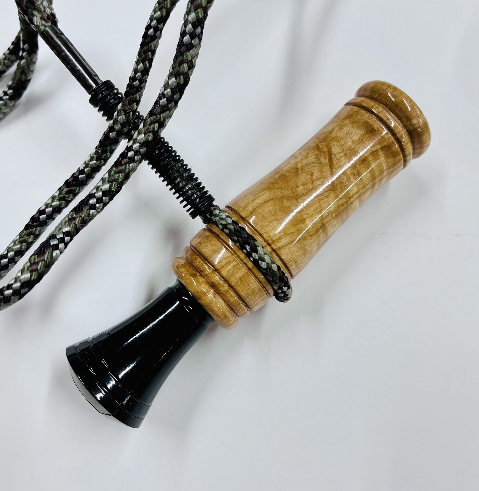

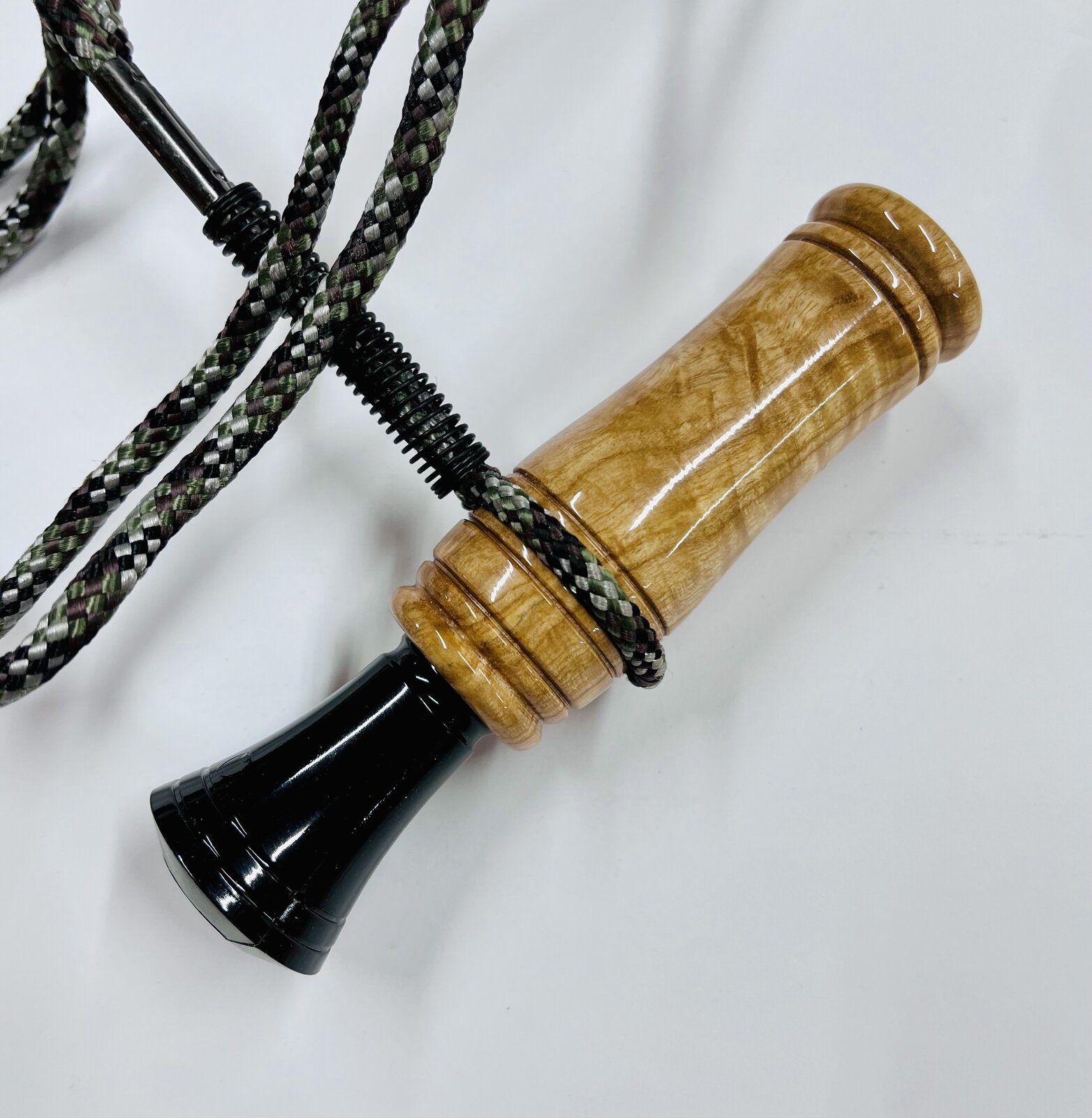

The second pic is a scrap piece of figured Ash. The fun thing about calls are your shape options are pretty limitless.
Thanks for looking. All comments welcome!

That bottle stopper is excellent. How did you cast that such that the glitter flakes didn't settle?

Thanks, I used Eye Candy mica named Snow. They are large flakes with little weight. I let the clear resin reach about 115° and mixed the flakes before pouring and it cured before the flakes settled.
