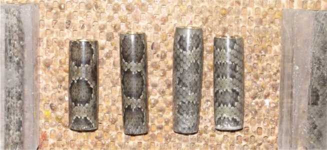

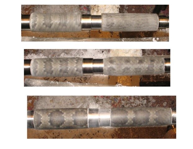

Here are some turnings I did last night in between chatting. Seems like everytime Don & I get together we talk snakes & casting, well here are some pics of the process.
One photo shows from the the casting block, rounded & finished, not bufffed.
The other is rounded, final cut, sand to 600
Thanks Anthony!
