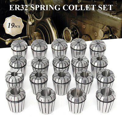

I noticed people here buy the Beall and buy a set of metric chucks separately. I tend to mostly work in metric for modeling, so that seems like a good solution. I saw that folks here years ago went with an eBay seller named 800watt, but I don't think he is around anymore. Anyone buy from this guy, or have any other recommendations? I'm a bit nervous buying a set from someone other than the chuck maker, but looks like I have no choice in this case:
I purchased a set of 19 ER32 metric collets from 2-20mm for about $60 from www.banggood.com. I've placed over 10 orders with them and no problems. Takes 2-4 weeks for delivery. The collet chuck and collets were surprisingly good quality. They also have carbide inserts and other wood turning tools.

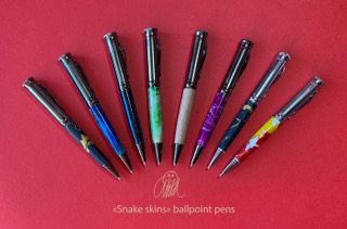

I have been making over 70 pens on my Sherline lathe. It is perfect for me as I can do it on an ordinary desk sitting down.
