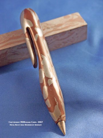

Yes, the nib can be made from M3. Look at this photo of a one piece pen where the nib and the clip are incorporated into the body of the pen.
