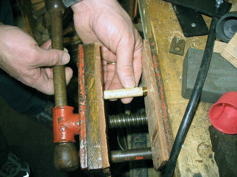

I use a woodworker's vise (old Columbian, $5 from the local flea market). It will handle better than 6" between the leather padded jaws. I use masonite pieces over the leather if I'm pressing something that needs a firmer surface.

Yes, a bench vice will work. But a nice pen press is faster, more accurate and handier. If you don't do many pens you will be OK the way you are. But more than just a 'now and then' pen, a good press becomes almost a requirement.
