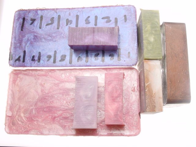

Okay, if any or you guys our members of Yahoo penturners, go to their files and find the one from Jay Pickens, that has all the info on how I made my resins.
Greg Scratch the tube molds! I used a poly casting mold that was 2x3x1 1/8 Got it from
www.misterart.com type in 4292869 in the search window and it will bring you to the little molds. After I poped them out of the mold, just cut them on the band saw.
Next go to www.artstuf.com what a great site, I spent two days looking and buying! The luster powder is what you want to buy, that is the real nice pearl stuff, all sorts of colors, I bought some concentrated poly resin dyes as well. I got my clear cast there too, a gallon for 25.00
Use a mixture of 7 drops catalyst for 1 OZ resin casting.
Read that article, and if you have questions, email me. Ware a gas mask! Anthony

Just found the pic of your pens. Very beautiful and as a woman I can say I love the pink and purple! The bronze is perfect for an executives pen. very distinguished! Where did you get the pink? I was hunting for a bright pink for a Christmas present for my niece. I never did find any.
Alice, I just started to cast my own resins. That was a combo of white pearl & red dye. I bought all the stuff from www.artstuf.com

Here is a picture of some of the molds from misterart I got, the link is below
www.misterart.com/store/view/001/group_id/540/ENVIRONMENTAL-TECH-Resin-Molds.htm
You can cut them length wise or across. On the 4 oz mold I can get 4 blanks. You can cast the thickness from 1/2 to 1"
There is a cross cut photo of the blanks, the color is real solid as I put in allot of luster powder with the dyes.
As stated above, all the casting material exept for the molds were from www.artstuf.com
