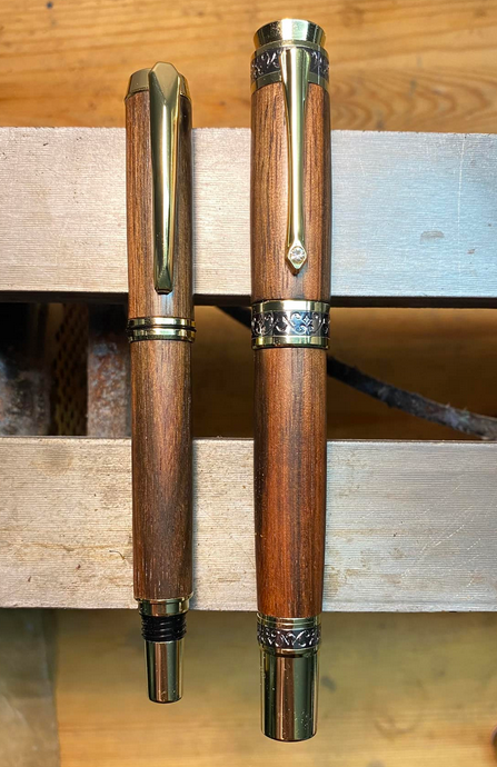

Last week, I tried this method since I had all the materials on hand. I would like to share the results for your preference.
The pen on the left is finished with the carnauba wax (stick) over the melamine lacquer.
The pen on the right is finished with the Renaissance wax over the melamine lacquer.
I am happy with the result that my macassar wood didn't lose its charm with that method.

They both look great, thank you for sharing!
