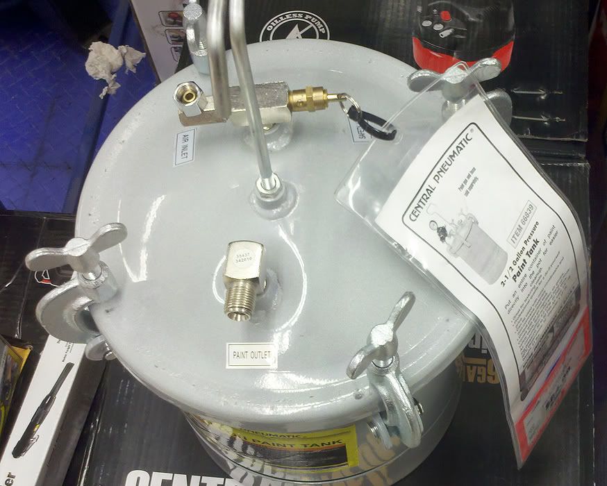

My new HF pressure pot just blew and almost killed me!
And let me verify my post.
I would say if properly used the HF pot would be safe at lower pressures for normal casting. I personally would look into something else if casting worthless wood type casting where the pressures would be higher.
Which pot are you referring to, Jeff? The Binks that I have are code stamped. The HF pot is not, of course. Neither is the CA Tech pot.
I presume these are not ASME code-stamped pots? If that's correct, and there is any concern about material integrity or workmanship, a hydro test to 1-1/2 times the design pressure might be a reasonable idea before putting it into service. That doesn't eliminate problems with the clamping process every time you use it, but it could expose bad welds, poor machining, or material problems.
Curtis, I started composing that reply before I saw your post. I was referring to the HF pots.

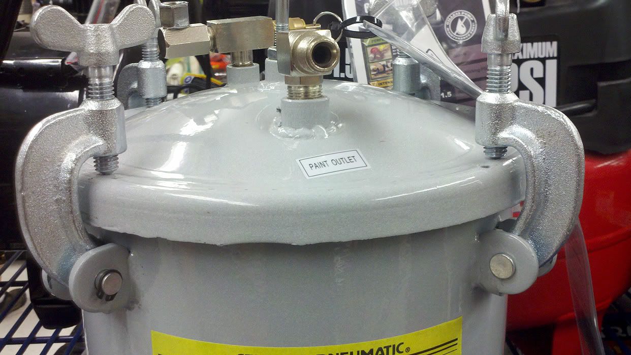

Aren't the clamp styles of the Binks and HF pots similar though?
Yes, as I said above, the HF is a cheap clone of the Binks pot. The clamps are not an issue, however. It is the cheap, flimsy steel the lid is made from on the HF that is the issue. When using an HF pot repeatedly, if you tighten the clamps in the same spot, you will create a dimple in the lid. With the Binks pot, this is not an issue no matter how much you tighten the clamps. The thin steel on the HF pot lid can also flex and distort but the Binks is so thick it will not.
Your mileage may vary but for me, if I am going to be creating a potential bomb in my shop every time I put air in one of these things, I sure as hell don't want to trust cheap Chinese steel and manufacturing! My life and limbs are worth more than the extra money I paid for a good setup. Once you have had one blow, even if it is possibly due to your modifications like my explosion was, you will never want to trust you life to cheap again!

Besides all of the obvious ramifications that come with an exploding HF paint pot, they sure are hard on underwear, too! Even if you escape harm from the explosion, your drawers may not be so lucky:) DAMHIKT!

Right you are, Curtis. I searched for the nearest Harbor Freight Tools store near me and actually got to see this pressure pot in person. Immediately upon inspection, the lid felt flimsy and cheap. I examined the lid more closely and totally the noticed the indentations/dimples on the lid from the clamps. The lid I saw seemed like it wasn't even cut evenly and was somewhat already warped. (Was able to take a few pics w/ my cell phone.)
Easy pass for me on this product. :ghost: Will be getting the Binks or C.A. Technologies pot instead.
TANSAAFL -There Aint No Such Thing As A Free Lunch -- I just checked my Binks pot that's at least 20 yrs old. Stamped 80 psi in big letters. I actually used it for painting at 60 psi + and have never had an issue. It also says "Made in USA" on it.

Here is a 2 year old link to Curtis when his pot blew. Notice he has a nice nifty cabinet that secures the pot. It didn't contain the lid but I am sure a loose pot would have been much more exciting. I think the biggest danger is when adding pressure you could always attach you air hose and control adding air from a safe distance with an in line shut off valve. One thing you don't want to do is to be looking straight down on your pot when filling. I stand to the side and that's when only filling to 25lb I start to sweat when I fill to 60lb (far & few between now-a-days)
Hmm so really what failed Curtis is the Hot Glue. I am sure it just stretched out allowing his savers to slip out.
Question - Do the Pots get hot or warm up during pressurization? If so I am sure that is what caused the Glue to fail and not the quality of the pot itself.
Ben; SCUBA dive shops have "shrouds" that surround a tank being pressurized. I was in the Caribbean and heard a tank fail in the back. LOUD BANG! The guy came out a few seconds later; he looked like he needed a drink!:laugh:
The only heat generated in the process is from the resin curing. I don't see how this could be enough to cause glue to fail.
My thinking is that the pressure caused by cranking down the screws broke one of the glue joints. From there, the 'pot saver' was able to move just a bit. This movement resulted in one screw that was not sufficiently secured, leading to a place that a leak could occur at high pressure. Once that happened, the pot was DONE.
