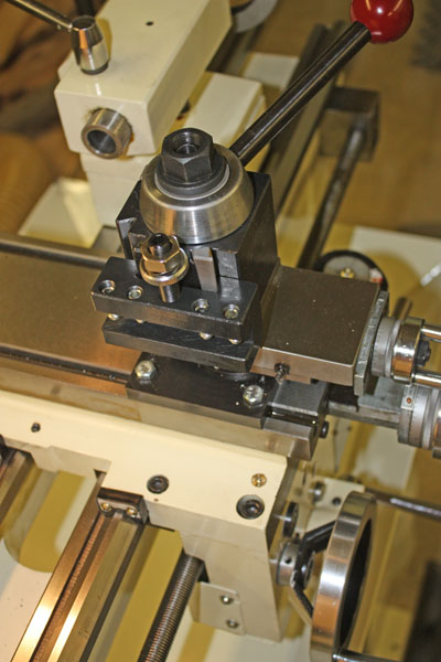

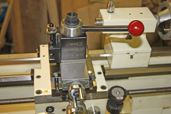

Well I finally got the QCTP mod complete and it is now mounted. It was kind of funny. I checked the thread size but did not check the sizes on the post, just went head first into the mod based on the instruction. Found out the hard way that my post is a little different than the one in the mod instructions. The threading on my original did not start right after the shoulder section but there was another smooth section above that which was .299 and .410 high. So I had to go back in with a N bit and drill it a little deeper. Once I did that it screwed down on the original post like a charm. And to keep Mike happy, here are the photos to prove it. :tongue:
And you already have the 4 bolt plate installed too, that's great! It looks terrific. Feels good, huh?
Mike
Mike: have you checked for centering of your tool? With a 1/2' high cutoff, it looks like I'm going to have to mill approx. .125 off bottom of the Phase II tool holder to allow it to go down far enough to center the cutting point. Also, have you checked yours for runout?
Mike
Feels great. Feels even better since I didn't screw up the tool post shaft and could have very easily done so. I kind of did the opposite of a guy thing. I actually read the directions and followed them, when I should have measure and compared what my lathe was and what the instructions said. I got real lucky there and it has taught me to measure what I am working on and compare it to the directions.
I did not check it to a cut off tool but I had checked it with a carbide cutter on a 3/8" base and found that I needed to raise the tool holder a fraction to get to the center line.
That being the case, then .125 or .150 should be just about perfect!! Thnx.!
Mike
