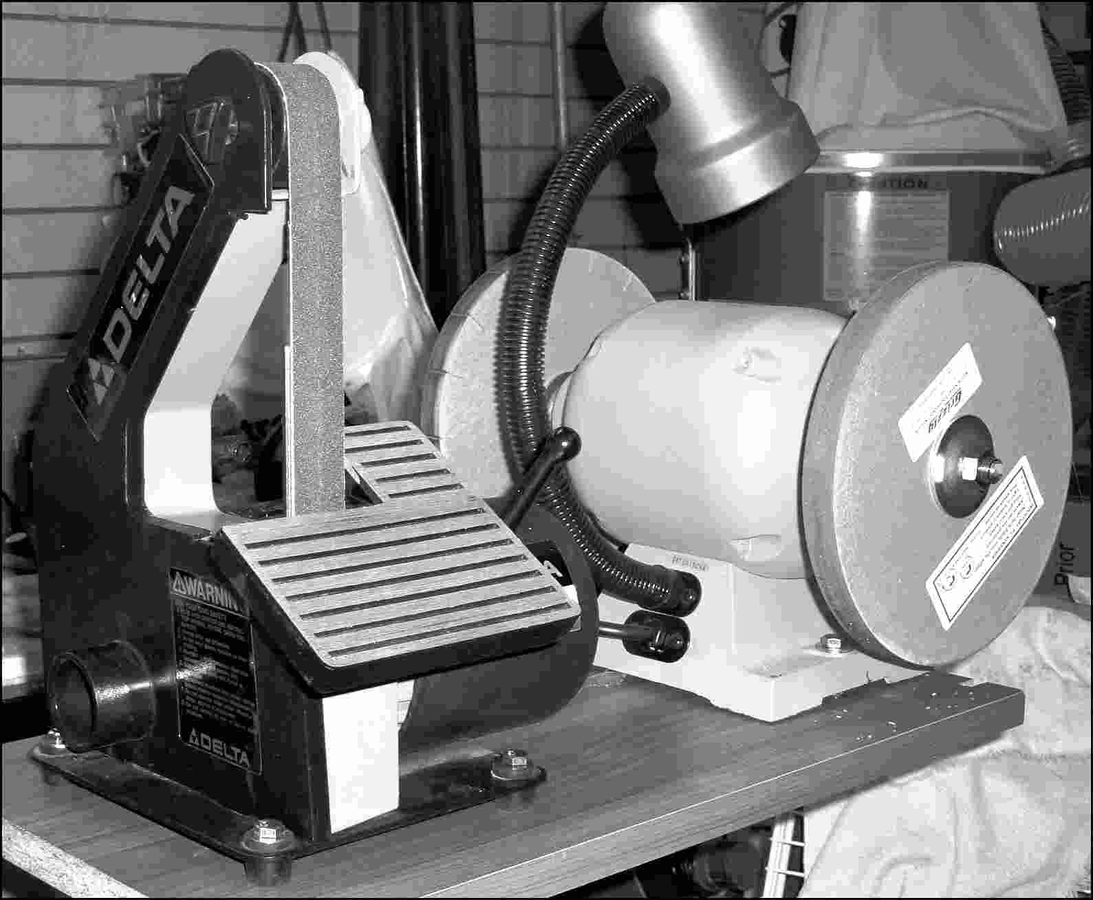

I use a modified 1" belt sander to get a flat edge followed up with a slotted MDF wheel with tripoli. I do this freehand, without problems, at the moment but may build a jig in the future.
