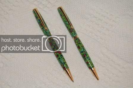

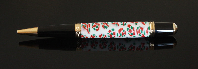

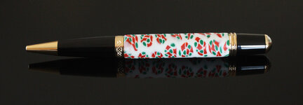

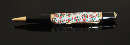

OK well I've done it, made my first Poly Pen. Quite happy with the results. It was made with generic Polymer Clay from the $2 shop what has a fairly matte finish. I wanted a Christmas theme, and also wanted to do as little finishing as possible out of the oven.
This pen was sanded on the ends to straighten out any PC hanging over, then Micromesh'd and polished with Brasso. No turning was involved. It's a little proud of the kit and slightly out of round at the nib end, and rounded down a little at the cap end. But considering that's from hand rolling, that's a pretty good result. When my wife first picked it up, her comment was "bit bumpy!" :redface:
This was actually my second tube. I mucked up the first one by running white through the never been used Pasta machine, and it came out with black streaks from the mechanism. Tried yellow instead to make a candy cane type blank, but didn't like the end result, so I didn't finish it.
So. The mind boggles at the possibilities. Technique needs some work, and I need some decent clay. It takes longer to do than resin (and wood, but everything is longer than wood) but there's no messy gluing involved at least. The ability to make exactly what you want as opposed to mixing and hoping with resin makes up for it I feel.
And if you do it economically (there is quite a bit of "wastage" of the clay initially) the actually clay needed for a Sierra blank weighed in at about 3 grams, which comes in at about 15 cents :biggrin: Of course the fact I used up all my white and a couple other sticks means the actual cost if you don't reuse the waste was more like 53 cents, but who's counting?
Thanks again for the inspiration guys, or I may never have tried.
Russell.

Nice job with the Christmas canes!

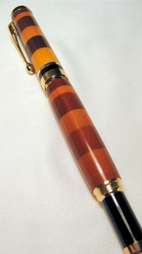

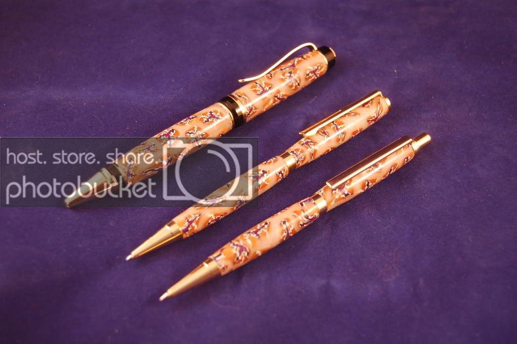

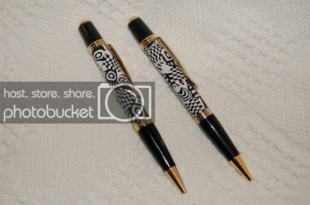

You can do wonderous things with the canes if you take your time and use a light touch on the lathe. Here are some other ones I've done with a similar approach to help emphasize what can be done. (Some of these have been posted here before, but this thread seem to be getting more viewers then past PC threads.)
Kaleidascope
Harlequin
Little flowers
Leaves
Who would have thunk it. A bunch of polymer addicts. As for the turning issue you have to take very shallow cuts. I use a procedure where I coat the tube with glue, wrap, and then cure. If it is undercured or gets to warm when you are turning you might as well forget it...Booom!
Both of these were turned just shy of the bushings. I then wet sand with dry wall screens to get the basic shape (they gum up less). Then I work my way done the sand paper chart and micro mesh.

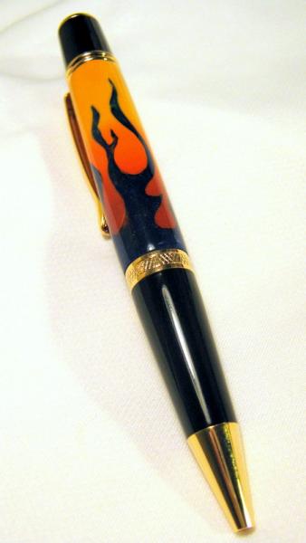

Wow, that flame job is great! How did you do that? If I had to guess, I'd say you did the background first, then cut out the flame design, then filled with black.
Is that about right?
To a degree yes. I made the background, cured the piece in the oven, then carved the design. Once the design is carved I backfilled with raw cobalt blue and cured the piece in the oven again. Once it was cooled I put it back on the lathe and turned it back to the original shape. Finished with CA.
With a Skinner blend background -- great job!

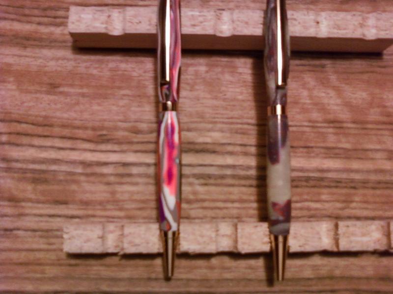

glowing pen
well i got 2 out 3 completed tonite,,,,, the 3rd one blew up :mad:..... the one on the write lol glows in the dark...sorry for the poor picture quality..

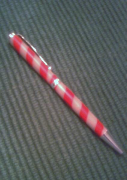

Okay, I'm in. Here is my first attempt at a PC pen. It is just a simple candy cane design just to familiarize myself with the process. There are a couple mistakes but I think it came out pretty well considering I was just winging it. Picture taken with my cell phone so it is not the best, not that I could do much better with my digital.

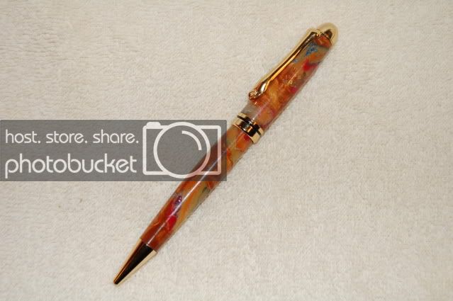

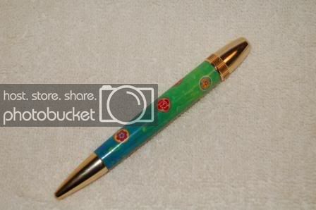

Thanks for the nice comments Sue. Here's some that haven't been shown here yet
These are mokume gane. I did layers of translucent clay, painted with different colors of ink and then topped with gold leaf to get this effect.
This one is also a mokume gane with gold and translucent clay mixed with various colors of glitter as I recall.
Mokume ganes are by far the best selling polymer pens I have done. I made a lot of the gold ones and they sold real fast. The gold leaf ones are also long gone, but I never made as many of these.

Nice job Smokey. Looks like you got a little pink from the red clay mixed into your white. That happens when you don't really clean off your hands, pasta machine and any other tools between working with the various colors. Red is notorious for mixing into where it doesn't belong. Soap and water for the hands and at least paper towel for the tools is generally adequate, although many swear by handwipes.
Thanks Paul, actually I think that what you are seeing is the red showing through the translucent. I did however get just the slightest amount of red in there too but not as much as appears in the photo. I did wash my hands twice before going from working the red to the translucent and still got a touch of pink. Might have to go the handwipe route next time I work with the red. Another thing I just thought of; work the light/other color first and the red last. That should help, I would think.
