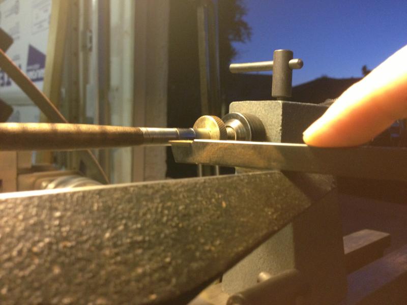

There is one other thing you should check before getting a new rest . Does the slide allow the vertical tool post ( not the offset edge of your rest) to be within about 1/4 inch of a turned slim barrel ? If not , your tool won`t be as well supported as it should be , and on occasion you may get some chatter , even though the carbide tool is quite rigid . I had to manufacture a short offset round bar rest for my lathe because of this .

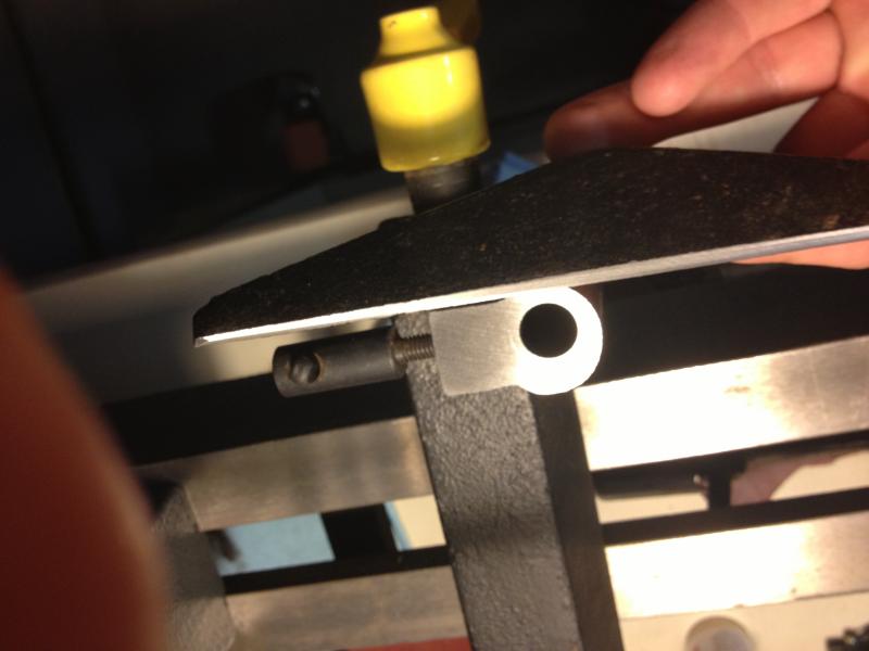

OK, well I think I managed to fix it to where it will work OK for me. I ground down the top of the banjo so the rest would sit lower, and also smoothed out the top of the rest where it was pretty rough and bumpy. Hopefully things will work much better now!

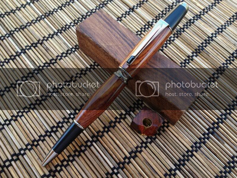

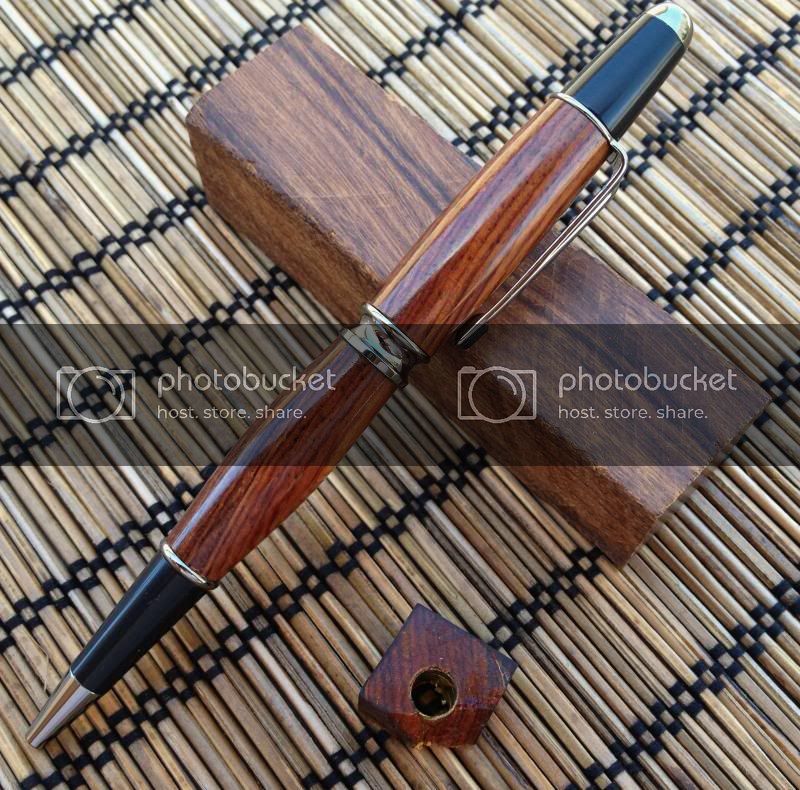

A quick update for everyone...I just finished turning my first piece since adjusting my tool rest height, and it worked magnificently (based upon how the tool felt during turning, that seems to have been a large part of the problem). Thanks again to all who helped out with tips and suggestions!
That is a beauty, one of the better looking patrizio's in my opinion. I am glad that you will be able to enjoy your lathe and the hobby now, without worrying about dodging pen blank shrapnel.
