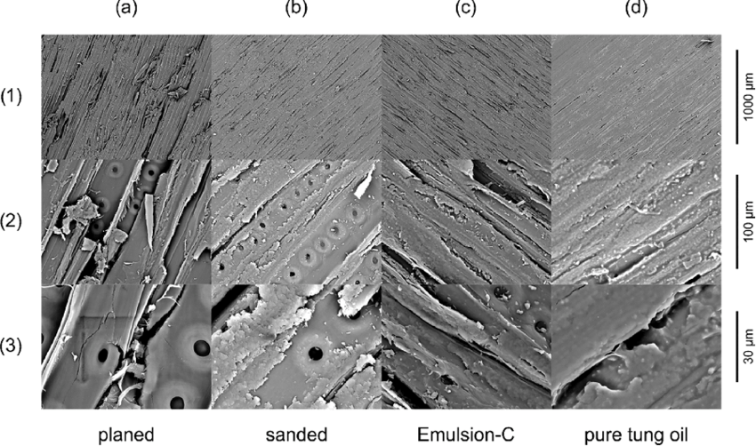

Just for some reference:
Scanning-electron-microscopy-images-of-uncoated-planed-wood-a-uncoated-sanded-wood.png
SEM image of some wood. I suspect sanding stopped around 320, 400, or 600, and didn't go anywhere near 3000 grit. Suffice it to say, at a microscopic level? There is no such thing as "smoother with this or that". Now with the medium fine grits sandpapers, you might not have as nice a looking edge to cells with sanding, which get broken and fragmented by EITHER planing or sanding, but my argument all along has been that you need to sand to a higher grit to achieve that silky smooth sanded feeling anyway.
My point is, there is a limit to how smooth things can get. At the 1 mm scale here (1000µm), the sanded result "looks" smoother to my eye. Similarly, the planed result clearly shows that the wood fibers still get shredded, you can see that plain as day (I guarantee you, if you look at your own wood at this scale, you'll see the same thing!!! Regardless of how sharp your tools are...) At the 30µm scale, you can see that the cellular structure still fragments and breaks with planing. The structures themselves are also clearly a limiting factor on how flat and smooth the surface of wood can get...big cells or small, they are the limiting factor.
Again...I'm not saying a super sharp plane or skew isn't excellent. That's never been my point. I know they are highly capable tools that will slice wood beautifully. They just won't do it perfectly. Perfection is an illusion that would be quickly shattered with some microscopy.

LOL, I have seen the same thing in Japan but the opposite of those picts. And I also saw videos with closeups of which form and angle of planes produced what kind of cut crunched and super smooth with capillary veins clearly visible. BTW, the sanded pics with the capillary holes, I have seen clearer ones done by block planes. Hoadley's book has some super photos of capillarys and grain.
