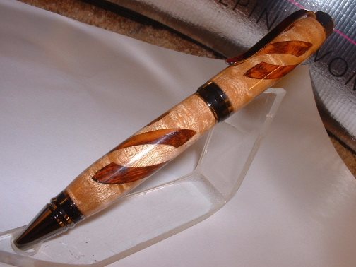

By looking at the picture, it is easy to count the sides that he had - 6 or 12 by the number of individual inlays at one end. The curve is an illusion of sorts or that can be seen in the mind's eye before the turning - by making strait cuts at an angle on a square or hex blank - then turning it round. Celtic knots on pens are nothing more than thin slices of flat straight wood segmented into the blank then turned round.
I suspect that Eagle made numerous parallel cuts at an angle from one edge of the hex, and then followed this by doing the same down each edge of the hex. After smoothing the six sides off, he then made parallel cuts again on each side of the hex - starting in the middle of each side instead of the edge.
That may not be clear but looking at his pattern, it is easy (for me) to see what is happening. It helps that I have been experimenting with a similar cut on 4 and 8 sides.
A KEY to me is that the blanks must be nearly perfectly square, hex or octogonal down the whole length of the blank. To me, it takes a good jig, good hold down and a good saw sled. But with these three, practice and patience, it becomes very doable!
As far as CURVES go, the picture that Nolan posted above - one without experience might view the inlays as curves. But with exprience, it will probably be veiwed as a straight piece placed in a cross cut angle slot in the wood and turned round.

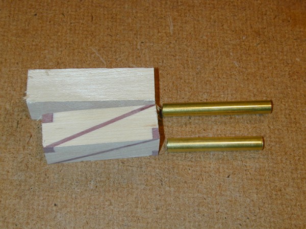

Some of you have the right idea on how to make this pen. What Eagle did was laminate three strips of wood together to the same thickness as a kerf from a table saw blade. Then he cut the laminates into strips and laid the strips into the kerfs. The greater the angle of the kerf, the more "wrap around" or curved the look. Also the depth of the cut has a lot to do with the curve.

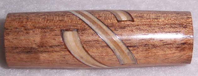

And now, without further ado…. My first inlay…….. Don’t laugh,[:p] this is not going on a pen, it’s just practice, the main thing is that it worked!

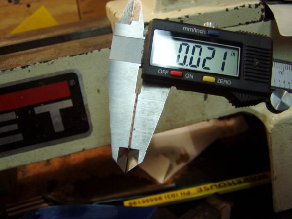

The Baltic plywood was a hair thinner than the kerf my saw left so I inserted some thin aluminum shim stock on either side of one of the pieces and it actually turned out well. Hmm, I wonder how brass or copper would look?

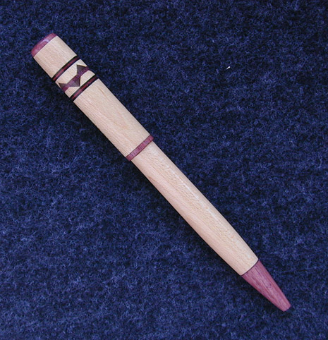

Ok, here is another pen to mull over,
Wooden nib
Wooden cap
Slightly thinner than a cigar
custom length tubes
The two bands above and below the triangles is purpleheart veneer sandwiched between two ebony veneers
