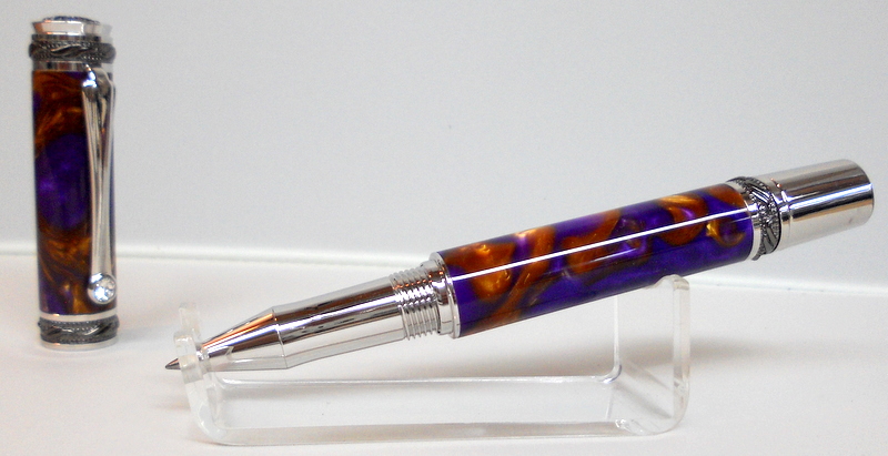

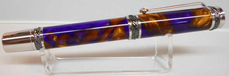

Not to sound like I doubt how good these are, but I really wanna see one of these blanks on a kit. I've been gawking at them too long NOT to.
Here are a couple of pictures of the gold-purple blank courtesy of LanceD.
attachment.php
attachment.php
