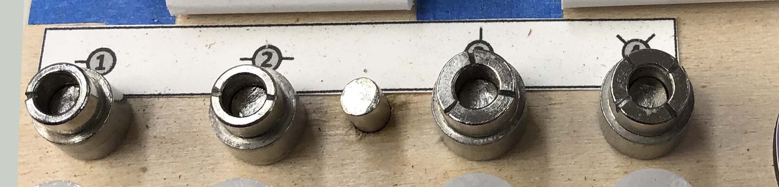

Someone suggested that I make the marks more symmetrical as to not throw them out of balance, so I have made a slight adjustment to how I mark them since that original post. (They are shown on 1/4-inch shelf pins that I use on to hold them on my turning / Press Caddy). - Dave
