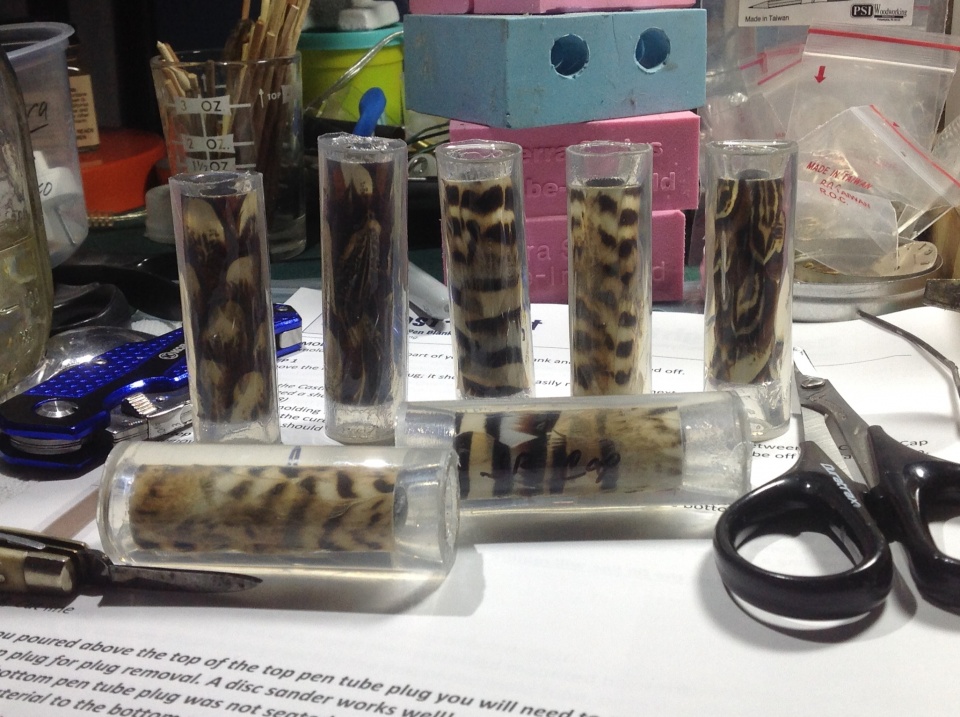

I took a look at making my own and decided to order the Cast-Right system. My order was quickly delivered, with two top and no bottom pieces of the casting rack. The error was quickly and completely corrected with one phone call, I now have two complete casting racks. Just finished casting several feather blanks; in the pressure pot for the night. I'll take a look tomorrow evening …
First attempt ... I have not trimmed to length and they took a bit longer to cure than usual, likely to the room temp. One casting was a bit off center, I didn't set the cap firmly enough. I'm sold on the system ...
