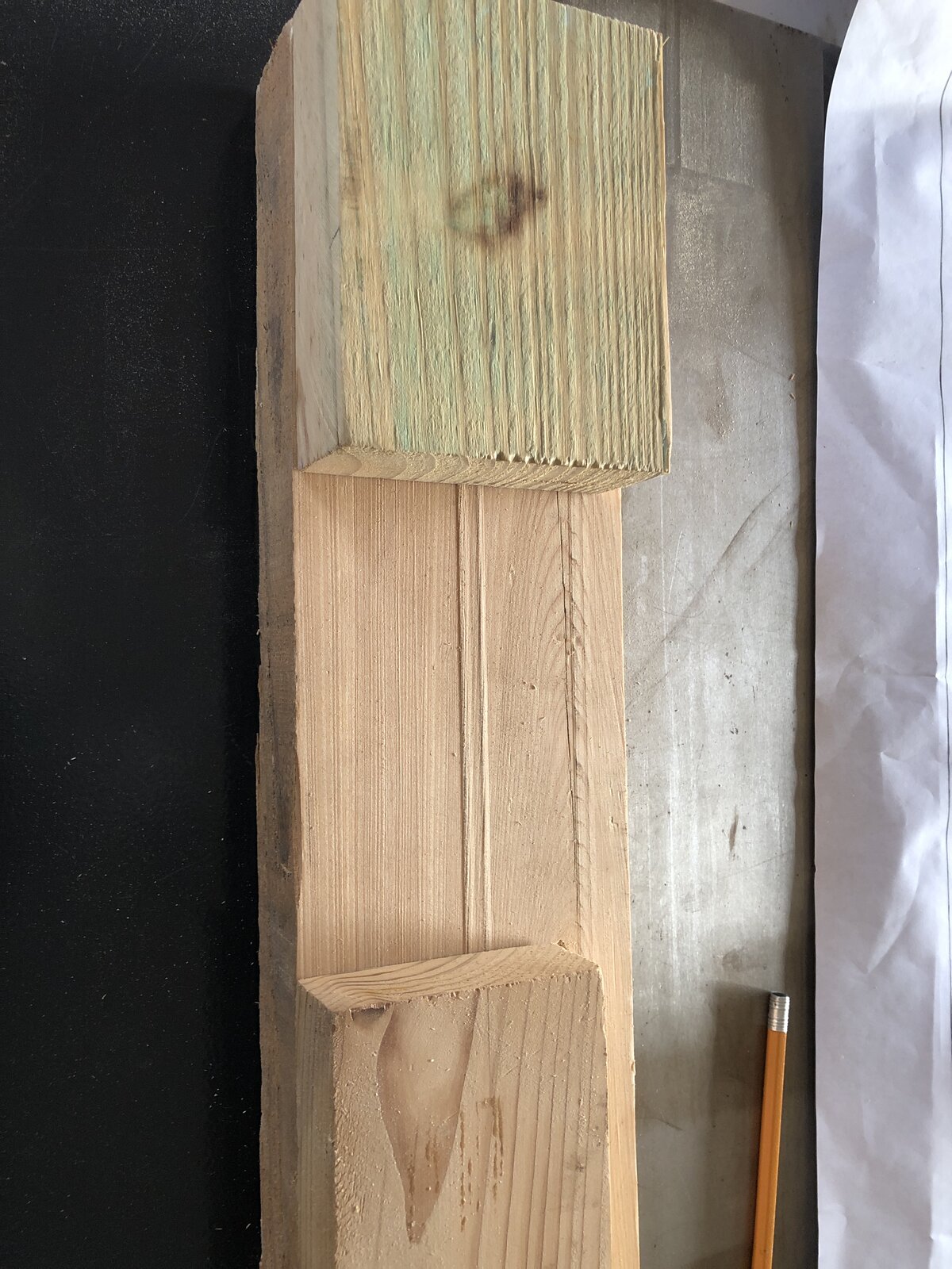

Rather than attaching it to plywood, consider using 2x4's to make a carriage wherein you can drill forstner bit holes and thus sink the bolt heads below the surface and put the nuts on top of the DP base.
This gives you a flat surface to set on the bench without having to figure out what to do with things protruding through plywood.
This is just scrap wood showing the idea very roughly. The gap between 2x4's is for clamps.
This gives you a flat surface to set on the bench without having to figure out what to do with things protruding through plywood.View attachment 370355
he can use 3/4" piece of plywood and some carriage bolts and sink them very easily. Nuts and washers on top and your are done Or nail 2 pieces together and do the same if you are worried about bolt heads.
