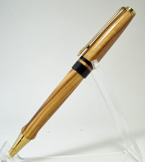

Here it is - my second entry, which I like much better. And I think its sold!! my first sale! I just need to figure out a price.
The blank came as part of an unlabeled assertment - I think its Zebrawood - someone please tell be otherwize if this isnt so. The accent wood is walnut. I was expecting a bit more contrast between the woods - oh well, the buyer likes it.
My first guess is desert Iron wood. I guess it could be zebrawood, but the zebra that I get is usually much lighter than this.

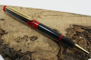

I just completed the stage 2 challenge. It's made of Madreperlato - Silver Grey and Blood Red blanks from Exotic Blanks.
I learned quite a bit about tenons doing this one. This is the 2nd pen I tried for this stage. The first on will still be a nice pen once it is done, but the center band will be segmented on the tube. I was determined to get the center band on a tenon. Once I figured out what I was doing wrong it was rather easy. I do need to read more about jam chucks. I ended up just using my Collet chuck to make the finial. The finial gave me some problem also. I would get a good tight press fit, but couldn't get the clip ring on the tenon. Once I got it to where I could slide the clip on I needed to glue it in the pen. You are looking at finial #3. I am also not thrilled with the glue joints of the center band and the lower red ring. They looked good and tight when I glued them up, but as i turned them there is a glue line showing.
No saws were used to construct the pen.
Constructive criticism is requested!!

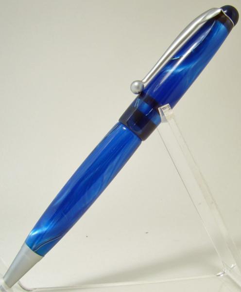

My Challenge Two pen is acrylic and unfortunately I didn't have a lot to choose from, so I went with the blue and a darker blue CB and finial. I did both of them totally on the lathe and really enjoyed learning how to do it. I had a piece of HSS about .055 thick from a tool kit I bought for my metal lathe that worked great for cutting the slices off. I cut the tenon and glued the rings to it. Just about had the finial finished and decided I needed to take a little more off the diameter to fit into the tube, and it ended up a little too small, so I had to glue it.
I should have painted the tubes as you can see the tube on the trim I put just below the finial. Other than that I am happy with it.

Great job on both Steve . I really like the stage 2 pen , the acrylic and the satin kit go great together .

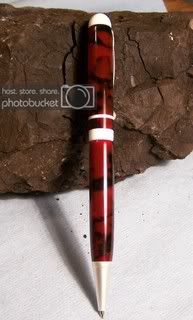

Here is my entry. It's a home-brew blank I made a while back before I had the means to use vacuum/pressure, so it has a few bubbles in the resin. The cap and center band rings are white corian. Constructive criticism welcome, of course.

That looks great to me . Nice blank and you did a good job with it .
Welcome to the group Chuck , glad you came out of the shadows and posted your pen . Don't be a stranger now , come join in the fun , we don't bite ....... well Cav does sometimes but we keep him locked up and well fed :devil::biggrin:
Sheese , I just noticed your from Texas , do all Texans make pens ??? :biggrin::biggrin:
Hey Chuck, very nice work on both the blank and the pen. White Corian reminds me that I have a ton of that somewhere, I'll have to dig it out.
