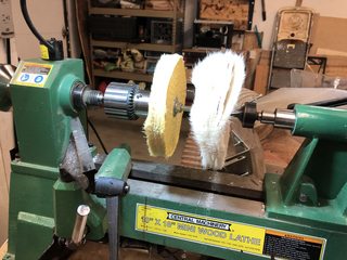

Am I missing something? Can't I use my cheapie HF wheels on a threaded shaft in a Jacobs chuck with 2 or 3 wheels on it?? Seems like EEE (or whatever the equivalent color rouge is) on one, plastic polish (or rouge) on one and clean on the third accomplishes the same thing?? I turn 99% of my pens with GluBoost or a brand of CA.

Actually, the more I think about it I bet I wouldn't be able to tell the difference using a buffing system or my same old EEE and plastic polish on the mandrel with a paper towel. Using GluBoost I've stopped using micro mesh and after a few seconds with some .0000 steel wool I go straight to EEE then plastic polish. I'll see.

I have both, but the Beal wheels are much more robust and higher quality than the HF wheels. The HF wheels are much thinner than the Beal. You get what you pay for.

Thanks. I assumed that was the case. I'm just wondering about the end results. There's got to be a source for better than HF quality wheels if that is the only difference vs spending $100 or why not just buy the Beale wheels? Not that the $ is the issue. I'm just skeptical about any difference in the end results.

Anything that spins the buffs at the appropriate rpm will work. I used to use a PSI buffing mandrel (a cheap knock-off of the Beall), but later switched to 3 Harbor Freight bench buffers so I wouldn't have to change buffs between compounds. I buy my buffs and buffing compounds from Caswell Plating.

Each Bealle buffing wheel is a different blend of fabrics to work best with the specific compound or wax. That is why they come marked as to which buff is for which compound.
i bought just the buffs from CSUSA since I already had the compounds from when I used the HF wheels. I also made my own spindle extension for the buffs to go on. I prefer to just mount one buff at a time so I don't cross contaminate compounds between the buffing wheels.

I can't really do a fair comparison because I didn't like using the HF buffs and therefore only buffed a few items. The HF buffs are to narrow and I was primarily trying to buff larger items.

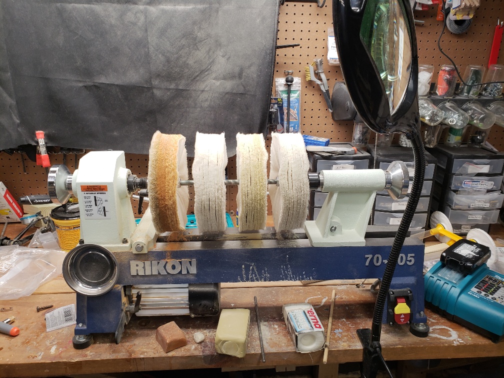

I used caswell compounds the n switched to these: https://www.menzerna.com/products/solid-compounds/
I built my own because I wanted better buffs and all one axis. I don't like changing things. I also wanted two compounds finer than white diamond.
