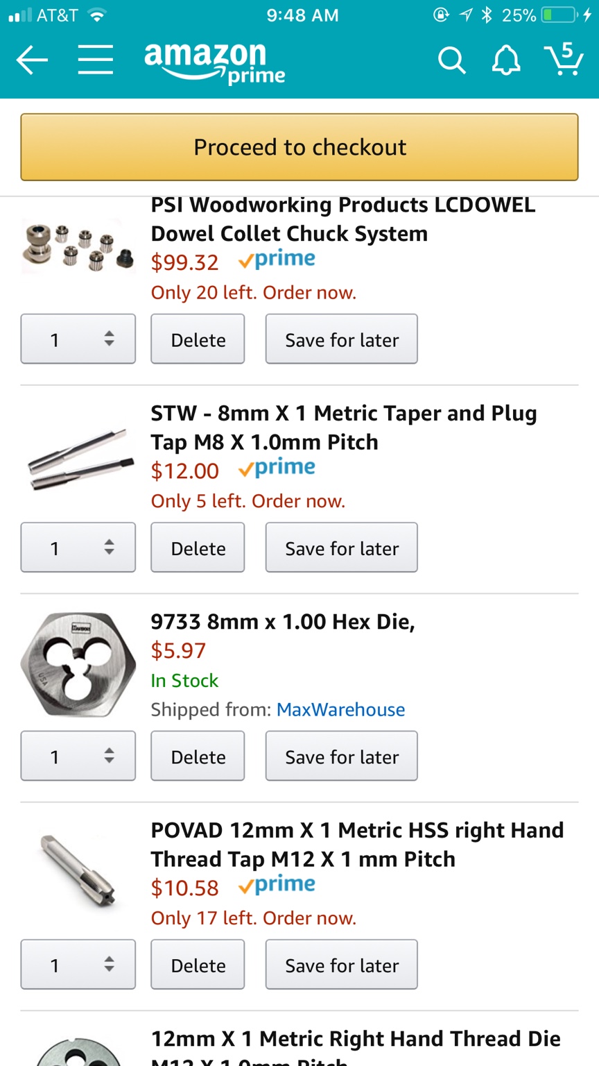

Ordered the book. Also I searched some of the tools you guys suggested . If someone could tell me if these would work to start practicing (before I hit the purchase button)

Others have chimed in that they have hit their knuckles on the knurling on the psi collet holder, and that is why I recommend the much more expensive Beall. The smooth outer nut doesn't hurt if you get too close.
Also the hex 8mm die should be a round die. Hex dies are traditionally used for cleaning up existing threads, round are for forming from a raw tennon.
I would hold off on your order until you buy the book, and read up more on the process.
You will still need a die holder, and I highly recommend the tap guide.
Also, are you making a #5 or #6, looks like you are going for a #6 nib, if that is the case one of the others needs to confirm if the 8mm will work for the section. I do not know.

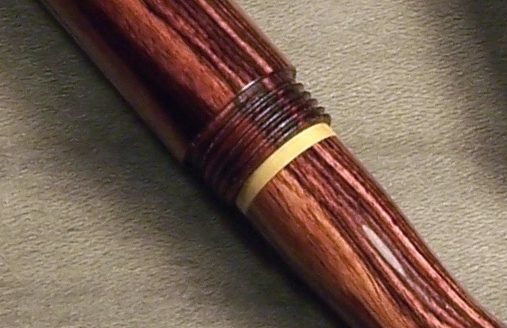

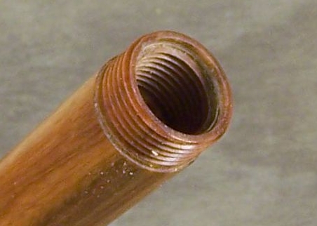

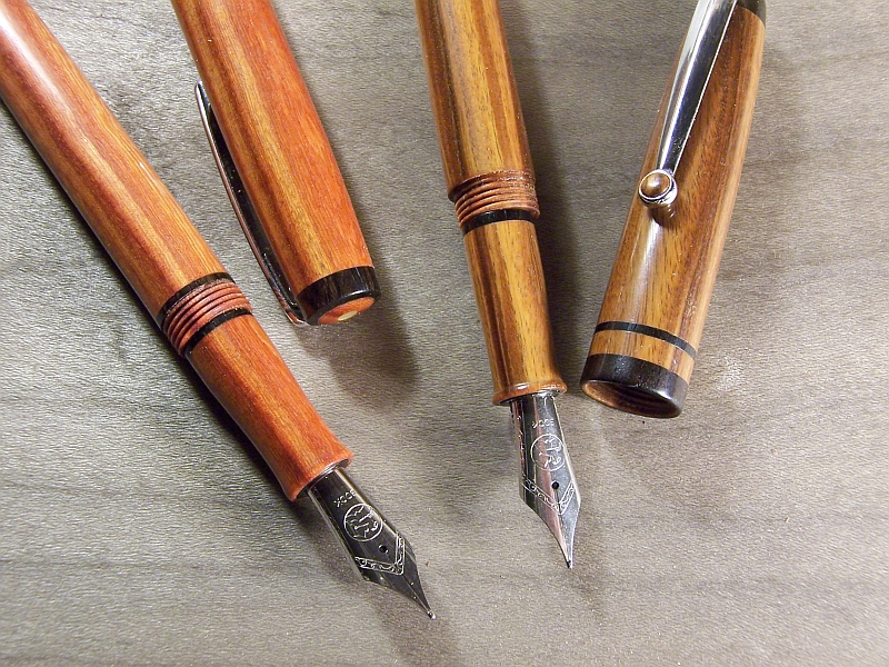

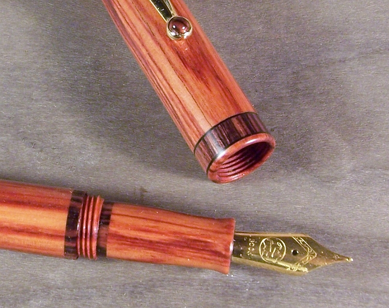

Pierre---
Jun 10, 2012
415
France
I love wooden threads. They can be just perfect. Well, I admit, sometimes they are not.:frown: You need a good wood (hard, little or no grain, here pau rosa, lignum vitae, tulipwood, kingwood and lignum again), and to forget where your box of dies is. I use a cutter turning at high speed.

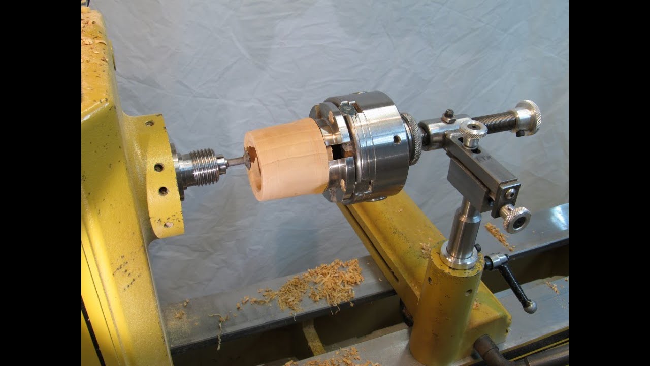

Pierre, s'il vous plait ... can you show us a photo of your equipment configured for cutting threads? It sounds like you have a thread-cutting jig of some kind, if so could you share which make and where you bought it?
I usually use a 9mm x 0.75 for the front section of a #5 nib. The smallest I've been able to use is an 8.5mm x 0.6 and only in metal. I'm surprised an 8mm would work. With a 0.75 pitch your left with less than 0.5mm (0.020") wall between threads.
Try some mock ups with scrap pieces drilling at thread diameters and turning to the diameters at the bottom of the external threads. Then you can test for wall thicknesses and strength before you buy your taps and dies.
My rule of thumb has been 2mm differences minimum between section and cap threads assuming 0.75 pitch. It works for metals and acrylics.

Yes wood is moving, so you do have to choose your blank having that in mind. I agree with Patrick, before threading wood, giving a try on acrylic with regular taps is not a bad idea.
My jig is made of scrap, so it's a little scrappy and I'm afraid a pic would not be really clear. Here is one found on the Net, the same idea.
Mine has lead screws of different pitches. The limit of this machine is the threaded bars I can find. On the other hand, unlike taps and dies, I can thread any diameter I want. The main difference with the photo is that I use a XY vice for convenience: reproduction is easier, and above all I can make double, triple, quintuple threads or whatever I like.

My jig is made of scrap, so it's a little scrappy and I'm afraid a pic would not be really clear. Here is one found on the Net, the same idea. ..........
That's like the jig I was thinking of, it looks like an earlier version of THIS ONE.
But your home-made one sounds much more useful for pen making -- multi-start threading is a great advantage :)
