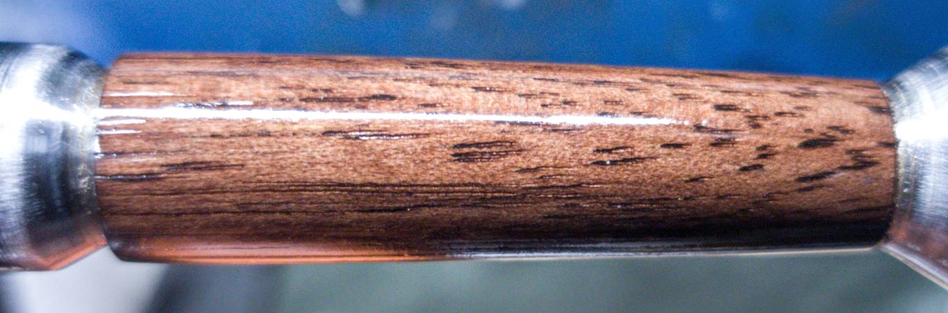

Well, gave it a first go.
Made some mistakes, so we'll see how it turns out here. First, initial choice of applicator was bad. Left paper towel fibers in the finish. So I had to sand off the first three coats. Then, I had to figure out what the right balance of oil to CA was. I'm still not sure I've found it. Finally...I suspect my walnut oil is bad, and it is probably affecting how it interacts with the CA. This is probably also why my pens plus isn't working... I think the walnut oil has gone rancid, and maybe the shellac in the PP too. Darn heat...I should have brought all the finishes in over the last month.
After sanding off the first few coats, I applied about 10 more. First impression is, the finish looks extremely brilliant. The chatoyance is off the chart. PP does well, when you can get it to clear up, with chatoyance, but I don't thin I've ever seen anything like GB/WO gives. So, that's a plus.
On the negative side...it doesn't seem to be drying. Even with applicator, it doesn't dry. I ended up adding a few additional coats after the first 10, as when I touched it (After applying GC accelerator) I left a notable mark. A few more coats cleared it up again. The ends are showing "dull", which is exactly the kind of problem I was getting with the Pens Plus. I'm 99% sure that's the bad WO...
I guess I'll see here, if it dries and hardens overnight or not.
The commend you make about drying oils. BLO has additives that make it dry faster. Much like a Danish oil, which also has drying additives. Both BLO and Danish will usually have heavy metal drying agents, among many other VOC and other drying agents. So, maybe that is a factor, and it may well be that tomorrow, the GB/WO is still wet. This set of pens was a bad batch, and already had problems, so losing them isn't a big deal. They were already lost! ;) I have 9 more turned blanks to play with, so I should be able to figure out what will work here. I haven't used BLO in a couple of years, so, the stuff I have is undoubtedly bad and will need to be replaced.

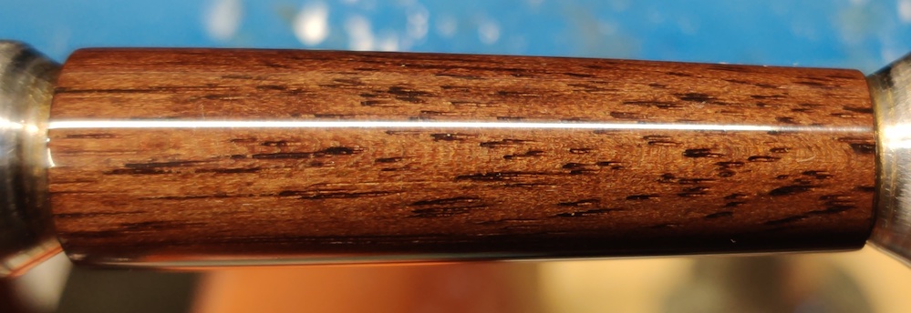

Super shiny... One thing I have noticed...it does not really seem to be building up all that much? I heard 10 coats with GB was quite a lot, and that it doesn't need that many. Some people only use a few coats. The depressions of the wood grain are still showing through here, though...and this is 10 coats (and eventually...12 or 13, which still pretty much looks the same.)
Wonder if that is part of blending oil and CA? It is very similar to how Pens Plus works...its not a build up finish. Thing is, I was expecting build up, so, over-turned the blank when removing the prior finish, to allow room for buildup... šŸ˜…

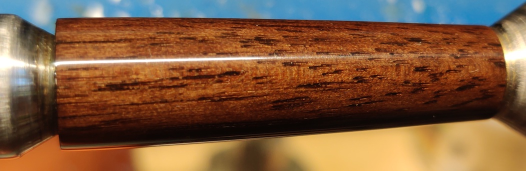

Well, fiddled with this again today. Was NOT dry. The oil, even with friction polishing and heat when applying, doesn't polymerize with the CA glue. I try-buffed it off with a dry piece of paper towel, which left the top part of the pen glossy and shiny, and the bottom part dull and streaky. So seems, that the bottom half did not cure properly.
I sanded it back a bit, then added a few coats of just the normal (not thin) GB. Pure GB, no oil. Was fine on the top half, seemed to blend in with the bottom half (the fatter part, btw). So I quickly applied some accelerator, then applied a couple more coats, which seemed to produce a nice, hard CA finish.
Sanded that down, polished it up decently with Zona to the 1 micron grit. It still has a slight satin sheen to it, but it is now super clear. I don't think it has built up enough to actually fit the pen kit fittings (Cigar), so I would normally probably have to add more coats until it was thick enough. But, it did polish up with those pure CA finish coats. Since the pure oil (not a drying oil) doesn't bond properly with the glue, I would definitely NOT recommend this, even though I was able to salvage it.
All of these blanks had oil-based finish on them before (5 kits, 10 blanks top and bottom). So, I'm going to pick up some BLO and maybe some Danish oil, and see how those two work with the CA. Hoping that the accelerants in them will hasten the crosslinking process between glue and oil. I will say this...the oil+CA finish has a different feel to it. It feels almost more like rubber, and that in a way, makes it feel better? Classier, higher end? Maybe that is just the GluBoost, though...this is my first try with it, and I haven't used it pure yet, so I guess I'll see if this slightly rubbery, rich feel is normal for GB.
I will say, the clarity is amazing. I've used StickFast, Mercury, Mercury Flex, TiteBond, and...I forget the other. None have ever produced the clarity of GB, and that's been my big turnoff with CA so far...it always looked like plastic. The GB+WO shine line still has a very faint satin-like glow around it, but, away from the shine line its truly crystal clear, which is more like what I get from Pens Plus (but, better!) That's the kind of shine I like, so, this may work for my needs. I'm curious to see if this crystal clarity persists with the pure GB...

Polished it up with some Meguiar's, and the satin is gone. Did reveal I didn't quite get rid of all the scratches from one of the sandpaper grits, not sure which. I may try work on building up the finish a bit more to the size of the fittings for some practice here. The scratches are definitely what gives CA that plastic look though. I am now curious to see how GB+BLO or GB+Danish as well as pure GB hold up in the long run. There is a certain feel to this finish, that makes me think it is not as hard, but maybe more durable, than a pure CA finish. I guess I'll find out more once I have some BLO.
