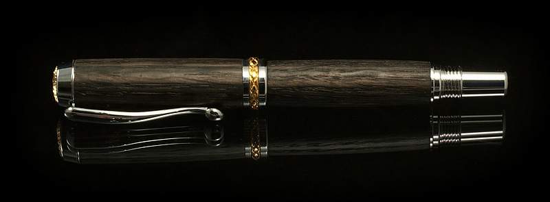

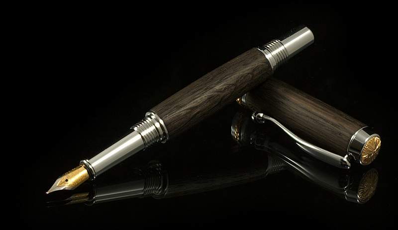

Triton in darker dense wood, 2000-2500yrs old. I've brushed it a little bit with SIA cushoned sanding pads working along grain 800-1000-1500 (they are much softer then MicroMesh, and are really good for brushing), then a coat of oil/lacquer mix from artist shop.

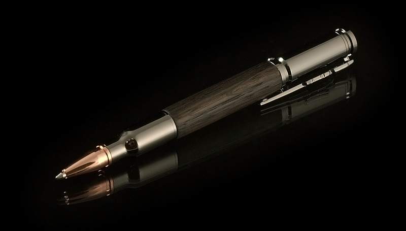

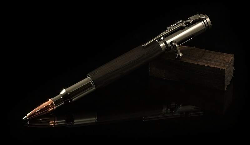

Bolt action in same wood same technique, different light setup - looks almost ebony black with few streaks of dark brown.

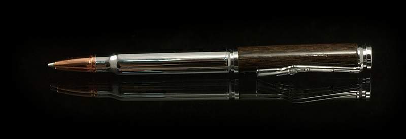

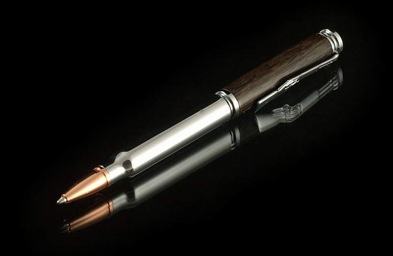

Here is different wood - probably not so old, around 1500-2000yrs, a bit softer with greenish tint. This time I've put CA/BLO, just to have something different (same customer as bolt action) and to try it under CA. This oak is a bit lighter, so I expected that CA will darken it a bit but not to full black (as could happen with previous wood). No problem with finishing, just my usual routine.
I may be a bit wrong on dates now, as I was choosing wood not by date but by color, figure and density, trying to avoid jet black (there where a few pieces), as customer have asked to clearly see wood structure and it was my first bog oak. As I see, if you brush oak, it could easily be jet black and you will see a structure.

The wood is beautiful. I am really impressed with the grain. Personally I like the oil/lacquer finish as opposed to CA, but others may differ. I think the shine of the CA conflicts with the beauty of the wood, in this case. If I might ask, is this wood expensive? If so, putting these blanks on a Triton might be a better choice than the bolt action pens, as you will probably be able to get a better price for the Triton. Thanks for showing these pens....never seen Ukranian Bog Oak before.

As it is local, it is not too expensive. Bolt Actions are good because they take only half of Triton length and half of work/time, and I'm making this for customer who wants to sell them in a bunch of other BA pens in expensive materials (burls, trustone). And he is willing to pay for BA:)
Triton pen made actually for supplier of bog oak, when he saw my pens he was amused (never saw turned pens before) so I have got few big chunks of oak free in exchange for pen from it.
I like brushed and oiled look better too, and it really feels great to touch. I'm not expecting any problems with that wood like patina:)
