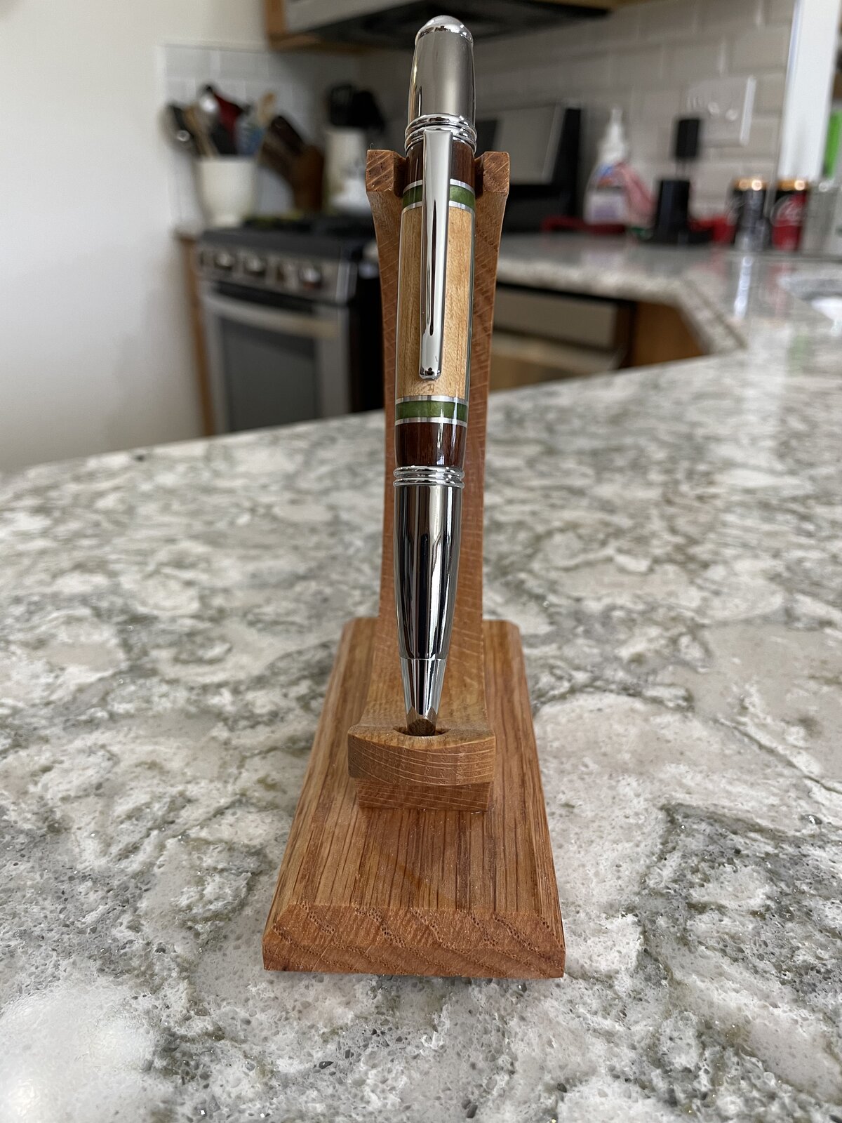

Tried something different before drilling
See more from KenB259
KenB259
Dec 24, 2017
3,607
Michigan

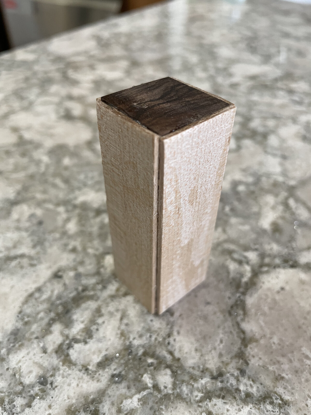

Since this pen contains a lot of aluminum and knowing the drill bit would be in contact with it the entire time, I decided to encase it in hard maple. Drilled it slowly to minimize any heat and it worked perfectly. Would it have been okay without the maple? Maybe but I liked the little extra bit of insurance. Woods are a very very plain piece of goncola alves, rosewood end caps and some green swirly acrylic and of course a little .032 aluminum. Pen is a gunmetal and chrome Gatsby.

The finished pen is beautiful Ken. Great combination of materials, and your drilling modification was well served.

Just one question ... did you drill the blank on the lathe ?
KenB259
Dec 24, 2017
3,607
Michigan
Very nice work, Ken !!!
The component pieces of the blank complement each other very well !!!
And your method of support during drilling is good to keep in mind.
Thanks for showing.
I do all my drilling on the lathe. That's also why I added the maple to all 4 sides , I wanted to keep the blank square.
