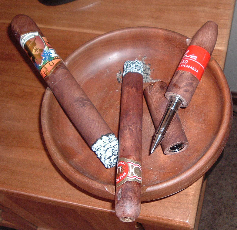

Made these recently. They are still fun to make.
I do have a question for all you penmakers.
As far as rollerball refills go, for long term storage, should I take them out and lay them flat?
Currently the pens are displayed with the ink roller pointed down.
Dale

Looks almost like a capless jr gent. How do you get the ashes so bright? I try and try using buckeye and dont put a finish on it but it never looks like stacked ashes like yours do. Just awesome work man! Do you take shavings and layer them and build them up?

Thank you all for the kind comments.
Terry, I had been using the CSUSA Artisan jr Gent. However, since they changed it yet again the plastic to metal thread combination is terrible.
So, I decided to switch to their Apprentice version. It has painted metal to metal threads and is a 2-start thread. It is less expensive and the plating is probably not as good but it threads together much more easily.
Joe, I use buckeye burl for the ashes so I can carve it. A black acrylic paint is used for the base and I now use a white correction pen to apply the white accent.

Oh I gotcha. I tried using a live edge piece of walnut to try to get the burnt paper look on the walnut. I never even thought of paint. Man I would love to watch you make 1 or 2. If you ever do anything up by Fargo, ND I will DEFINITELY be there!
