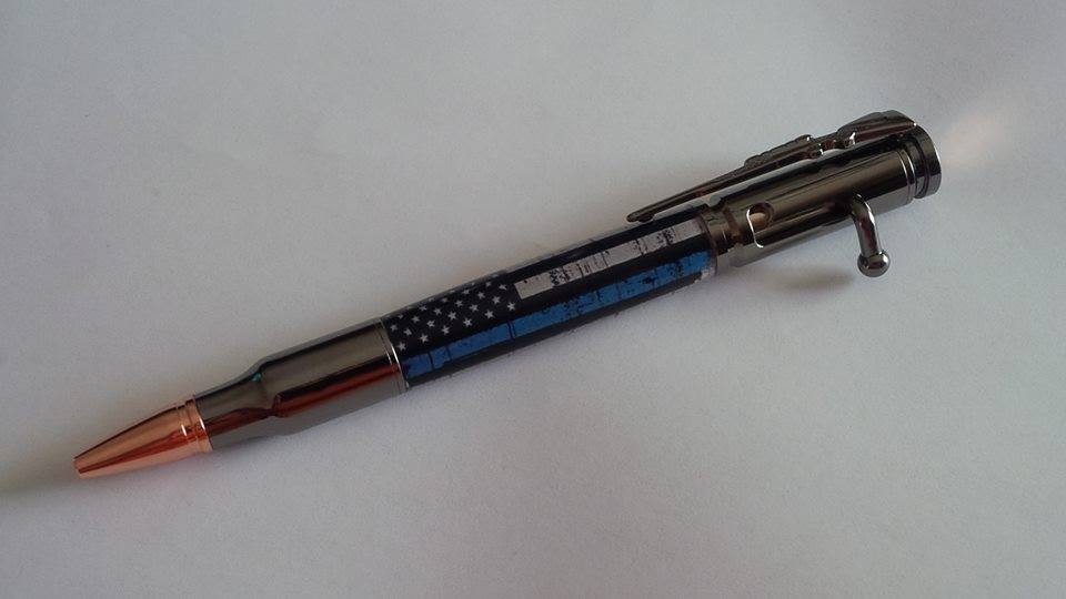

I have made bunches of "thin blue line" segmented pens....Ed from Exotic blanks sell the best solid black blanks and PSI has four packs of solid blue that is about the right color that are dirt cheap. I like Ed's black as it is not real opaque and it is square, there are round solid black out there which is impossible to cut. Its an easy cut and glue up....Make sure to reverse paint the blank and tube....I usually only paint white, but it looks terrible on this, use black.
The difference in color is subtle, so I tried using a thin "white" insert on each side of the blue to set off the blue, and it looked good, but it did not fit the theme. Sorry I don't have any photos at hand....

I cast these, let me know if your interested.
