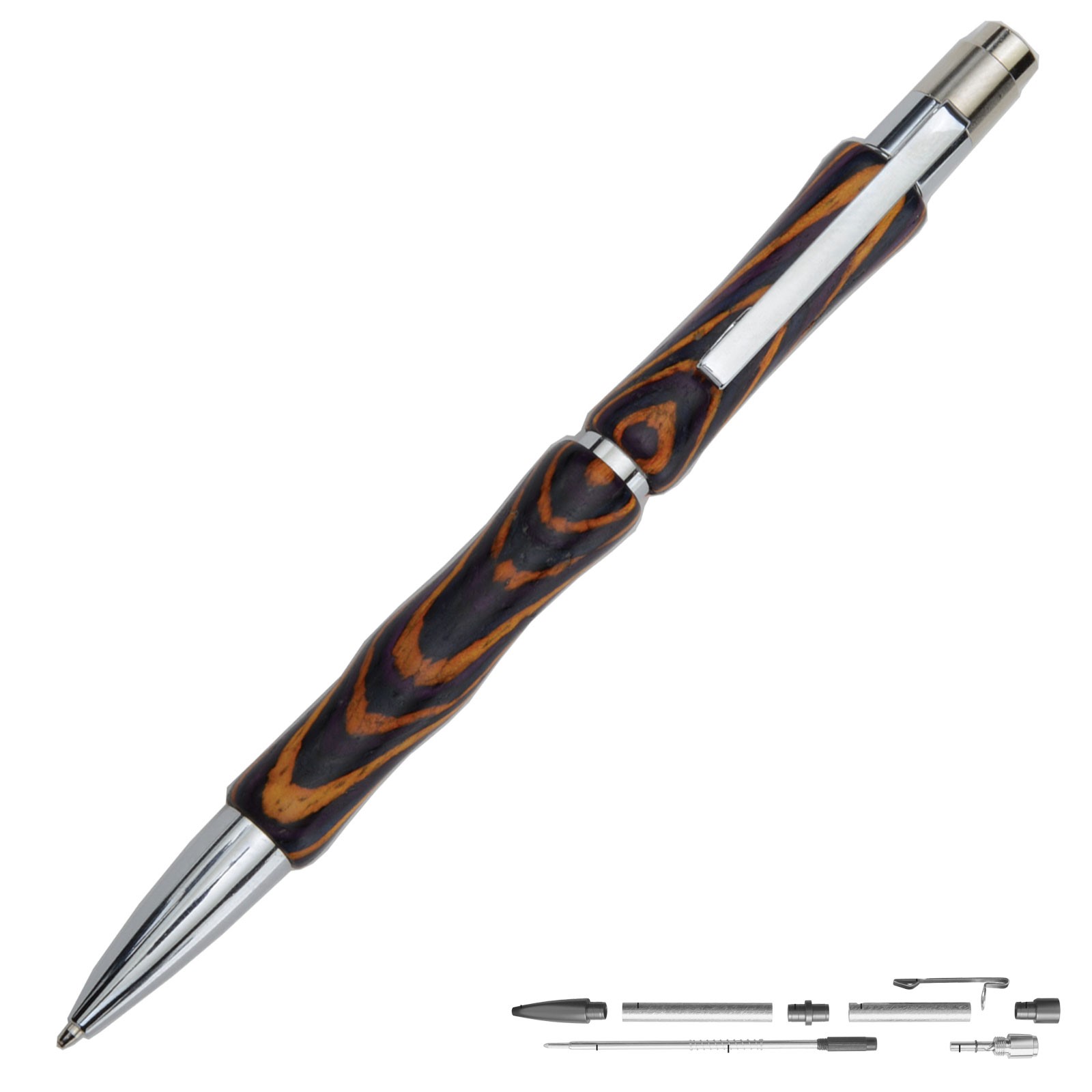

This kit, named the Luxor, is from William Wood-Write in Canada. . It just became available about three weeks ago. It uses the Schmidt SKM-88.
This kit is the 4th commercial kit using the Schmidt Click Mechanisms ... as far as I know. . I have tried them all and I like this one from WWW the best.
Earlier this year there were 3 releases of similar kits.
1) In about March PSI released the Duraclick EDC using the Schmidt SKM-88 mechanism
2) A few weeks later, PSI released the Everday Classic using a different, but similar, Schmidt mechanism
3) In about September, Berea released the kit called the Blade, which also uses the Schmidt SKM-88 mechanism
One criticism of the Duraclick is that the length of the metal clicker at the top end of the pen is not aesthetically attractive.
This latest kit, the Luxor, has the metal clicker partially recessed into the top end finial piece, and thereby somewhat overcomes that criticism.
Another attractive feature of the Luxor is the fluted nib design, which I rather like. . I also like the solid metal clip.
One possible drawback is that the Luxor, like the Duraclick, uses a plastic extension piece on the Parker refill, a little shorter than for Duraclick.
I think this could be eliminated easily on the Luxor by shortening the 2.78" long barrel by about 0.32", a rather small change.
Here are a couple of pics of the Luxor, which I made yesterday. . One shows the refill extended, the other shows the refill retracted.

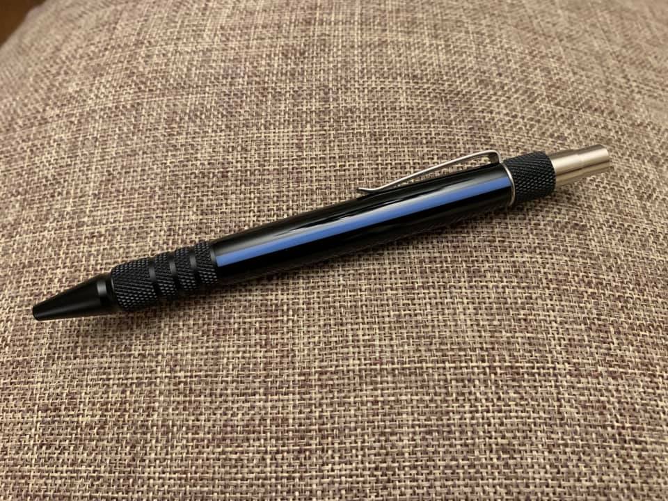

And I'll have to add that the EDC Dura Click is my best seller. All my police officer friends want one and I haven't heard any complaints from their use in the field.
Since you posted a black pen, you might want to get some black SKM-88 click mechanisms from Richard Greenwald LLC
... Extra cost, of course, but may be appropriate

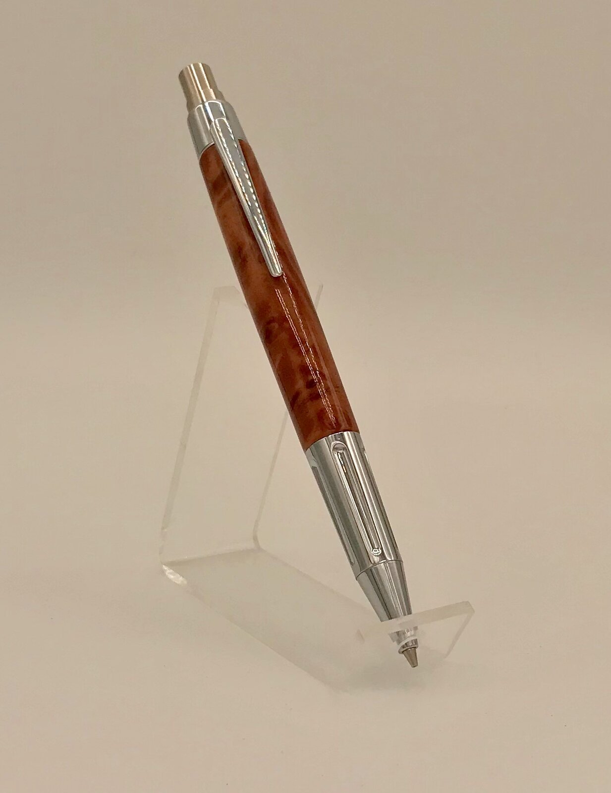

I just recently used the Luxor for a pencil. I used a Schmidt pencil mech, but had to clip about 1 mm off the end to get it to work.
I know, no pic, it didn't happen. I foolishly only took a couple of quick pictures. This one shows the pencil mech tip.

No problem Mal. Yes it is Thuya.
A client wanted a rollerball and a pencil to go together. Although I don't like the refill extension of the Luxor, it worked out well for converting to a pencil.
