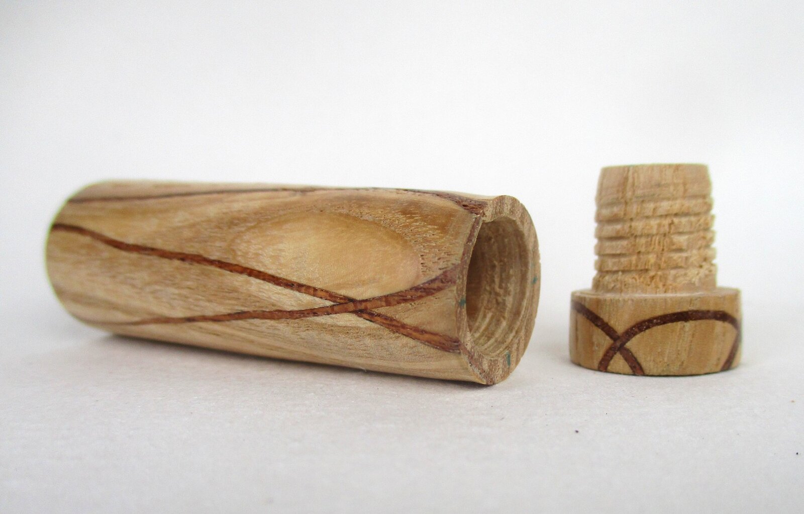

Any advice regarding tap and die on timber?
I tried soaking the tenon with CA but I think that the tenon is so small a diameter that it kept breaking off.
Here's a picture of one that held together but doesnt thread. It works better as a friction fit. IMG_2254.jpg

Louie, many thanks for your reply.
I will check out the reference that you gave.
You are right that a metal cutting set won't do the job.
The internal diameter of most of my tubes are 11/32, external just over 1/2 inch, as in the photograph.
The one successful one that didnt break didnt screw that well anyway and just pushed in.
I found that it was far easier to just cut the cap with a plug to friction fit the body.
Thanks again
