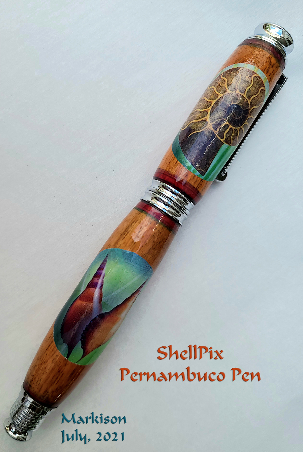

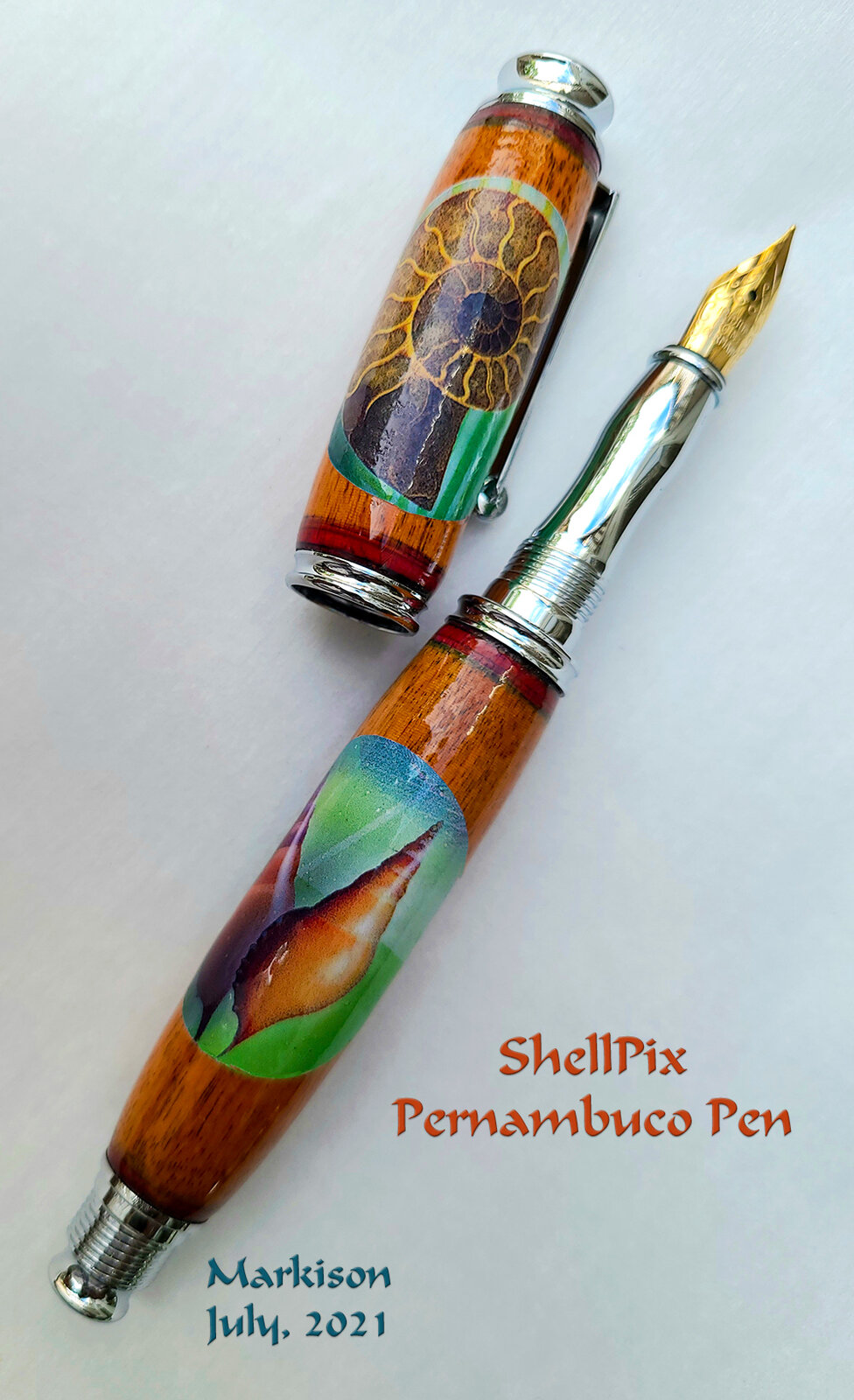

I'm still on a UV Epoxy Resin/No Sanding expedition (aka addiction).
This one is for an California Academy of Sciences friend who is interested in shells (Fibonacci sequence/spirals, etc).
Steps:
Painted the shell subjects "from life" in acrylics; original paintings are 6x6".
Scaled down the images, then inkjet printed them onto white Sunnyscopa brand decal stock.
Spray-coated the decals with Krylon UV Archival Varnish (3 coats over 3 days).
Turned the Pernambuco smoothly with carbide tools (no sanding; still tired of sanding).
Brush-coated the 1st coat Alumilite UV Epoxy Resin onto the turned barrels.
Cured the epoxy with a 365 nanometer UV lamp (same method as I described in previous posts).
Applied the decals, then alcohol-inked the barrel ends.
Brush-coated the 2nd coat Alumilite UV Epoxy Resin onto the decal'ed/inked barrels.
Assembled the Virage chrome fountain pen.
ShellPen,AcrylicPtgs,UVEpoxy,Decal,EtOHInk,EpoxyFinish,markisonJul,2021,capoff,1000px.jpg
Warm regards to all - Bob

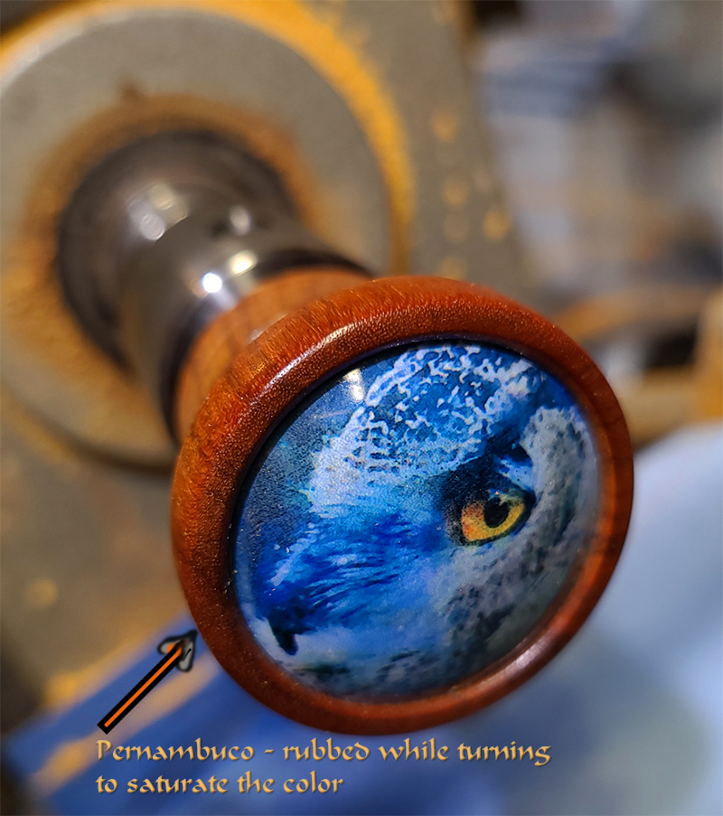

I like Pernambuco for it's warmth and color fastness over time, and it turns very smoothly - good candidate for my no sanding program. I also like the way the orange tones deepen when the wood is rubbed (carefully) with a shop towel or cloth while turning at a medium speed - yields some nice gradated tones - this bottle stopper rim was rubbed to intensify the orange and bring out the Owl's eye:
That color is a little more orange than the pen, but it may just be the background/lighting. It reminds me somewhat of Chakte Viga, but sounds like it will hold the color better. I've noticed purpleheart intensifies with friction, too.

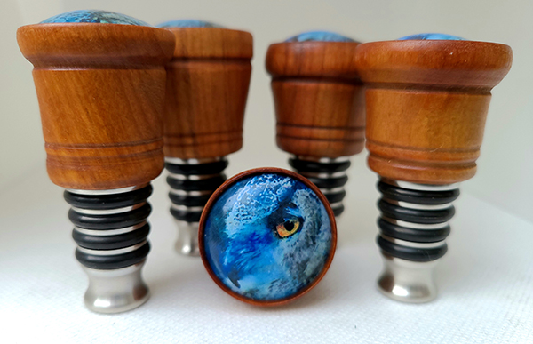

My first thought when I saw the stopper, was the eye of a hurricane, but I do see the owl in it. Is the dome created by the wood underneath or by the resin over top of the decal? Does that resin even form and harden in a dome (meniscus)?

Todd - The Night Owl:
First I painted the Night Owl portrait from my initial life drawing of a rescued owl - watercolor under painting, topped with acrylic gouache, 8x8":
Then I photographed the image, scaled it down, printed it onto dye sublimation paper with sublimation inks using an Epson Ecotank 3760 printer which I converted for dye sublimation work; then heat pressed the paper onto a polyester polymer-treated aluminum disc (400 degrees F x 45 seconds). I domed the disc by hammering it into a concave (Next Wave Automation SD100 CNC router-created) hardwood dapping block (protecting the face-down image with a shop towel to avoid scratching); and inlaid it into the lathe-turned Pernambuco. A friend saw it and requested a handful of them:
This is a fun technique. I plan to scale down some other original artwork for use in pens (and other things).
Best regards - Bob

@Bob in SF, thanks for sharing your technique on both the pen and stoppers! That's a lot more than I'm going to get myself into for the time being, but I do love your innovation and "mixed media" approach. The painting is beautiful, too!
