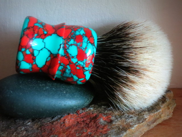

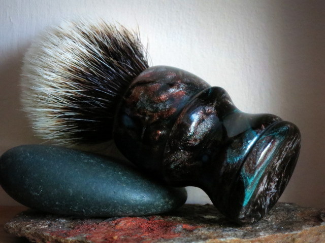

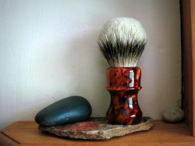

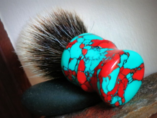

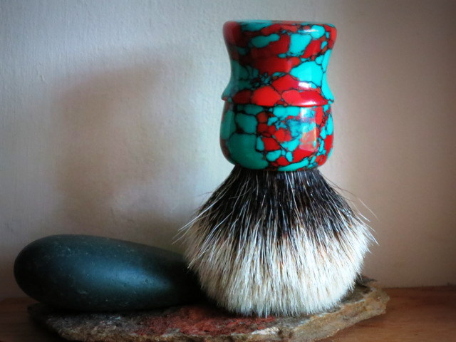

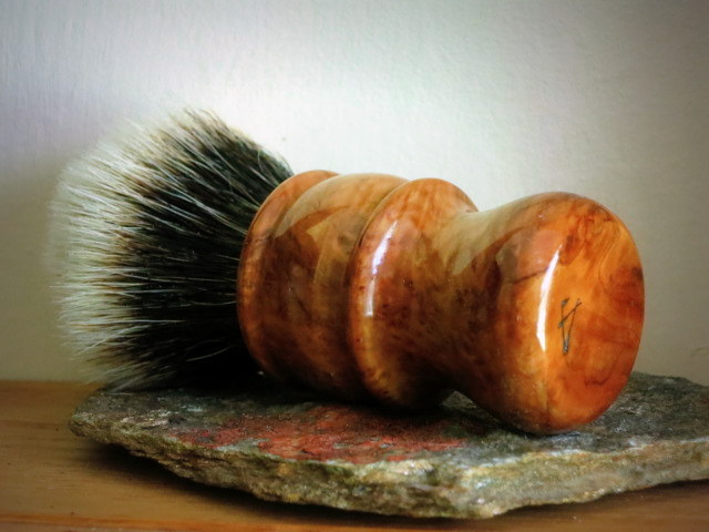

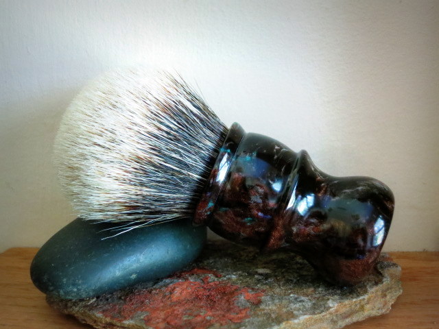

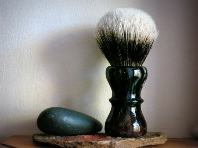

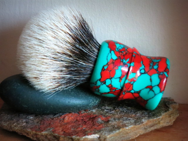

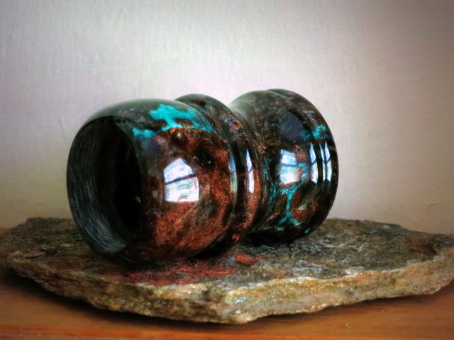

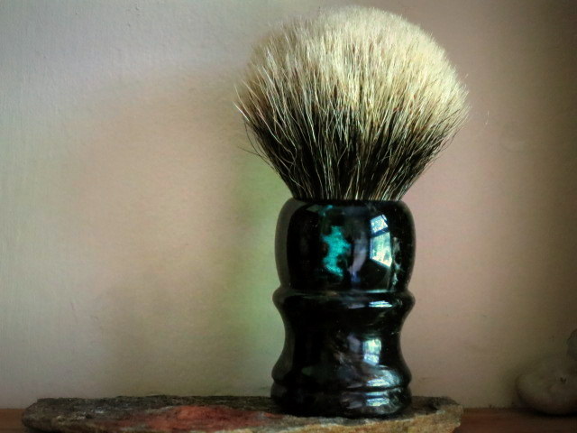

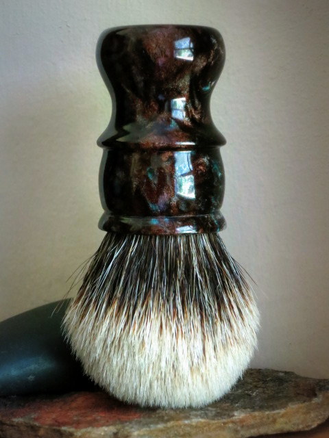

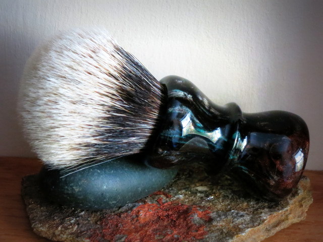

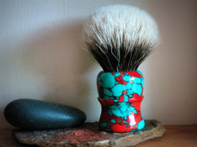

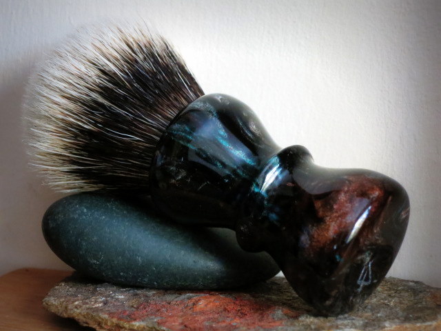

I have created a brush in Turquoise and Coral Tru-Stone. this is my forst time turning Tru-Stone and I am very impressed with this material. It actually feels like stone in hand. It's colder, heavier and just conveys the stone feeling in general. Turns about the same as resin. Very, very beautiful stuff if you enjoy the stone. Polishes to a high gloss very well and is a joy to behold.
Brush Dimensions (approximate):
Total height: 93mm
Handle: 45mm
Loft: 48mm
Knot: 25mm Bulb shape

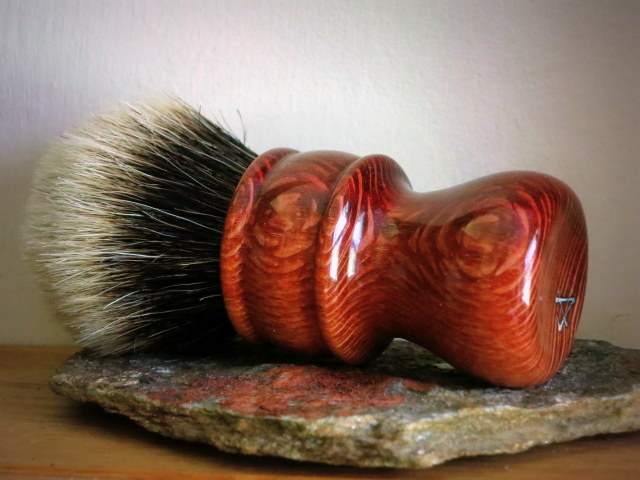

vferdman
Aug 23, 2014
263
Western Massachusetts

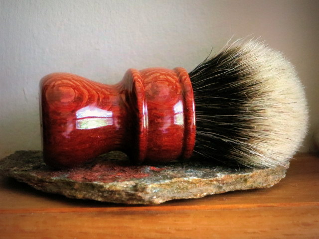

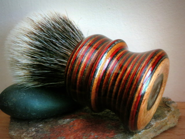

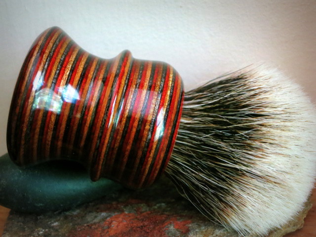

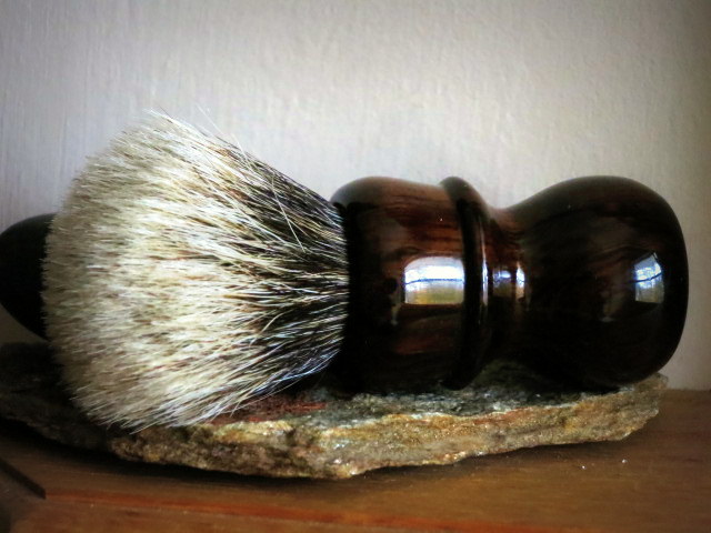

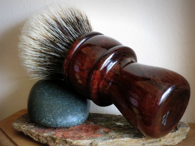

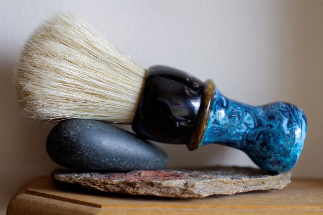

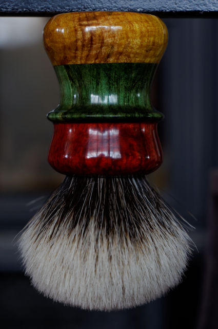

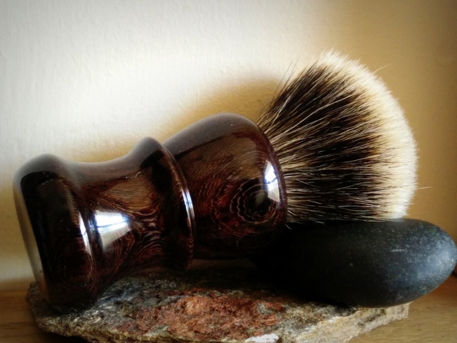

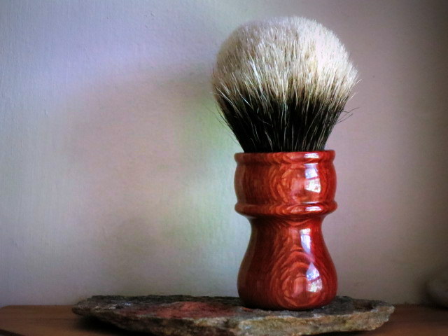

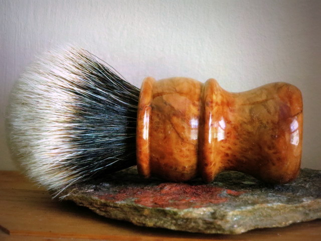

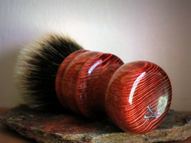

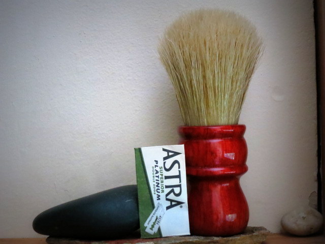

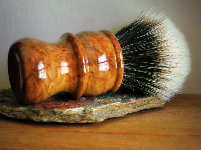

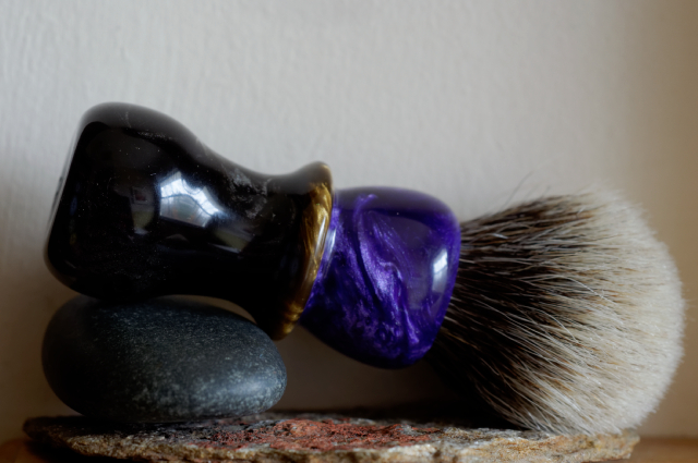

I have created a new brush with a Dymnodwood handle. The Pattern is called Royal Jacaranda and I chose to turn the blank in an unusual way for Dymondwood. Rather than having the layers oriented in a vertical axis I chose to turn them oriented in a horizontal axis. This has the effect of creating horizontal 1/16" wide stripes. I think this is an interesting and different way to turn Dymondwood. I like the way it turned out. This is a fairly large brush (28mm knot) and is in the Chubby style.
Total height: 102mm
Handle: 51mm
Loft: 51mm
Knot: 29mm bulb shape

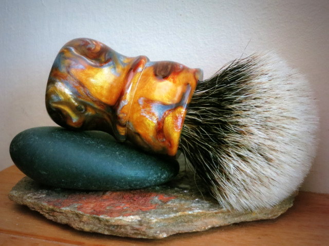

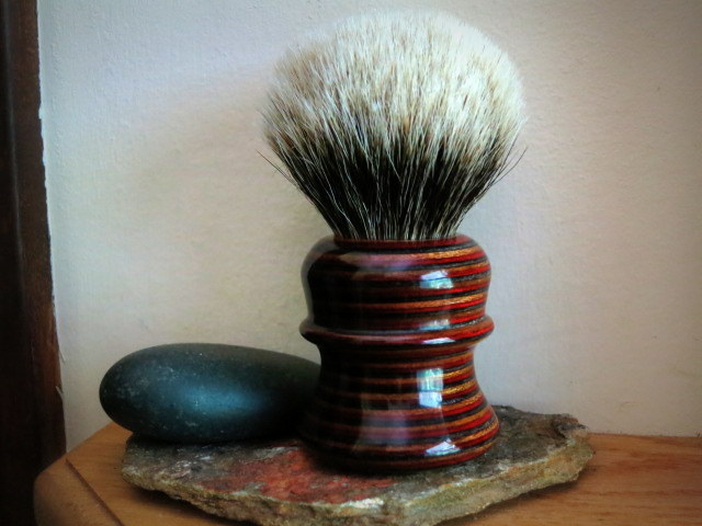

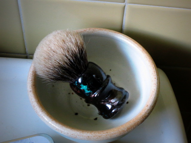

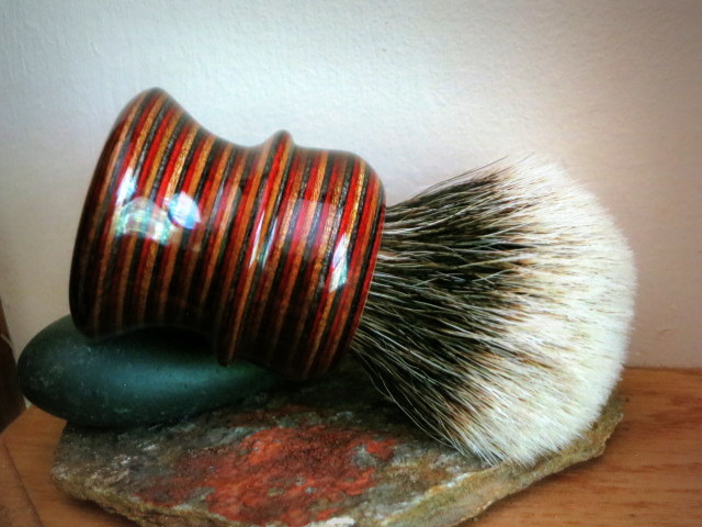

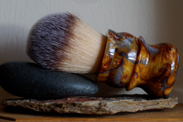

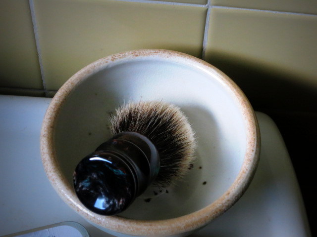

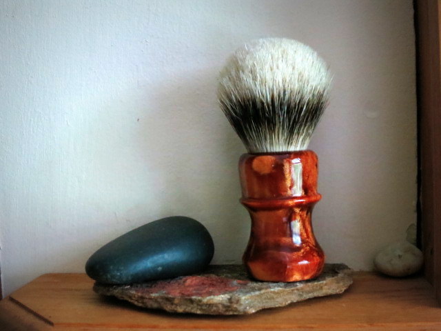

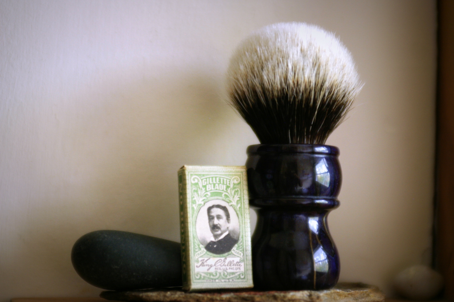

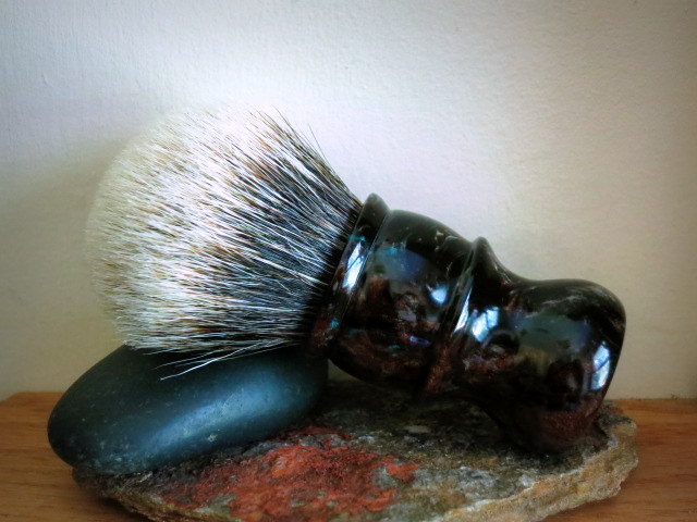

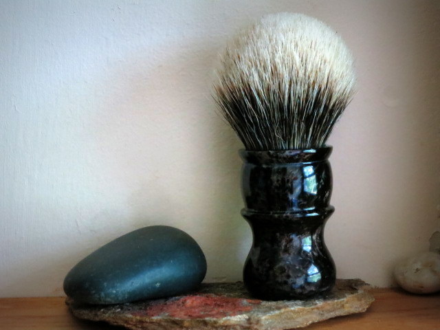

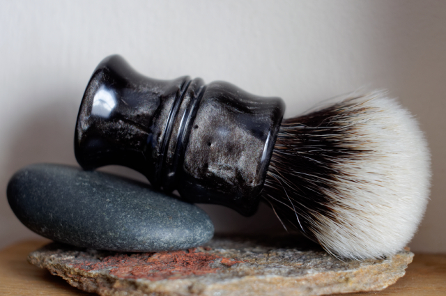

Another brush made for a custom order. This customer did not want me to glue the knot in so he could use a less permanent adhesive to possibly change the knot in the future. He also provided the two band finest knot. This one is made with acrylester resin called "Black Peacock". It's amazingly beautiful and really defies being photographed properly. There is a lot of light play in this one and still photography just does not do it justice.
Total height: 105mm
Handle: 55mm
Loft: 50mm
Knot: 28mm bulb shape

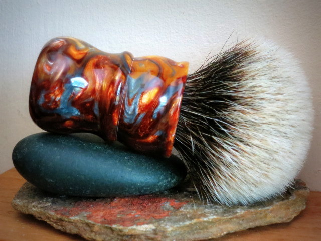

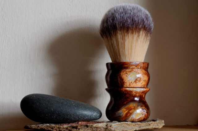

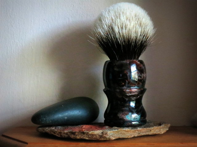

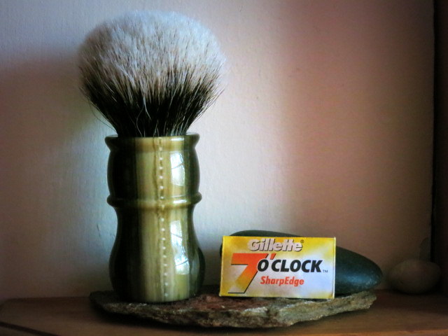

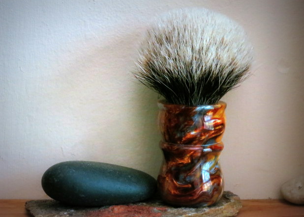

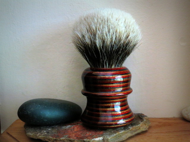

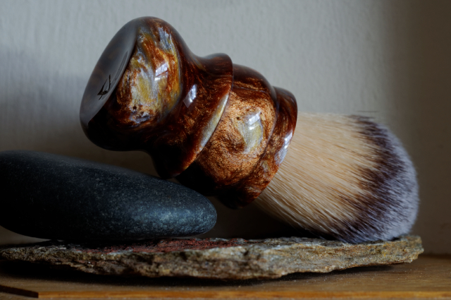

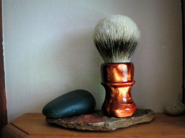

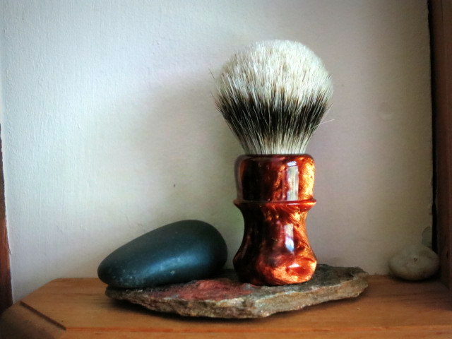

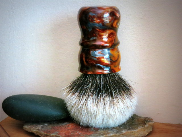

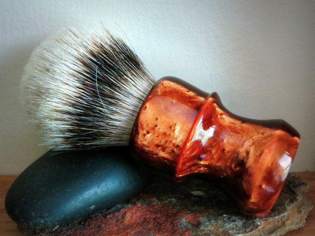

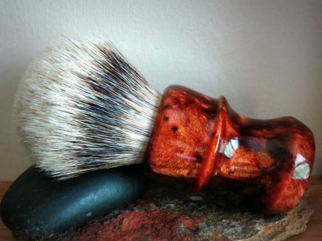

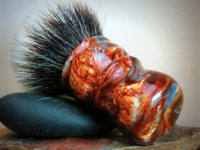

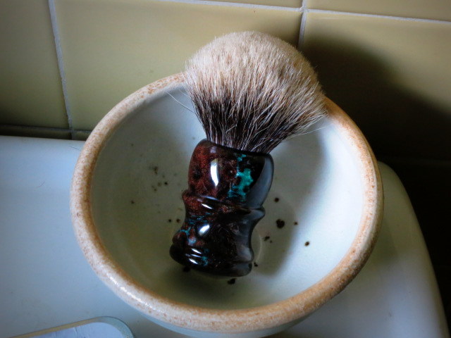

Another custom order is complete. This one is in "Bronze" resin, but looks a lot more like actual copper color. Very pretty. The knot is TGN Silvertip Grade A. I rarely use anything other than TGN two band finest, but I must say, this knot is very good. It is more like the two band type hair in terms of sturdiness and is very soft. It's pricier than the two band finest, but sure is nice.
Approximate dimensions:
Total height: 103mm
Handle height: 55mm
Loft height: 48mm
Knot: 26mm

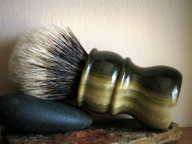

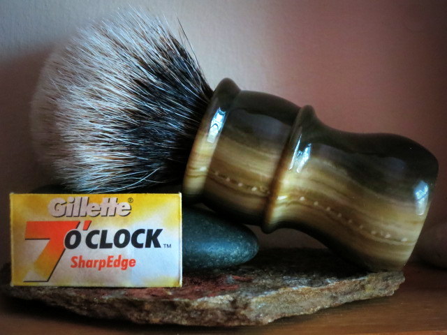

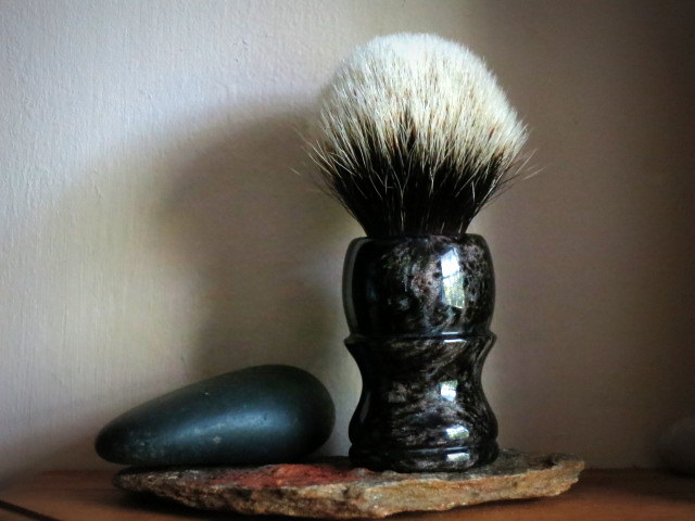

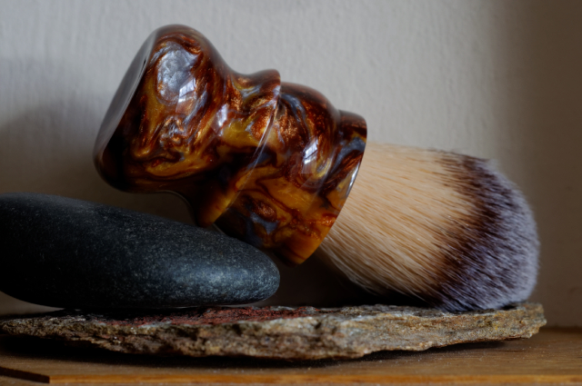

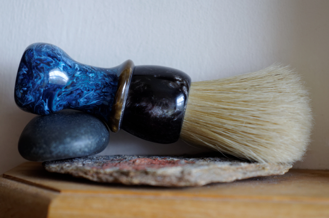

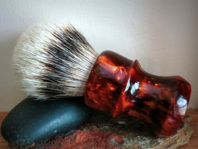

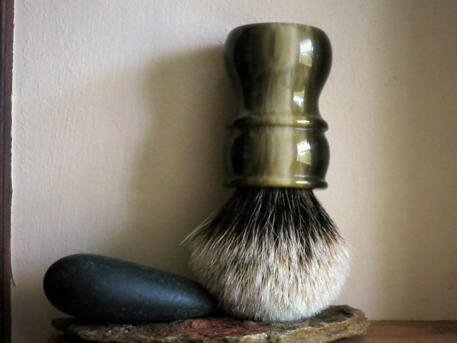

I have created two new brushes. One for a custom order and one for my Etsy store.
First, here is the new addition to my Etsy store inventory. This one is made of faux horn resin. Very beautiful material made in Germany. I made this one quite tall. The knot is TGN two band finest.
Total height: 114mm
Handle: 65mm
Loft: 49mm
Knot: 27mm bulb shape

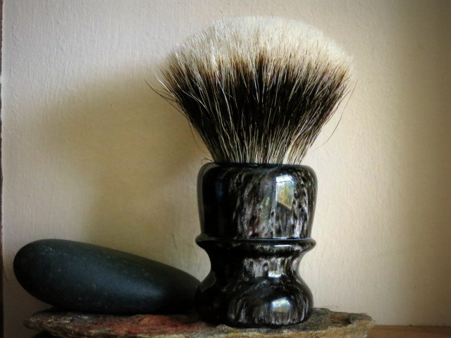

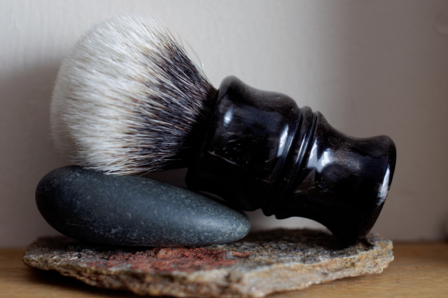

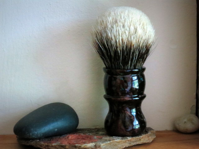

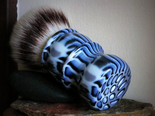

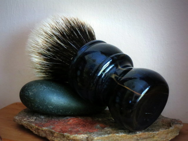

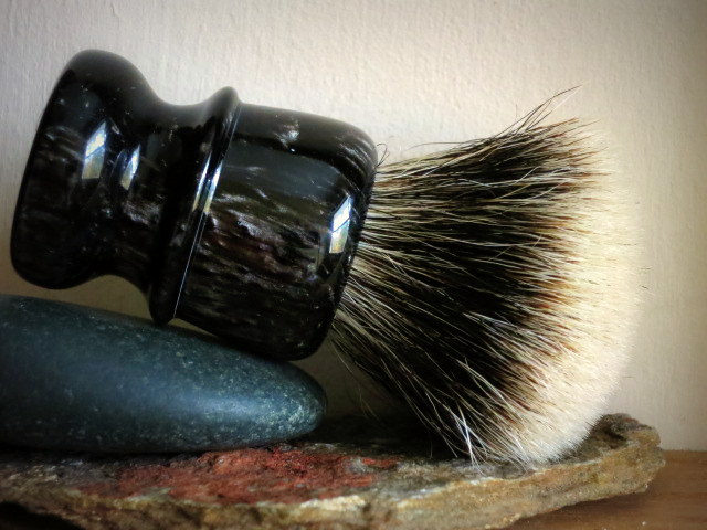

Here is the custom order brush I made for a fellow in Belarus. This one is made with Black Peacock resin that I am really liking. The knot is TGN two band finest.
Total height: 105mm
Handle: 57mm
Loft: 48mm
Knot: 24mm bulb shape

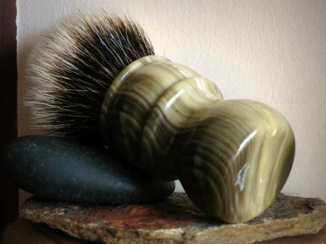

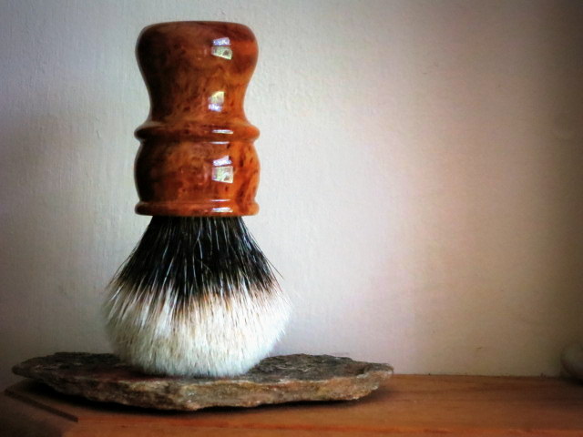

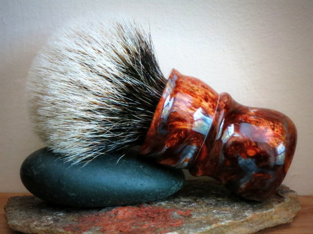

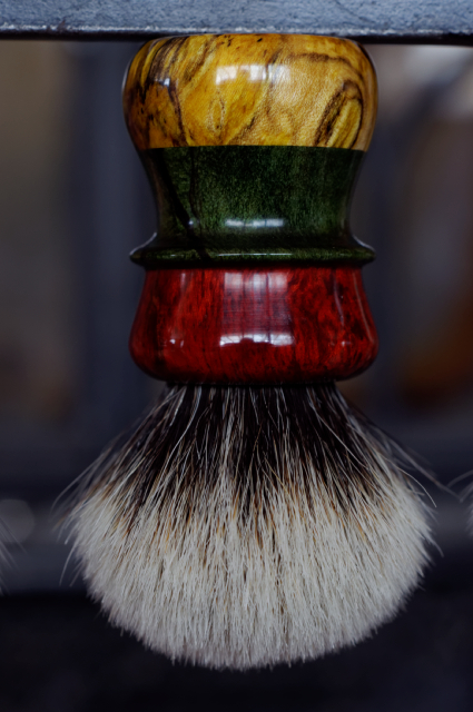

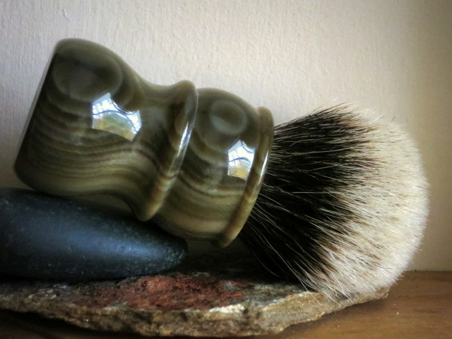

I have created a new brush from a material new to me. It is resin stabilized spalted maple. This brush is made with blue resin stabilized wood, which is absolutely gorgeous. I finished it with multiple (9-12) coats of CA and polished it to a high gloss.
Total height: 109mm
Handle: 59mm
Loft: 50mm
Knot: 26mm bulb shape

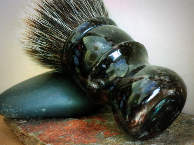

I have created a new brush for my Etsy store. This one is made with a very popular Black Peacock resin and TGN two band finest badger. I decided to make a design that is a little different than my usual renditions of classics like M7, Chubby, etc. This one is loosely based on Ever-Ready hour glass handles of old that I like a lot. I find this shape is very comfortable and this particular handle is no exception. In test lathering it I found it very comfortable. I hope you like it.
Total height: 109mm
Handle: 60mm
Loft: 49mm
Knot: 27mm Bulb shape

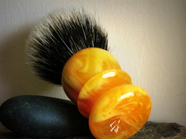

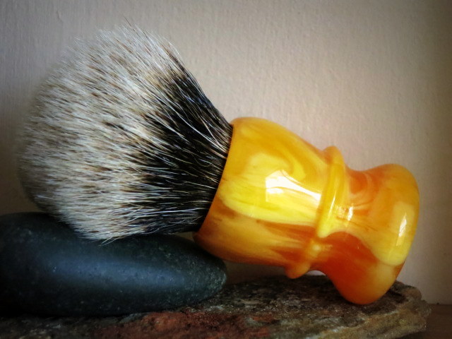

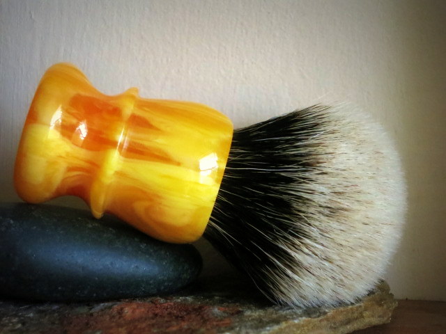

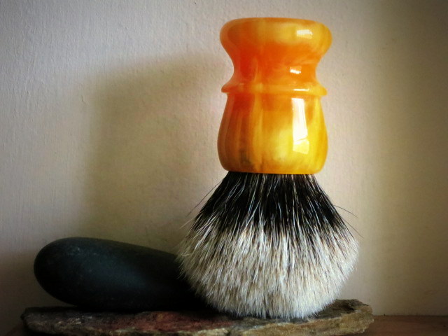

I have created some new brushes for my Etsy Store.
It's been a while since I made a butterscotch brush, so here it is. Beautiful material and TGN two band finest that is still very good quality and value. The knot on this one is perfectly shaped and feels great.
Total height: 96mm
Handle: 48mm
Loft: 48mm

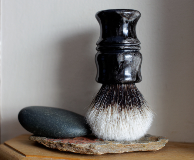

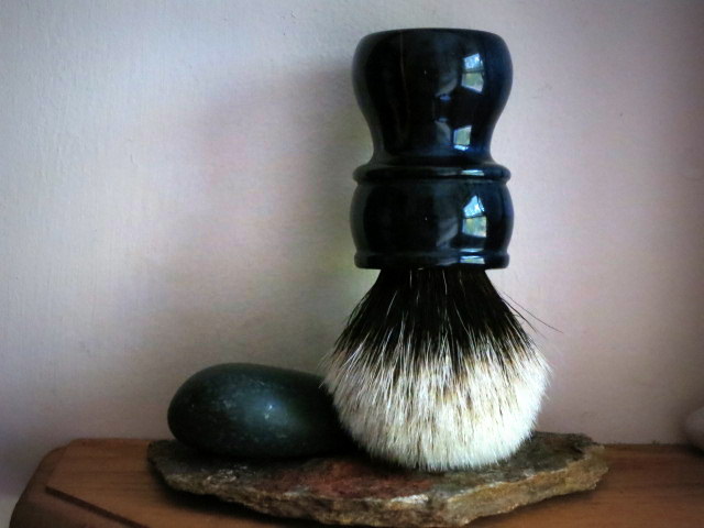

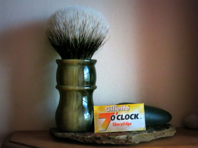

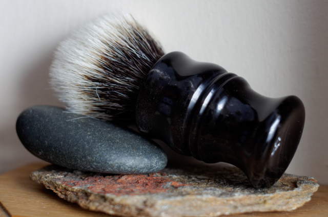

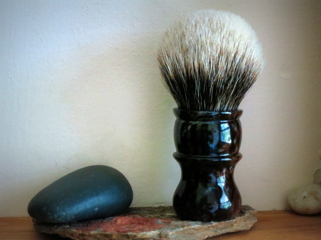

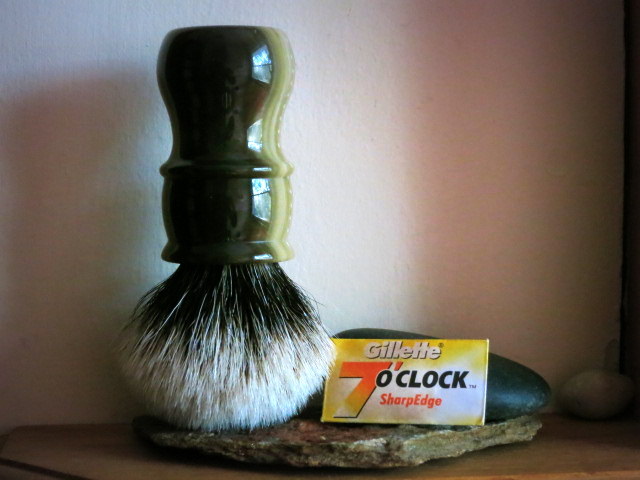

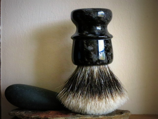

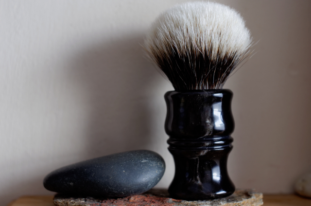

Next up is a brush in "Black Olive" resin. This material has quickly become very popular and for a good reason. It is gorgeous. Very difficult to describe or photograph, but in person it is just a beautiful resin. If you like black brush handles, you will probably love this one. TGN two band finest knot in fan shape is excellent and passed my tough selection process.
Total height: 99mm
Handle: 51mm
Loft: 48mm
Knot: 27mm Fan shape

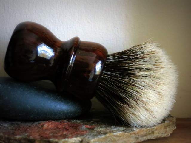

vferdman
Aug 23, 2014
263

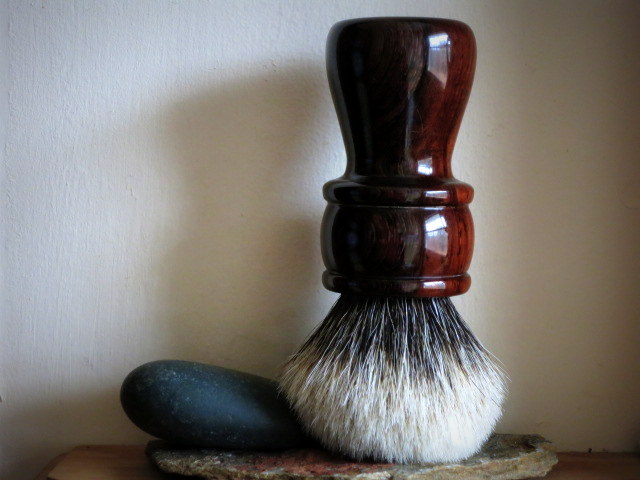

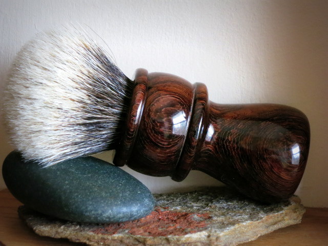

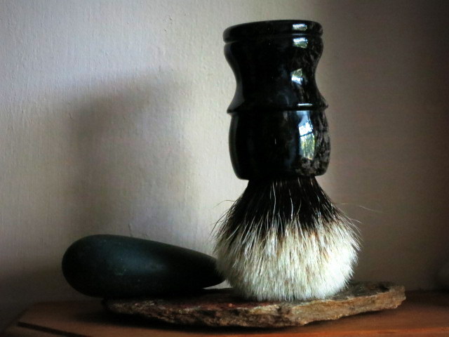

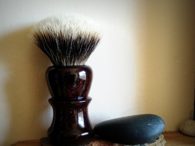

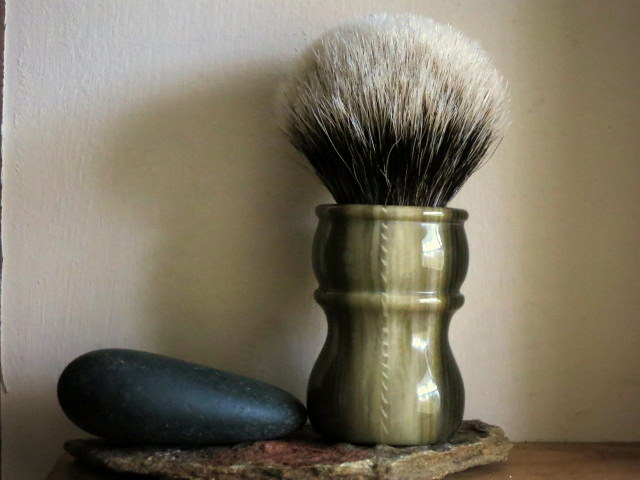

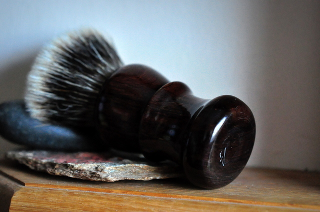

I have created a brush made with South African Ebony. This is a smaller brush, good for traveling or everyday use. TN two band finest knot of my selection.
Total height: 95mm
Handle: 53mm
Loft: 42mm

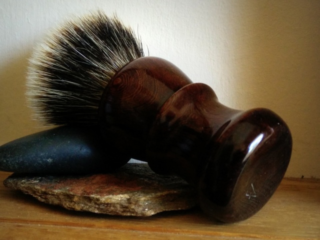

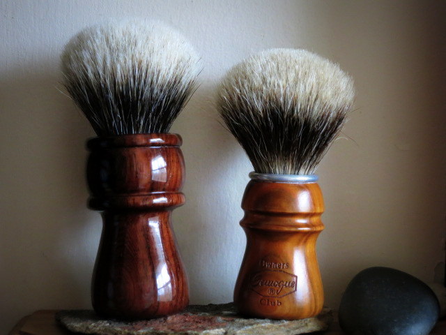

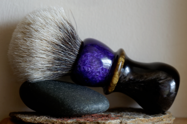

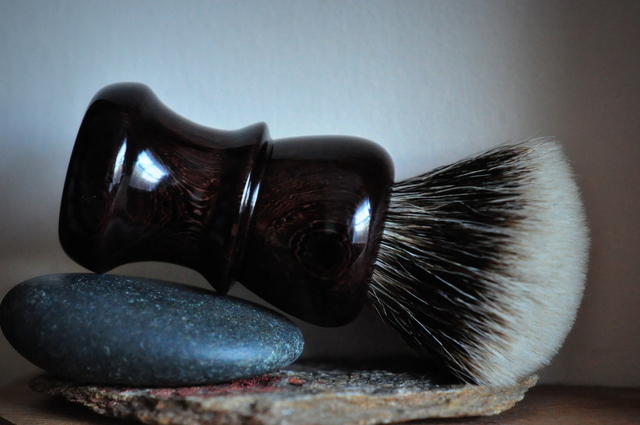

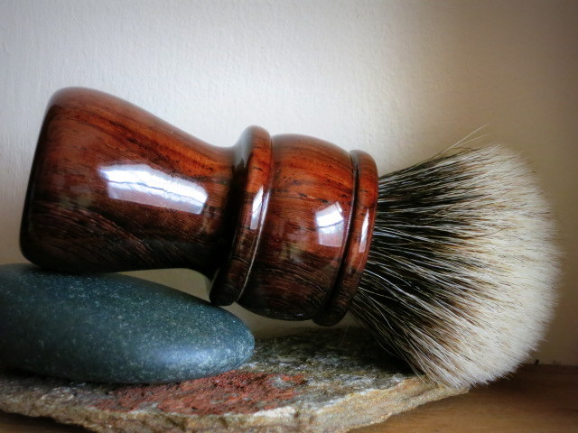

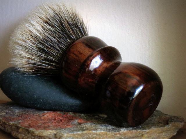

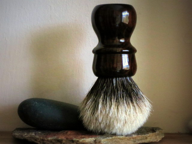

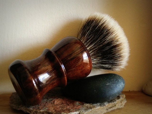

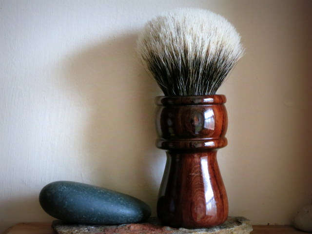

I have created a brush for a custom order. This one is made with Burmese Blackwood and TGN two band finest knot. The wood is finished in multiple coats of CA polished to a high shine. The TGN knots I have received in my latest shipment are reminiscent of the older TGN knots that made TGN so popular. These are beautifully shaped and very dense two band knots with great looking colors.
Approximate dimensions of the brush:
Total height: 124mm
Handle height: 75mm
Loft height: 49mm
As can be seen from the last picture, the brush is large and towers over a SOC two band.

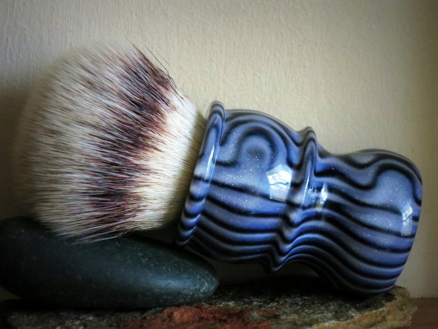

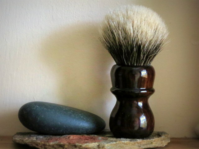

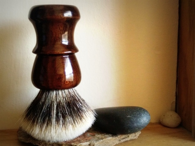

Another custom order and another Burmese Blackwood handle. This time with a customer-provided two band fan-shaped knot.
Total height: 118mm
Handle height: 71mm
Loft height: 47mm
Knot: 28mm

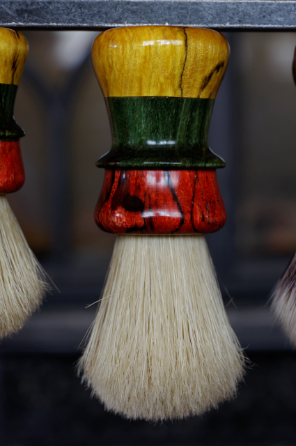

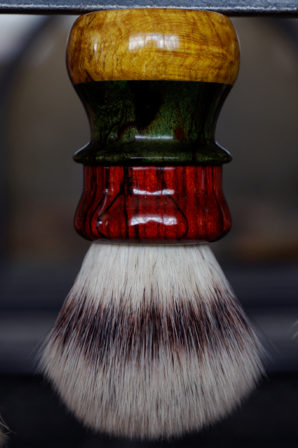

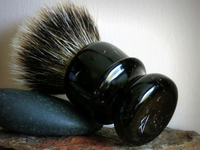

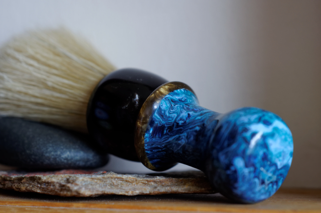

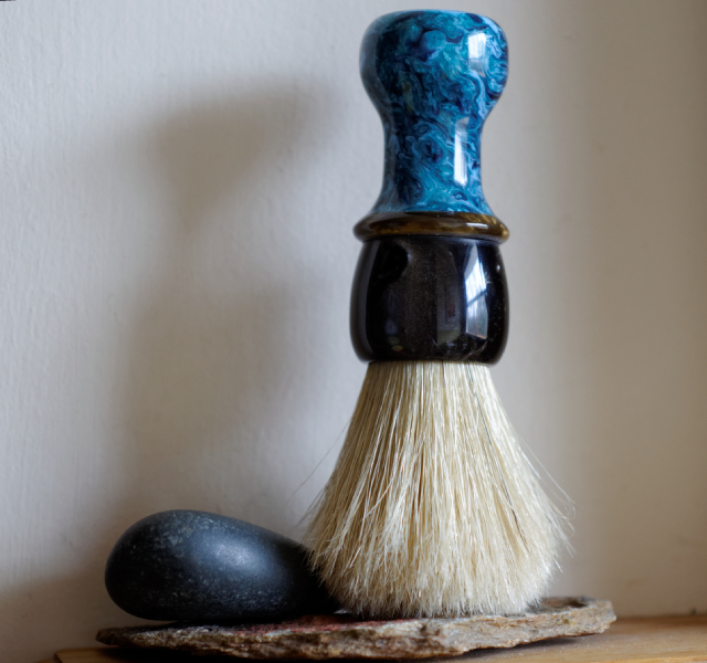

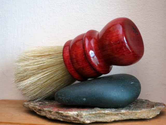

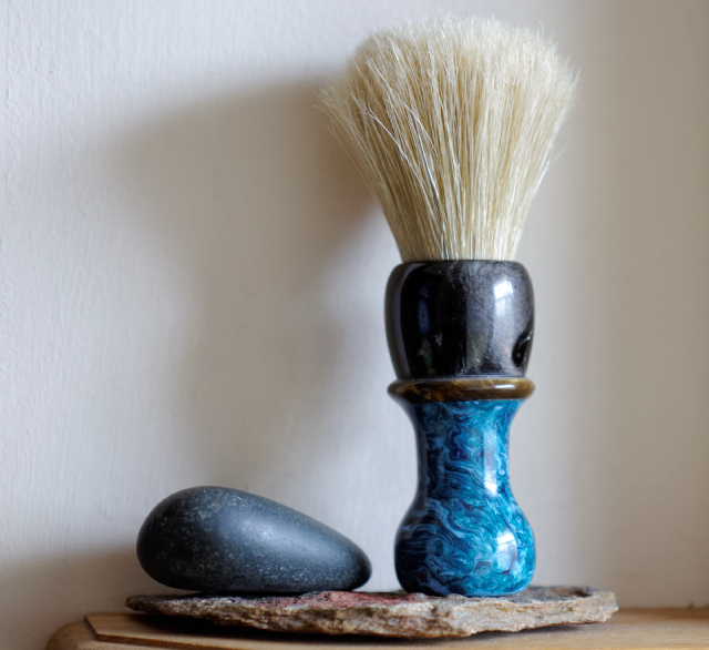

I have created a Boar brush for a custom order. This one is made with three different resins: Black Olive, Antique Gold and Watery Abyss. It is styled as a longer barber brush and uses a wonderful blond boar from Omega.
The approximate dimensions are:
Total height: 141mm
Handle height: 81mm
Loft height: 60mm
Knot: 28mm

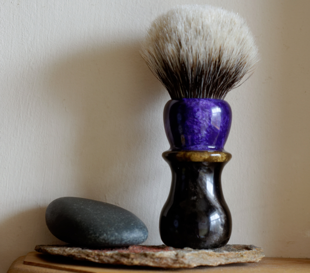

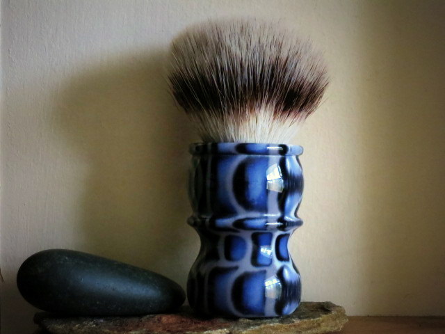

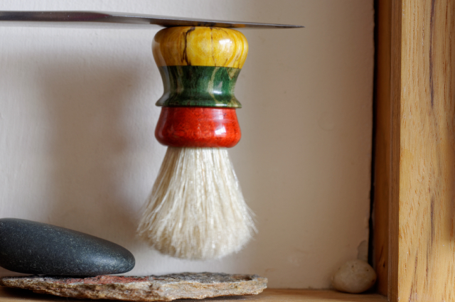

I have created a brush that will have 6 more like it for a group buy in Lithuanian knife forum. The request was to make a brush with the colors of Lithuanian flag: Yellow (Sun), Green (Nature), Red (Blood). There are going to be three boar brushes, one synthetic and three two band finest badger. The butt of the handle contains a rare Earth magnet for hanging the brush on metal surfaces. The orientation of the flag is right side up when the brush is suspended by the magnet. The first of the seven brushes is done and it sports an Omega boar knot. Handle material is color resin stabilized spalted maple that I cut from different color blanks to create the tricolor pattern desired.
Approximate dimensions are:
Total height: 100mm
Handle height: 51mm
Loft height: 49mm
Knot: 25mm

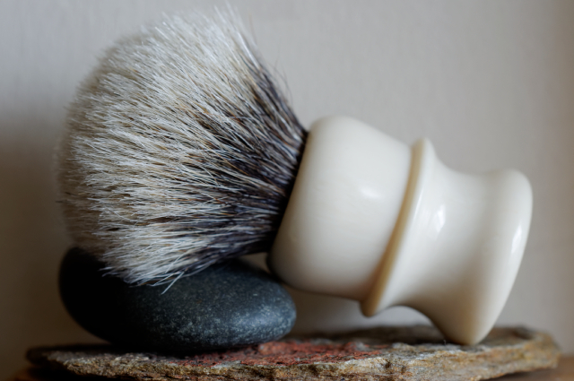

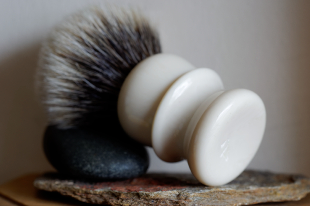

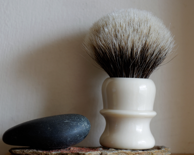

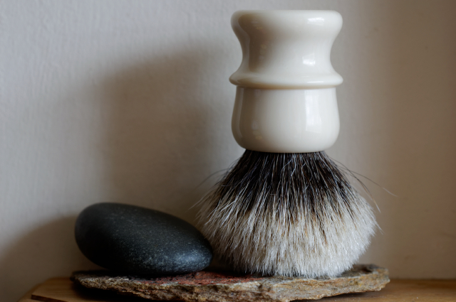

I have created another brush for a custom order. This one is in Faux Ivory and TGN two band finest badger.
Dimensions:
Total height: 101mm
Handle height: 51mm
Loft height: 50mm
Knot: 27mm bulb shaped

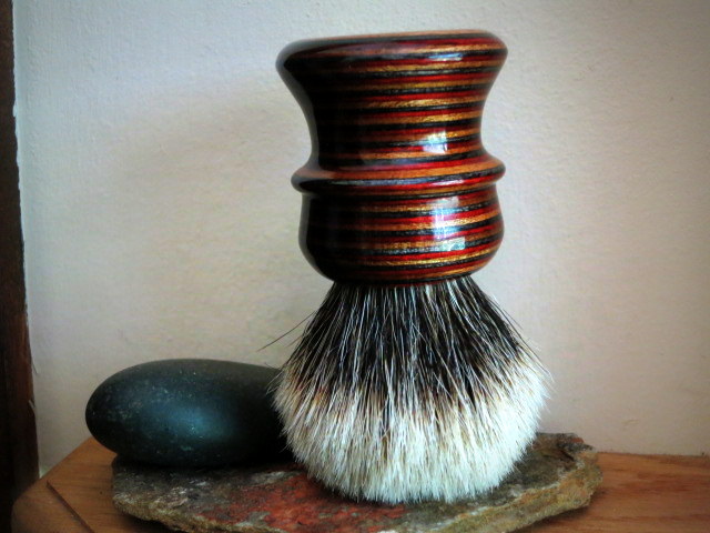

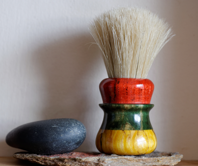

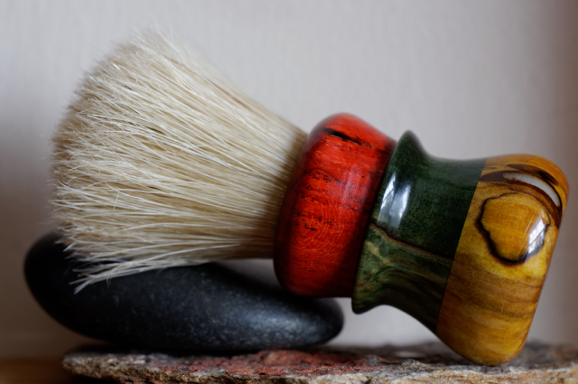

I have created a new shaving brush for my ETSY shop. This one is special as I am experimenting with combining different resins in one handle. I think this one came out very beautifully. It's a taller handle in Barber's Brush style. The knot is the latest version of TGN two band finest, which I find very good. Dense, very well shaped and beautiful sturdy hair with soft tips.
Total height: 125mm
Handle: 76mm
Loft: 49mm

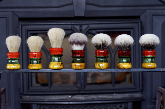

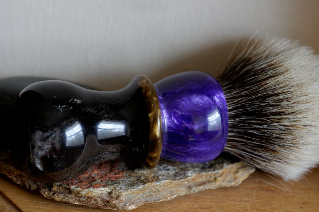

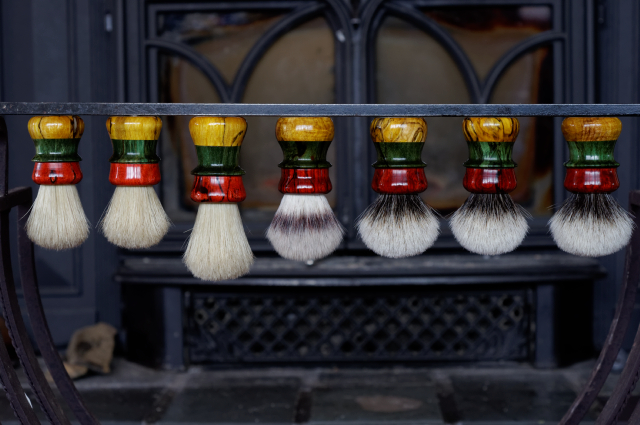

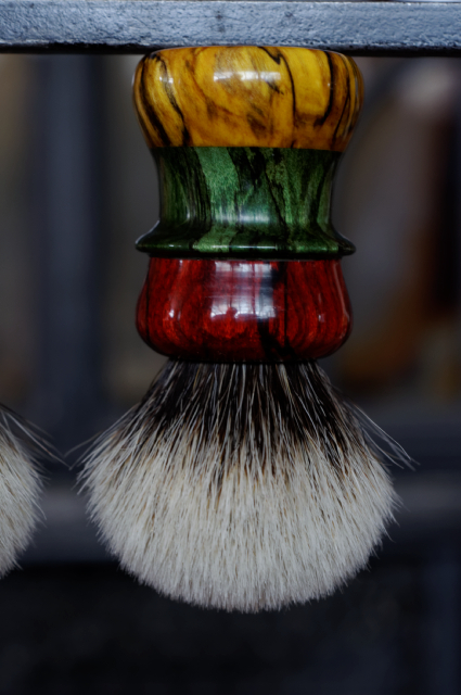

As I mentioned above, I was commissioned to make a series of seven brushes in the colors of the Lithuanian flag: Yellow, Green, Red. The series has three two band badger brushes, one synthetic and three boars. I used TGN for badgers, synthetic and one of the boars. Used Omega brushes I got for the purpose of harvesting the knots for the 24mm knots. TGN sells an excellent 27mm Omega knot, which is what I used for the larger boar. I remove the black rings from the Omega boars so I can set the loft as I like. The handles in this series also contain a rare earth magnet in the bottom so as to be able to hang the brush from a metal surface. The prototype had a smaller magnet that worked, but I felt a more powerful magnet would be nicer, so I ordered some 3/8" magnets for the rest of the series. Boy, those things are strong! Very good snappy feel to the magnetic action even on the heavy, wet brush.
Smaller Boars:
Total height: 100mm
Handle height: 51mm
Loft height: 49mm
Knot: 25mm
Larger boar:
Total height: 123mm
Handle height: 65mm
Loft height: 58mm
Knot: 27mm
Synthetic:
Total height: 108mm
Handle height: 58mm
Loft height: 50mm
Knot: 29mm
Badgers:
Total height: 105mm
Handle height: 57mm
Loft height: 48mm
Knot: 27mm

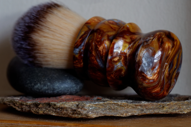

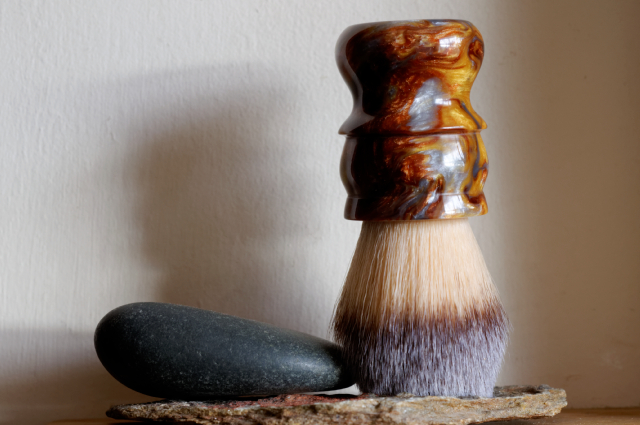

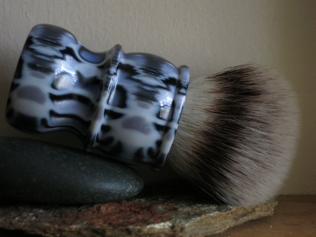

I have created a brush handle by custom order for a Plisson synthetic knot. The material is resin in "Molten Metal" pattern. What a gorgeous resin this is!
Total height: 100mm
Handle height: 50mm
Loft height: 50mm
Knot: 26mm
