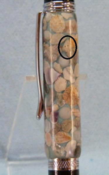

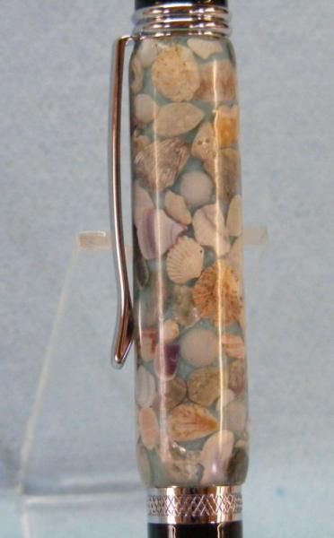

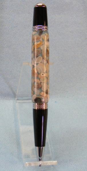

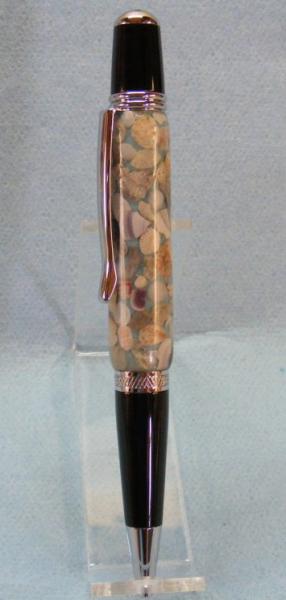

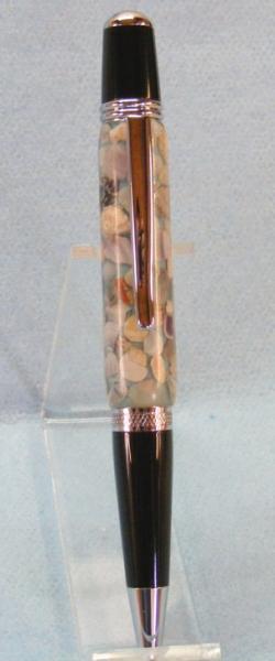

ok, i had to go to fly to orlando, drive 3 hours to Vanderbilt beach in Naples, pick shells small enough to go on a pen, spend an entire week searching the beach and the gulf, resting in the sun when necessary(it often was), drive 3 hours back to orlando, fly back home, strategically place shells on a Sierra tube (painted light blue/green, cast in clear pr, turn and assemble on a Sierra chrome and black pen.
The lengths I will go to for making a pen know no bounds :wink:
As always, comments, good or bad always welcome!

Jennifer that is about the wildest Idea I've seen, I think a Sierra Vista give a little more wiggle room, tubes are the same size but the outside diameter is a wee bit larger. I'm getting some for my snake pens, there isn't a lot of wall thickness at the ends on a regular Sierra, How big of a magnifying glass did you use to find that many Tiny Tiny little shells?

Ken, that's a good idea! I hadn't thought about the Vista since i don't have any! I will need to get a few for some other ones i'm doing too! Oh and thanks for reminding me~ no magnifying glass BUT... as I was bent over looking for shells, a lovely wave came by and took my glasses ( on day 2) so I had to have my prescription faxed down so I could spend $400 on a new pair of glasses so I could continue my search for tiny little shells!!!!

Awesome pen Jennifer . Are you sure you didn't catch one of them hermit crabs in there ? there seems to be one looking out and smiling (inside circle)

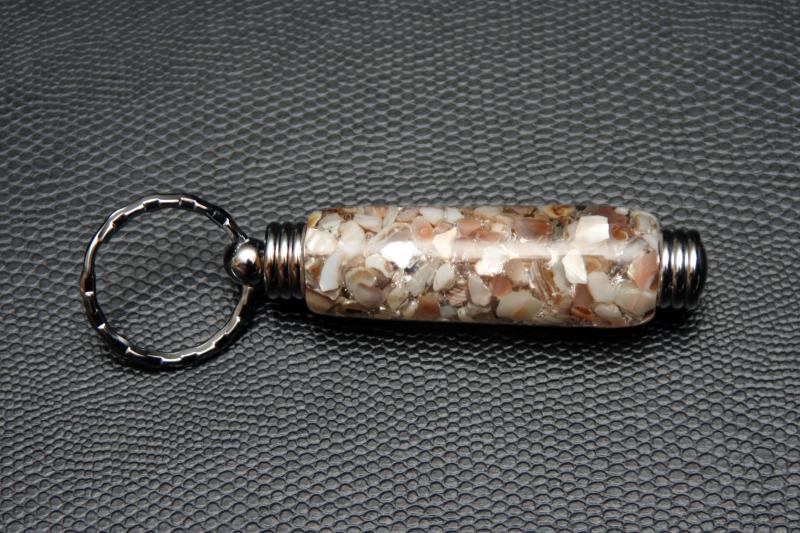

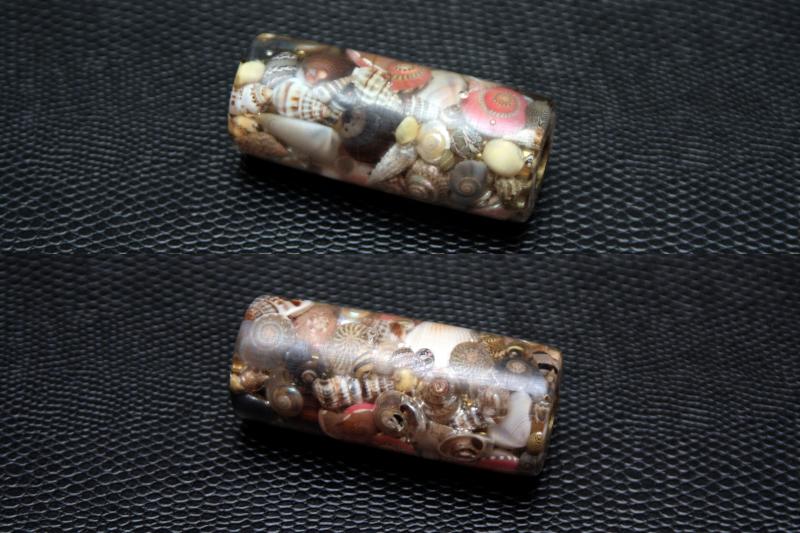

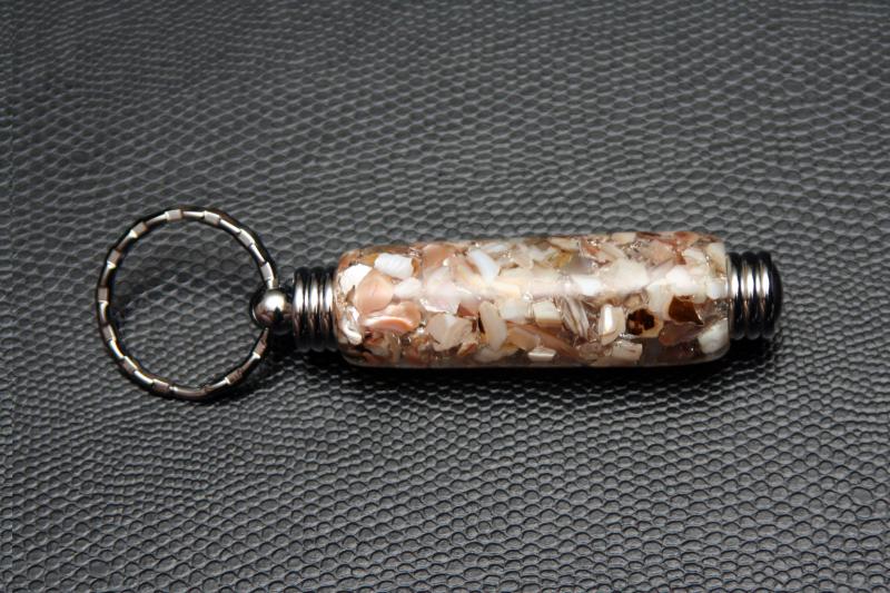

I tried a keychain with broken shells few months back and one couple weeks ago with small shells.

Thanks Max~ Keith~ Cindy~Larry now you have me thinking I need to make a matching key chain...they look great! did you also glue them to the tube first?
Jennifer, on the broken shell I did the glue on top I think I used Titebond CA Gel. Rolled the tube in broken shells and packed it down a little to smooth it out. Applied more glue and rolled it again. I think I did that about 3 times. I did have 1 shell that stuck out a little further than the rest for when I was turning it. As for the full shell blank I dipped each little shell in a tiny bit of medium CA, applied each shell with a small tweezer doing my best to cover all the exposed brass. This piece had some shells exposed as well.
