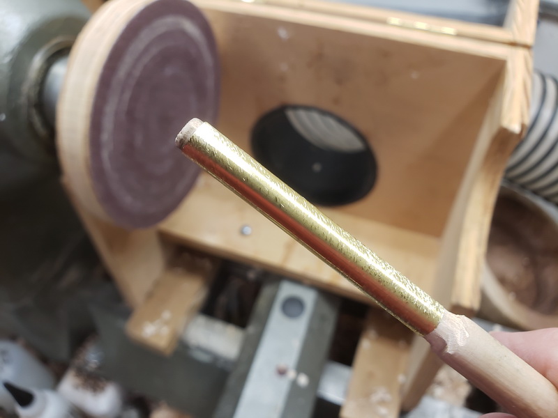

I am getting ready for the PA Farm Show where I demonstrate pen making by turning and finishing a pen. I donate all the pens I make to the Freedom Pens Project. I need to prep 100 brass tubes and of course they are not scuffed. So I came up with a quick and easy way to scuff the tubes. Now I have to go down and cut and drill 100 blanks. Oh MY ACHING.....
That's one scuffed tube.
And it looks good!
So here are ALL the tubes scuffed! Took about 10-15 minutes and was very easy.

Great Suggestion! Was the tube loose on the dowel so it would spin against the sanding disc, or was it a snug fit on the dowel and you had to turn the dowel to scuff all around the tube?

The tube spins freely on the dowel. The trick is getting the correct angle about 45 degrees so the tube spins but the sandpaper still scuffs the tube.
