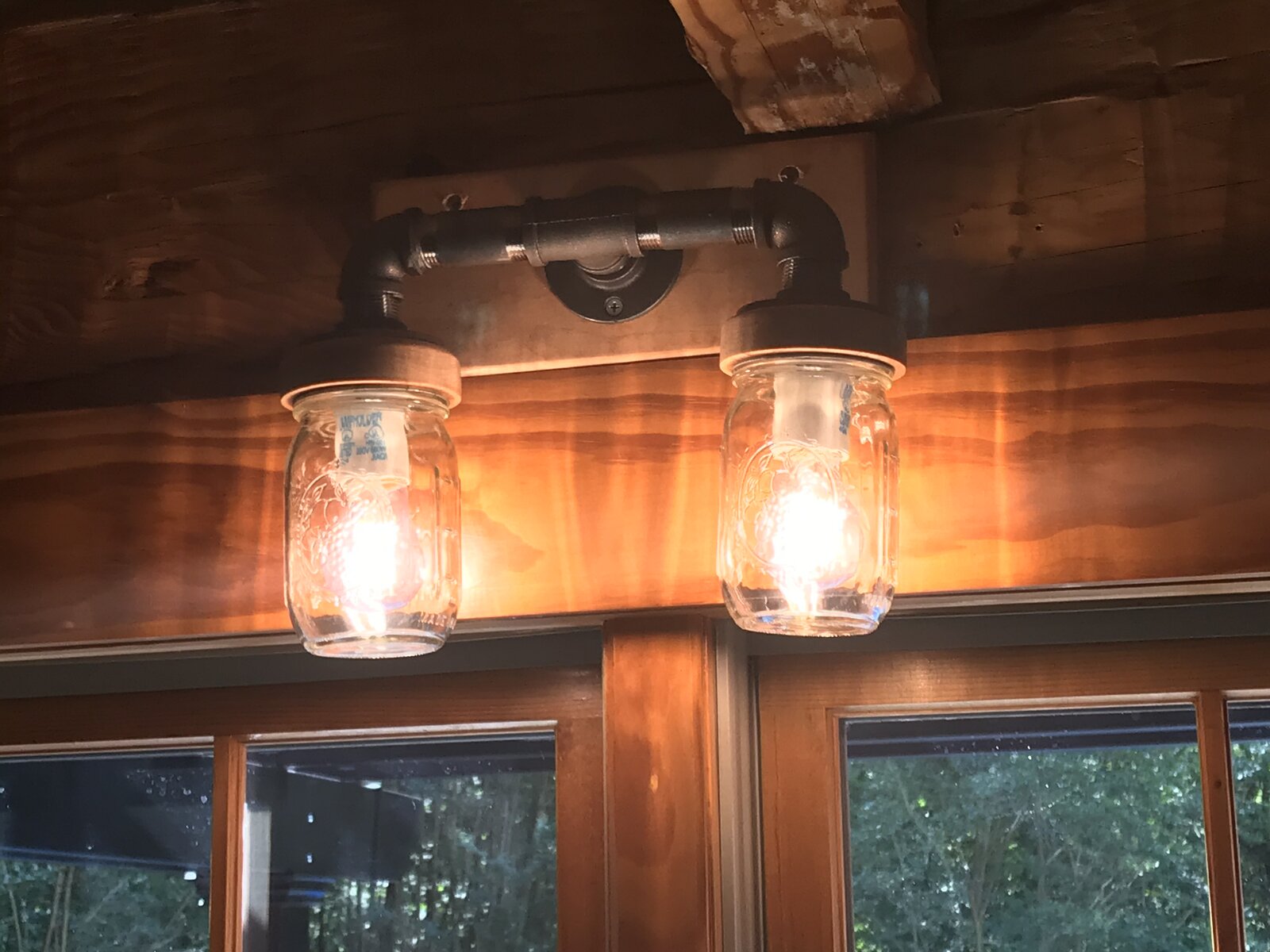

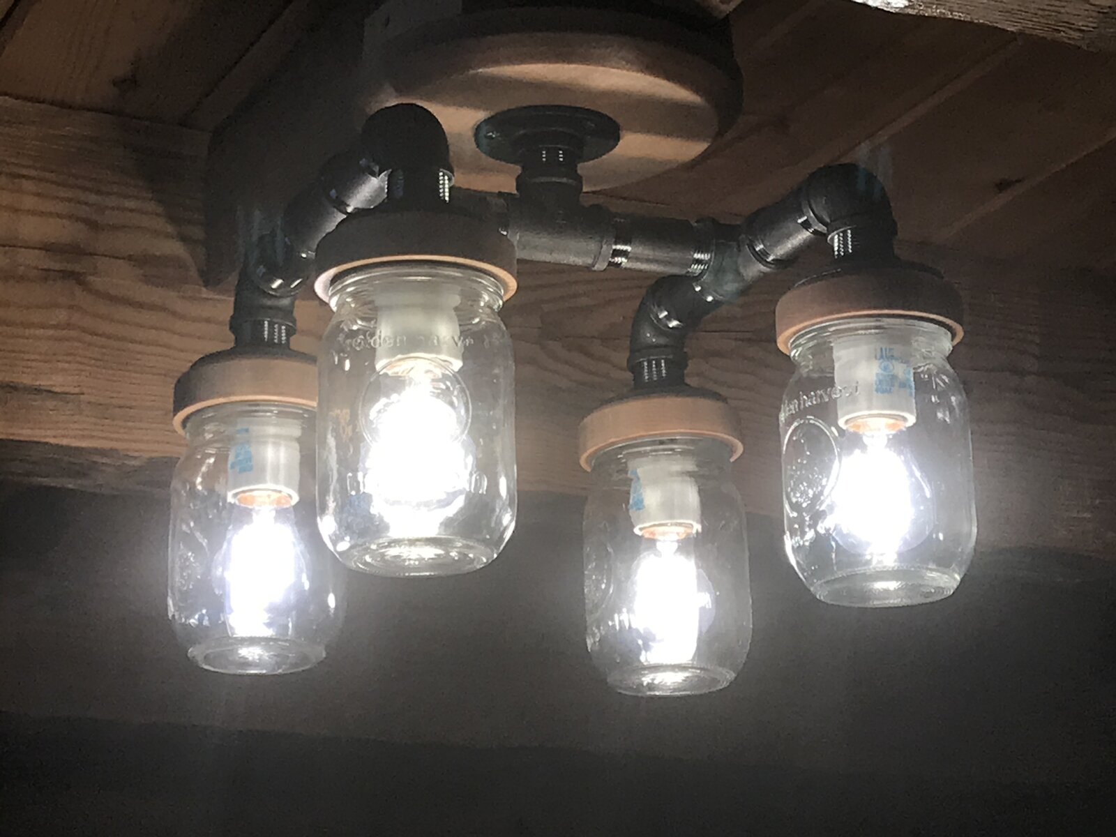

Minimal turning but this project did require several turned pieces.
Cwalker935
May 18, 2014
3,506
Richmond, Va
VERY cool !!!
How did you thread the pieces that are the subject of the previous question to accept the Ball jar being screwed in ?
The canning rings that came with the jars have the threads. I inserted and secured the rings into the turned recess.

I know how to make the caps/lids for the jars, concerned how you attached the light sockets... were they the kind with the flat that you can screw to a wall or some other design??
The ceramic sockets have a threaded hole to screw on to allthread lamp rod. The lamp rod is secured with a nut on top.
