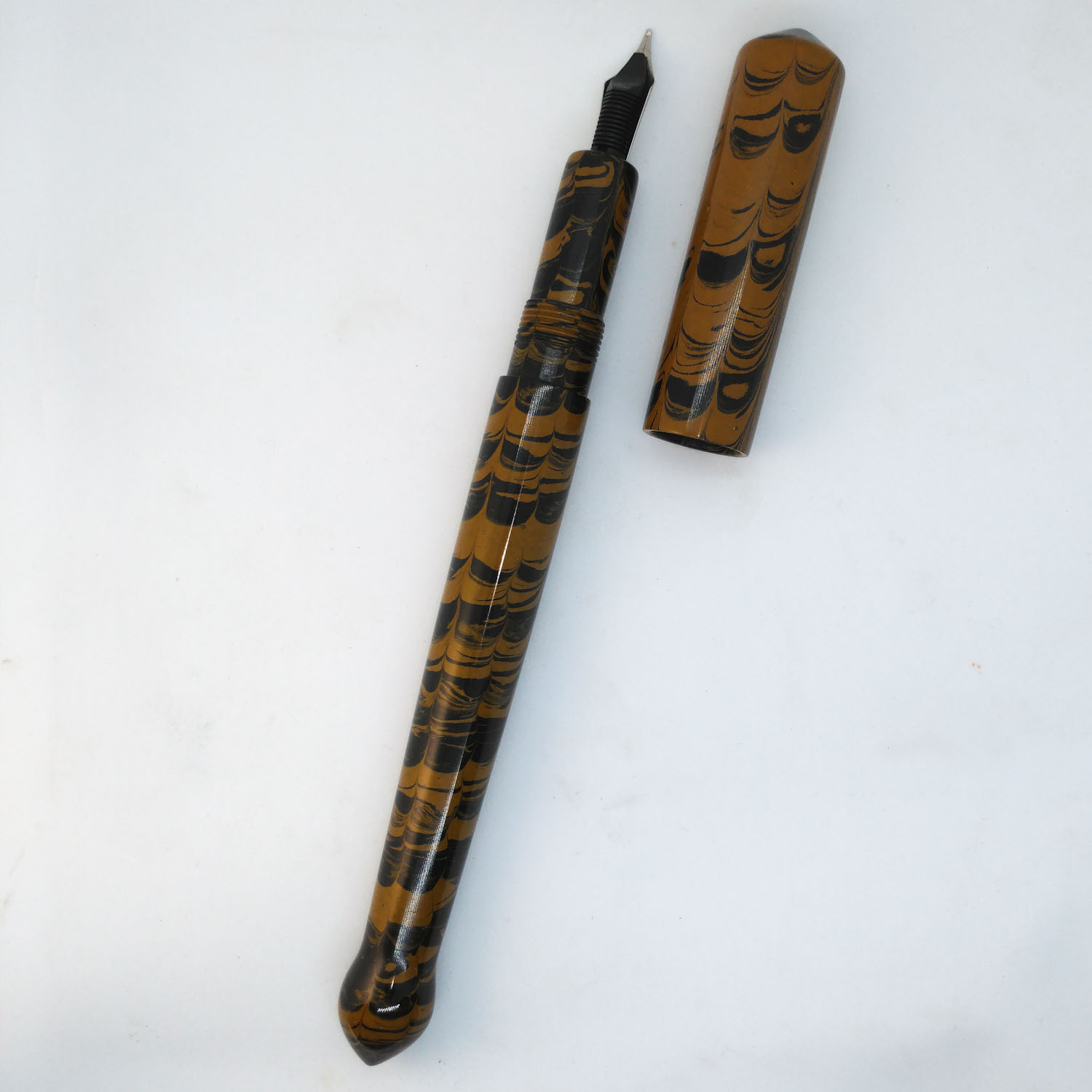

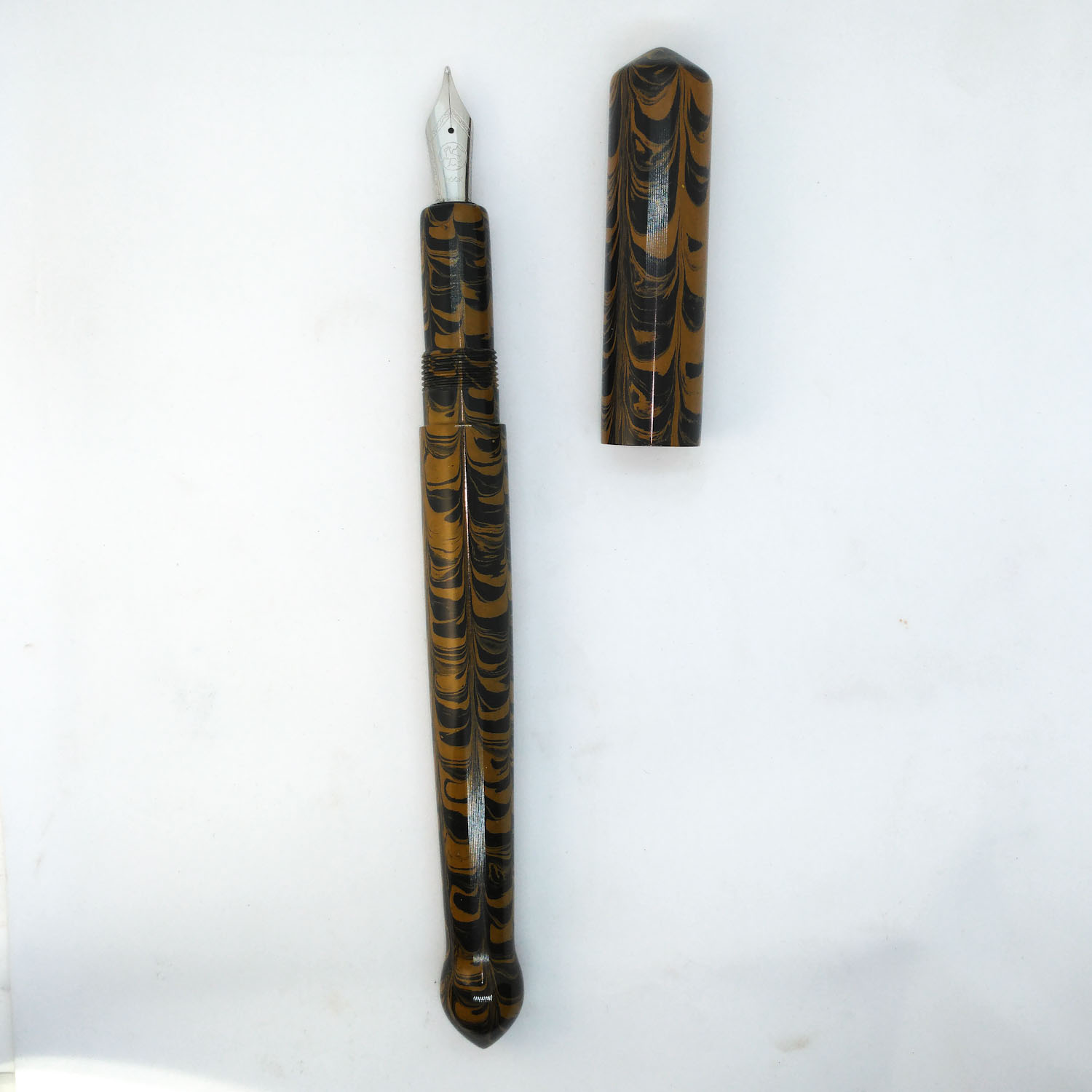

Pictured are a few " long boys" I made recently

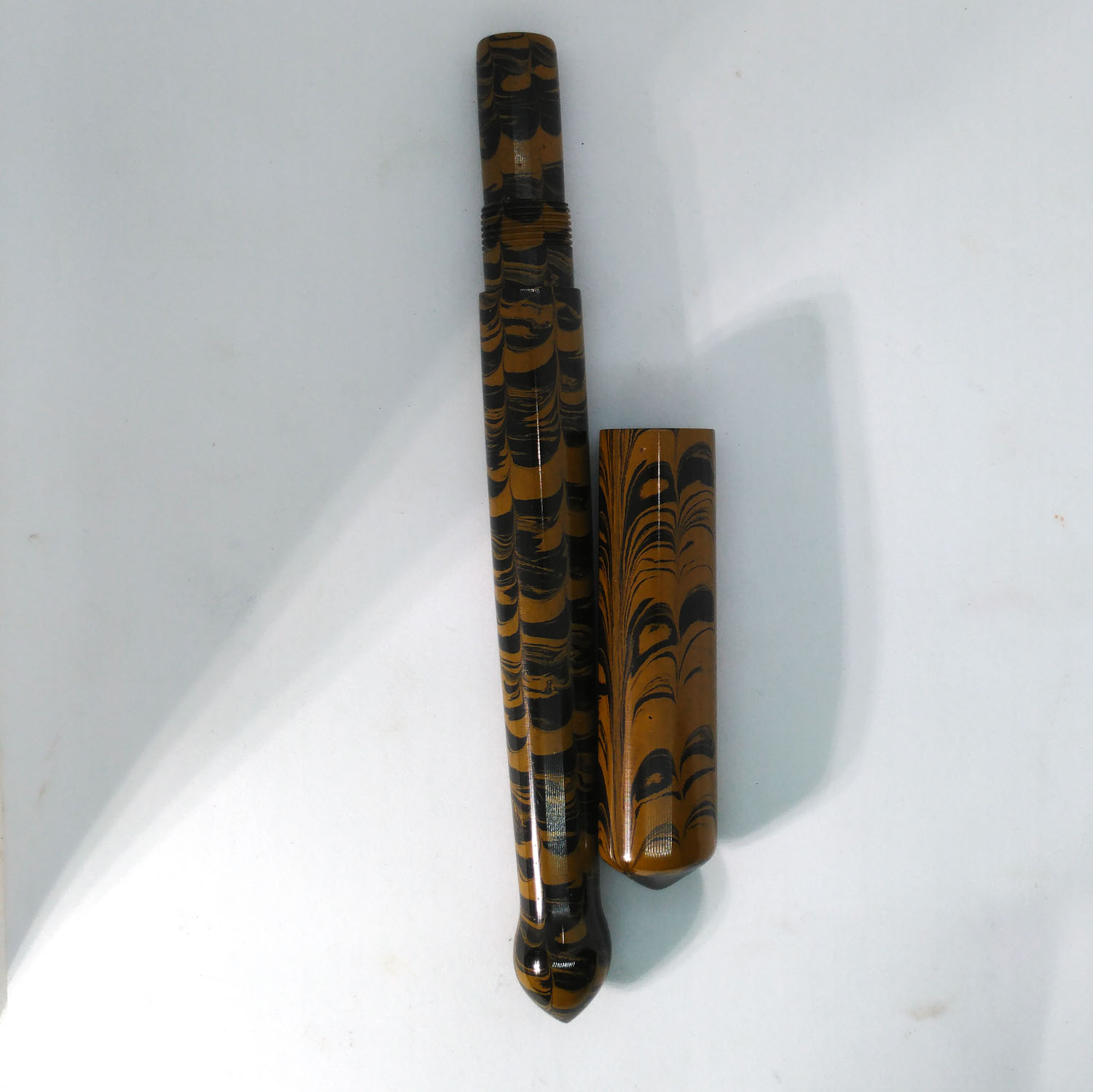

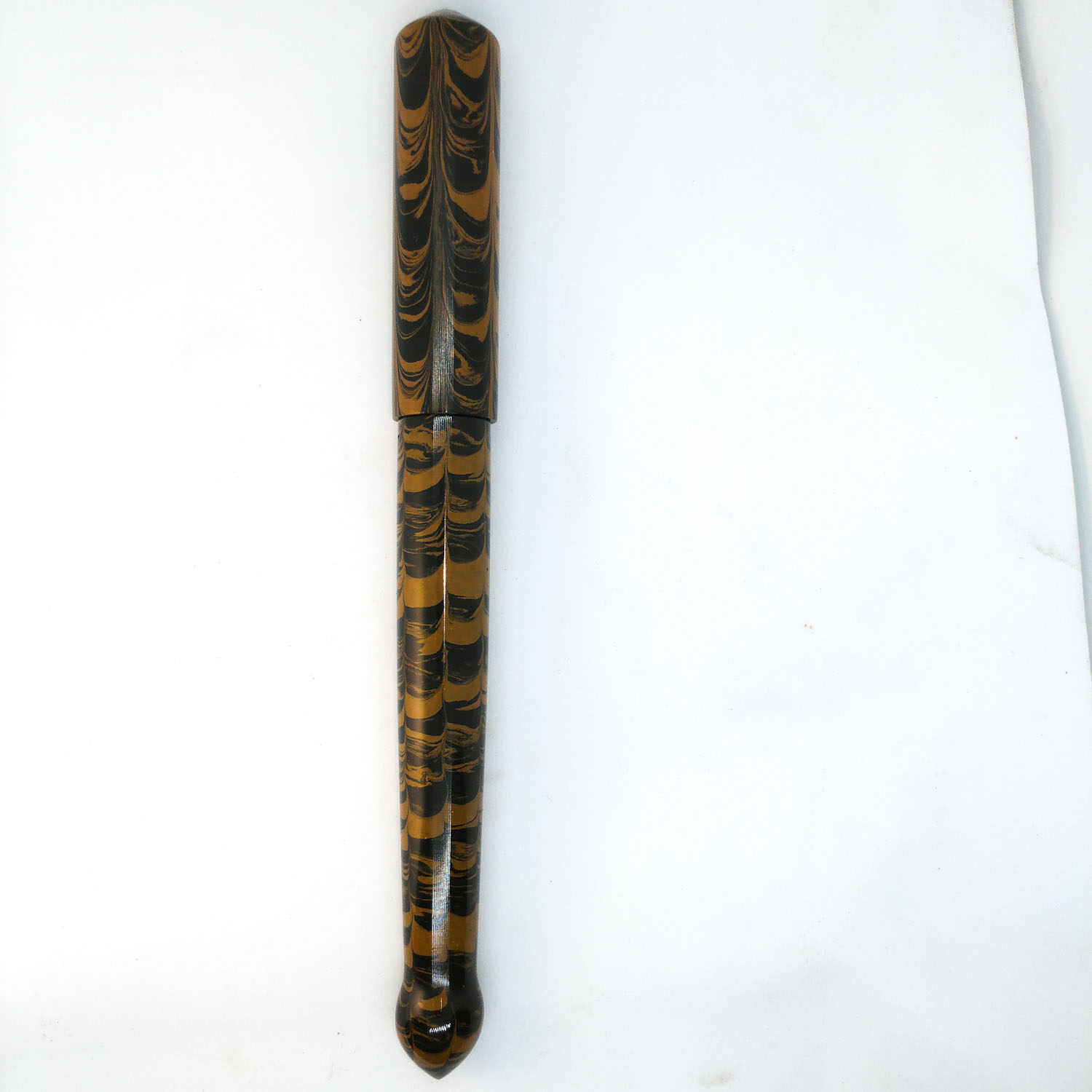

First, black and brown ripple ebonite using a Bock #6 F.P. section.
Cap width 18mm
Body width 16mm tapered to 12.3mm
Total length capped/closed 180mm
Cap to body tap & die M14 x 1.0
Section tap & die M10 x 1.0

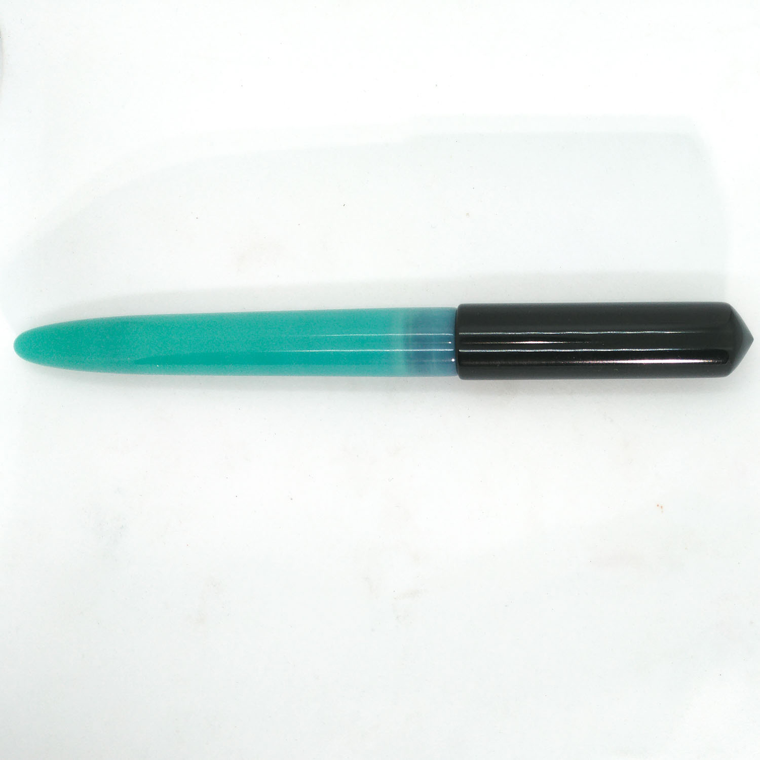

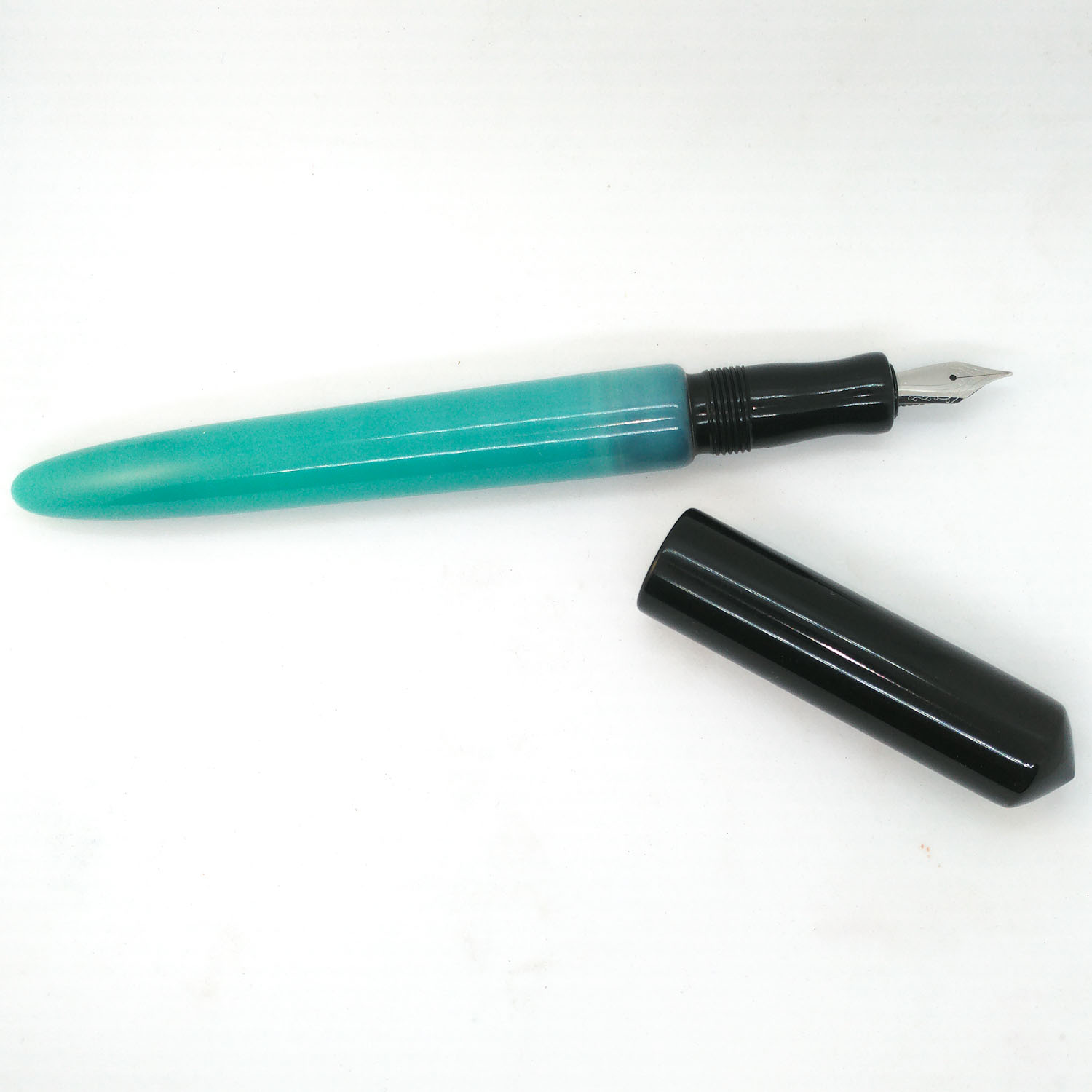

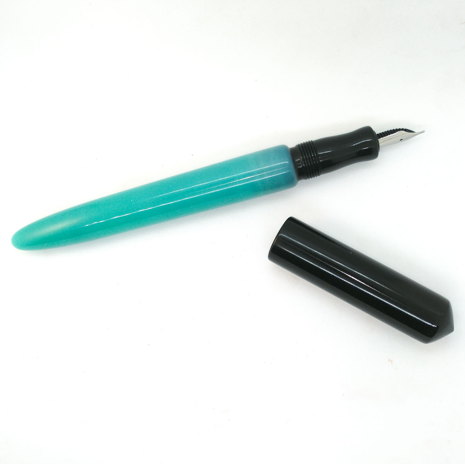

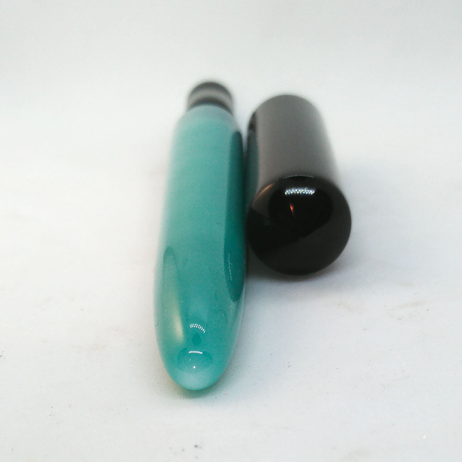

Second, blue marbled casein / galaith with black ebonite cap and Jowo #5 f.p. section.
Cap width 18mm
Body width 15.5mm tapered to 13.5mm
Total length 176mm
I made the body thread tenon too big I believe, its easy to see the black at the neck..

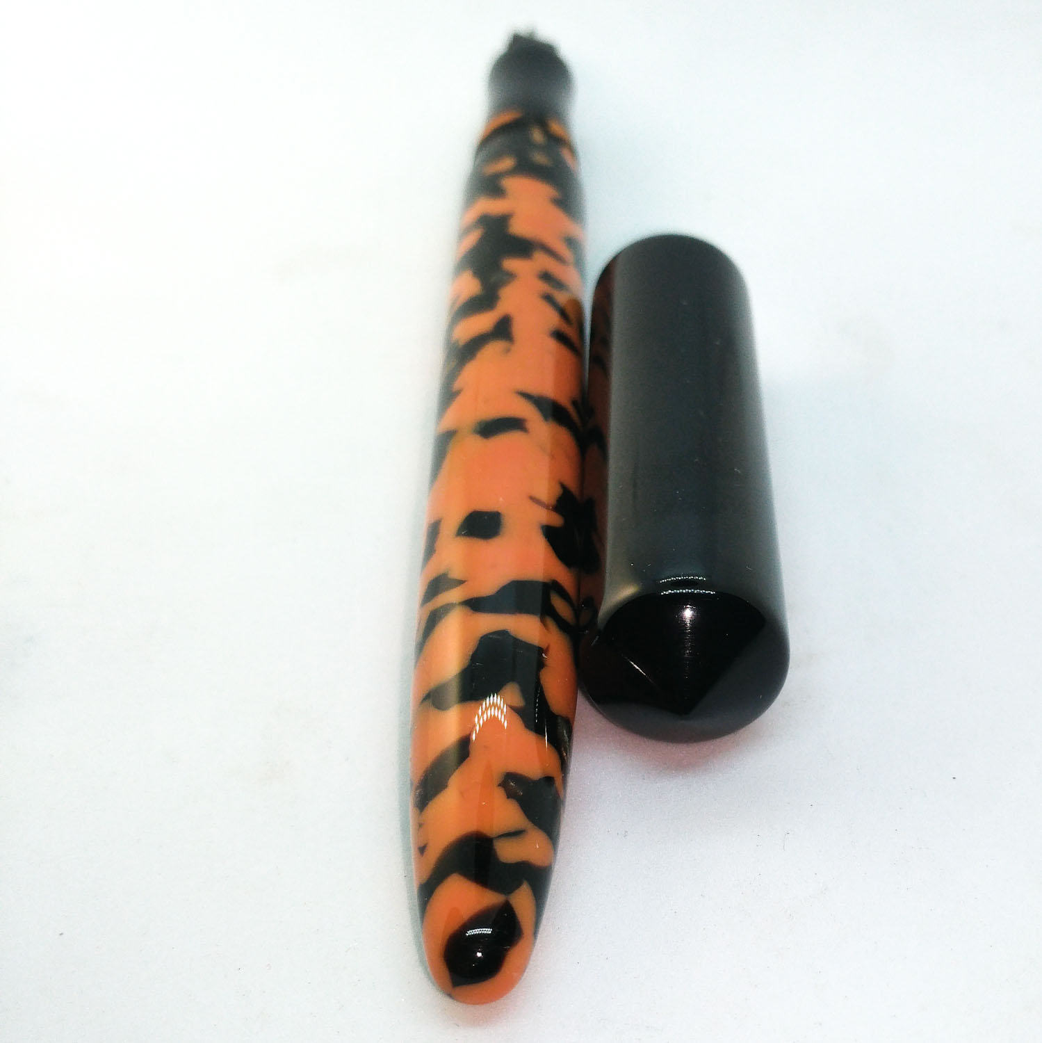

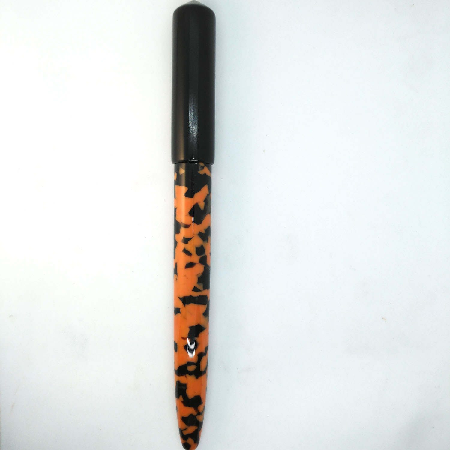

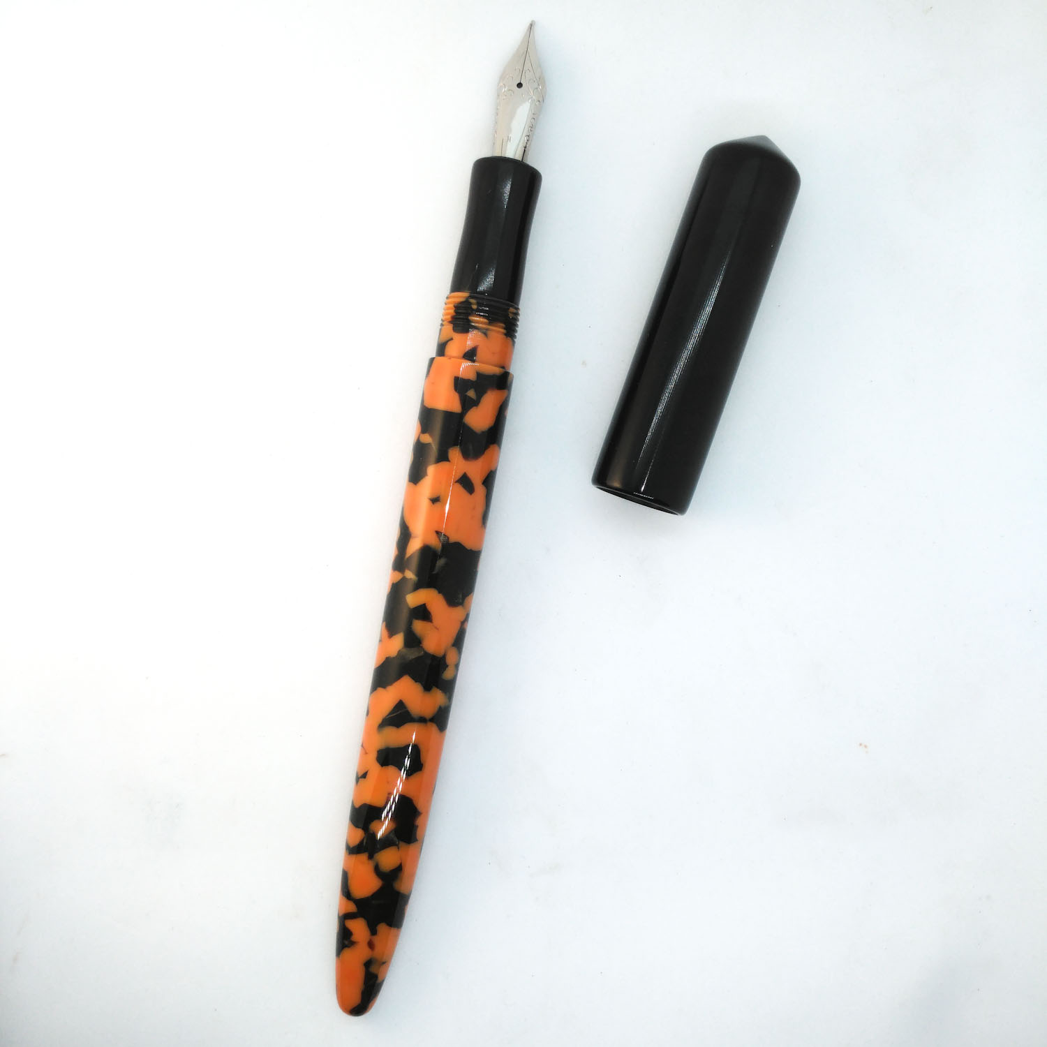

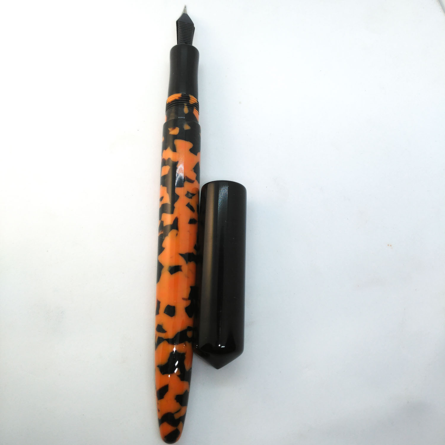

Third, orange & black conway stewart acrylic with black ebonite cap and Jowo #6 f.p. section.
Cap width 18mm
Body width 16mm tapered to 12mm
Total length 187mm
Section M10 x 10
