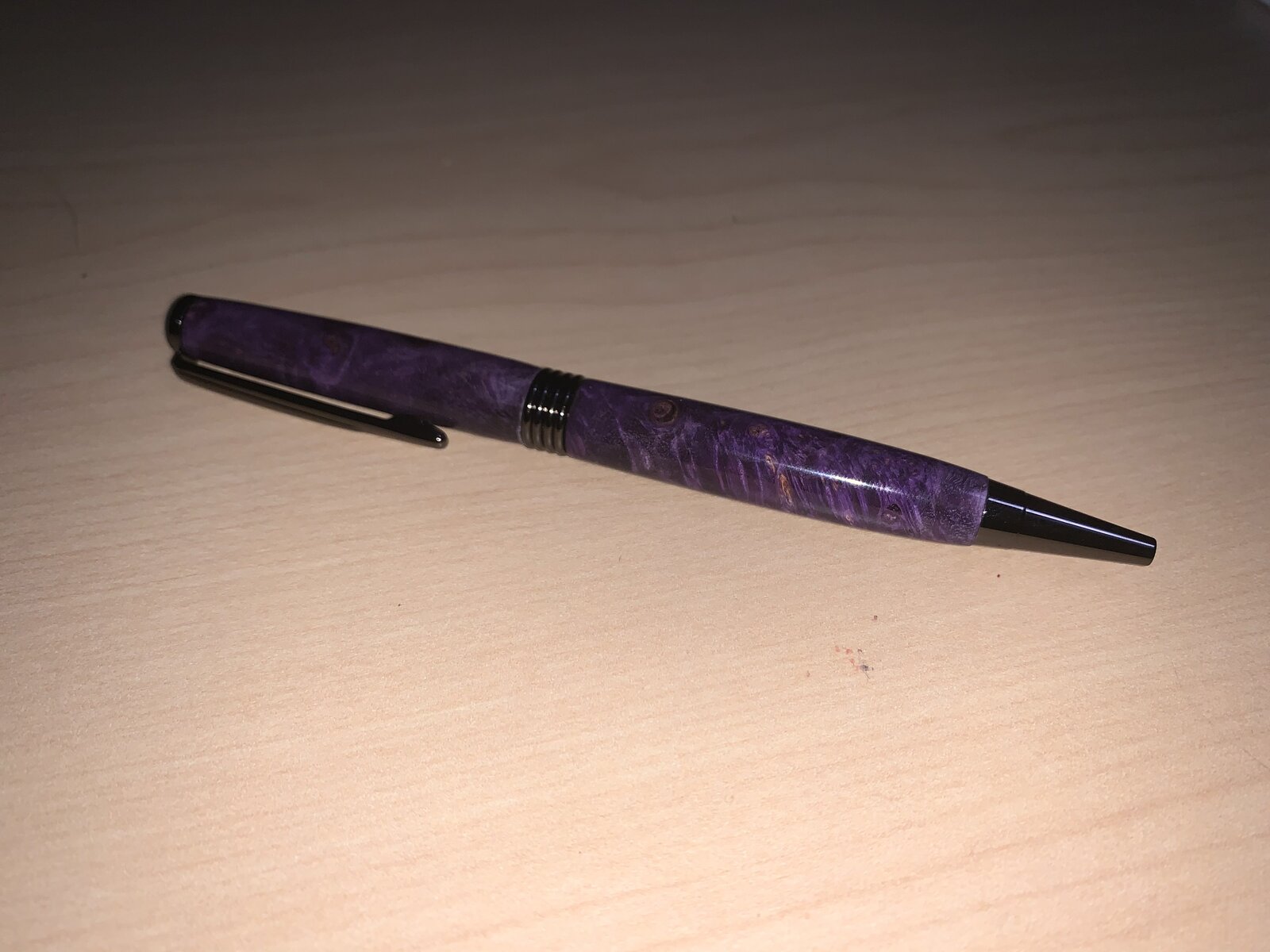

I'm a new turner (just got my lathe at the beginning of January), and have recently started trying a CA finish. I've done about seven pens/pencils and a few other things. For the first handful I used Hut Crystal Coat (https://www.rockler.com/crystal-coat) which gives a really nice satin finish.
I've done a couple pens now with a CA finish and I absolutely love it! My process is:
  • Turn blank (about 2000 rpm)
  • sand wood up to 600 grit (1000 - 1500 rpm)
  • One coat of Stick Fast thin CA (turn by hand)
  • Multiple coats of Stick Fast medium CA (200-250 rpm)
  • Sand with micromesh from 1500 to 12000 git (1000-1500 rpm)
  • Polish and buff
I now know (from reading here today) that I should wait some time before polishing, and probably make a couple other changes to how I apply the finish. But for the pen I made yesterday, I got a beautiful, glassy finish on it. The problem I'm having is when I'm applying the first coat of thin CA. There appears to be some sort of chemical reaction between the CA and the paper towel I'm using and after only a few seconds there's a smoke or vapor of some sort coming off the paper towel. It doesn't happen while putting on the medium coats, though.
What could be causing this? And maybe just as importantly, what should I be using to apply the CA? Should I be using a different brand of CA? I got the Stick Fast from Rockler, in the lathe aisle, so I assumed that would work well enough. And for the pen I did yesterday it did a spectacular job, but I'm worried about the vapors coming off the glue.

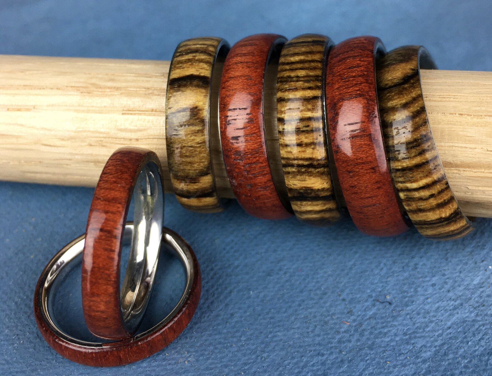

Please wear gloves when applying CA, I do too. I use quarts of CA yearly and get sellable objects. I never sand until after all the CA is applied and has cured. It doesn't crack ever.
I use a metal pail to hold all CA covered Blue Scott towels. Craft foam did not give me the results I needed. For the last several days I've been using 1/2" square blue towels to get finish in rings and not the mandrel. I've been pleased.
