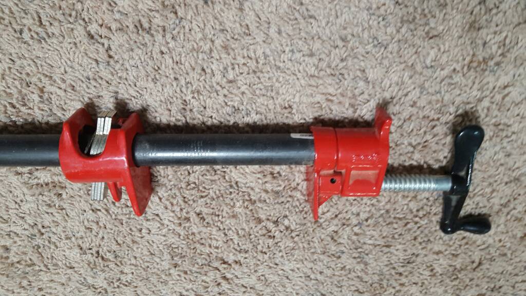

Rebecca is enjoying the hobby more and more. She has been using a pipe clamp to assemble the pens which sometimes presses too hard and cracks the wood or the kit doesn't assemble straight. I have been looking at the presses but we haven't purchased one.
Are the pen assembly/disassembly presses worth the investment? I am interested in any recommendations.

Yes, the pipe clamp is very long and she sits on the floor or in a chair and tries to balance everything. I wish I had a photo, it is quite something to watch.
This is a pipe clamp like this one??
Get a shorter piece of pipe and attach one threaded end of the pipe to a pipe flange and screw it to a base plate or the work bench so it is vertical.
BUT; if you enjoy the entertainment, by all means carry on![emoji3][emoji3]
If hers had those nice feet, it would be easier! This is what her Dad had and it's been working ok but it makes it tricky to get things assembled straight since it won't stand up on its own. Plus she applies too much pressure sometimes using the crank.

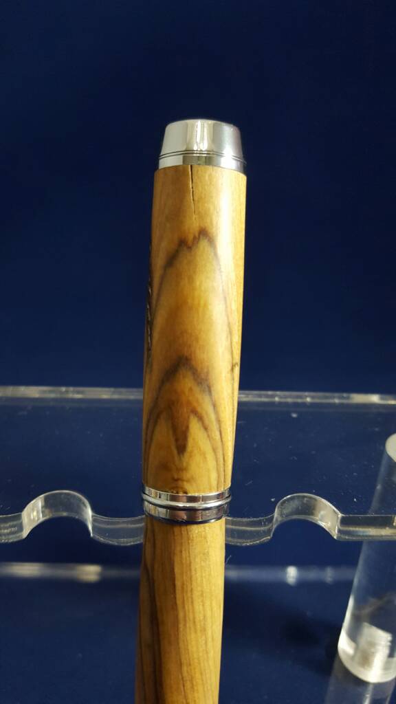

Will using a CA finish help prevent some of the cracks that appear around the top of the pens? She tried her first CA finish this weekend and it was not flawless but I think she was pleased with the results. Just 2 coats of thin but it was much shinier than the friction polishes she has been using.
Here is a photo of one that cracked. It isn't happening on every pen.
That's a great pity -- it was a nice looking pen, and all the hard work has been done at this point. If it makes you feel any better, I can tell you that it's the kind of thing that still happens to me if I don't pay attention to what I'm doing.
The usual reasons why it happens to me:
1) There's some glue from when the tubes were glued in that got inside the brass tube.
It only takes a very small amount -- roll up a small piece of 220 grit sandpaper and polish the inside of the tube end. Any left over glue will show up under a bright light -- I usually scrape it out with an X-acto knife, then sand again to check that I got it all.
2) There's a burr on the inside edge of the brass tube.
You can remove the sharp inside corner using an X-acto knife, a metal-worker's de-burring tool, a countersink drill bit ... putting a chamfer on the corner makes it easier to get the components lined up and started when you are pressing them in.
3) The component goes in crooked -- or -- the pressing tool twists while the component is being pressed in.
I started out using wooden screw clamps, but found the two parts would easily get out of alignment. Then I tried the squeeze-grip clamps, and I found they'd over-squeeze the components.
I used my drill press for a while -- that worked very well, but now I use my lathe. The great thing is I can let go of the crank handle and it doesn't spring open, it just stops exactly where I got to.
4) It went in too far -- applied too much pressure and it forced the component into the tube beyond where it was supposed to stop.
Again, I find the crank handle on the lathe gives much better fine control and lets me stop at exactly the point where the parts are "in" but not "in too far".

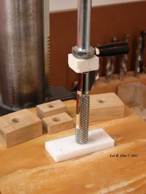

I have been using my drill press for the past 10 years with no issues.
Les
Thanks for the photo! That looks like something we can easily try. The bed on our drill press isnt exactly level though and is something her dad has been meaning to fix. It causes problems with drilling out the smaller blanks. She will have more time this summer to try different tools and tehniques!
There's a trick I learned for testing if the table is level, it's really simple (once you have been told it!)
Get a piece of stiff wire -- an old wire coat hanger, for example -- just a little longer than the gap between the drill press chuck and the table.
Clamp one end in the chuck as you would a drill bit.
Bend the wire so the other end is just touching the table near its outside edge.
By hand, rotate the chuck ... if the tip of the wire remains "just touching" all the way around, the table is level. If it starts to dig in, that point of the table is high. If there's a gap, that point of the table is low.
