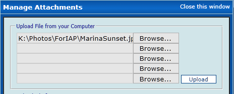

  3. I click "Browse", select the image I want to insert, and click "Upload".
    attachment.php
