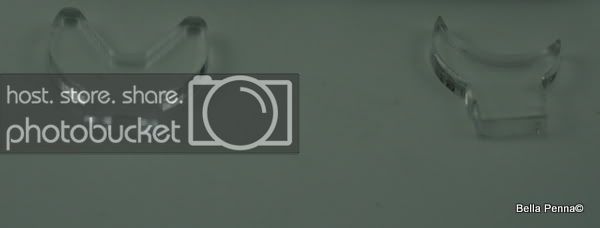

The first group were single stands with risers that were made facing straight up. When I received them the slots for the risers on a few were not cut all the way through and I was able to knock two of them out but the other two I broke . Charlie was notified and he has now fixed that and sent me replacements along with risers that were cut to face forward.

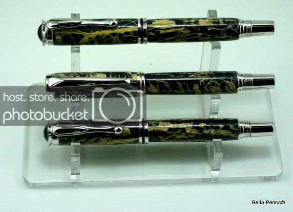

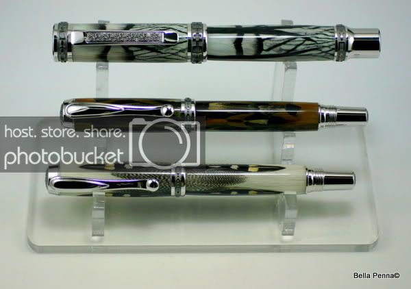

The first triple pen stands were not spaced properly and also the larger pens ( Full sized Gents,Emperor Etc.) were the only pens that would fit on the bottom, unless you posted the Jr. sized pens.
Charlie then redesigned it and it is well proportioned and all sized pens should be able to be displayed.

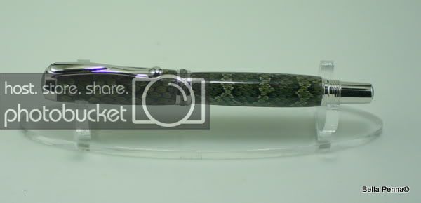

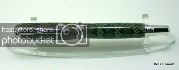

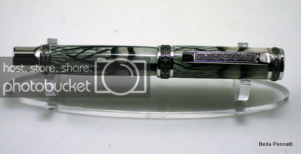

He also sent me a couple of larger single stands for larger pens, I really like them but the smaller one do a great job of showing all size pens and I really don't think theres a big need for the larger singles. In the photos you'll see what I mean.

Here is the triple with a larger pen at the top:
With all same sized pens:

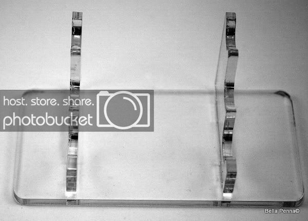

Trible w/o pens:
Large single with large pen:
Small single with large pen:

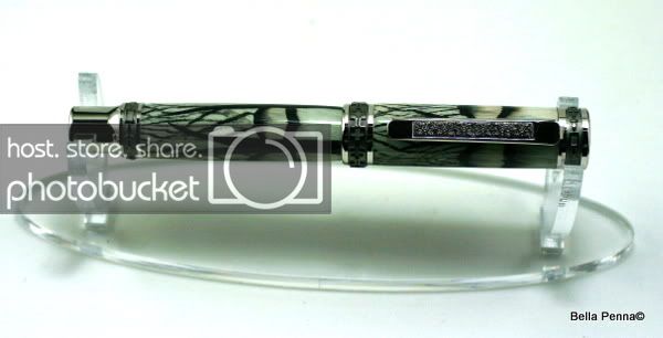

Small single with Jr. Sized pen, risers facing you:

Upfacing and forward facing riser:

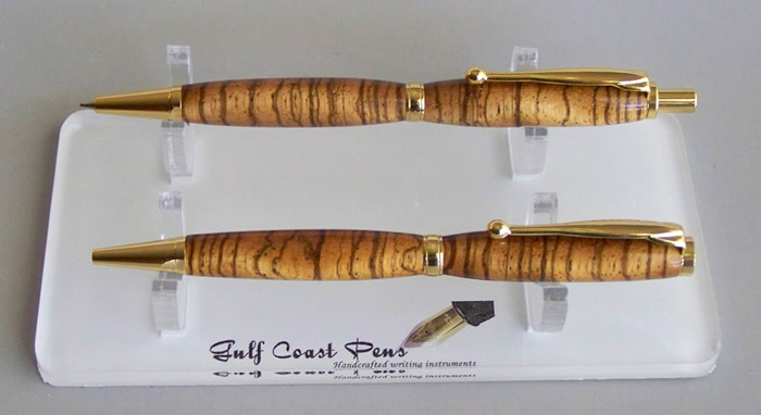

Thank You, Charlie. I received my order today and they look great. Here is a picture of the two pen stand :biggrin: with my logo and white plastic paint.
