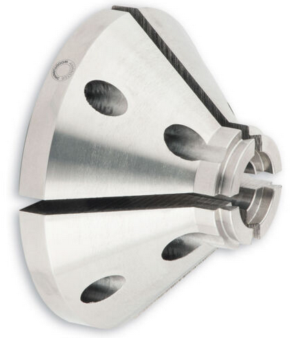

"O'Donnell" is a trade name used by Axminster for their proprietary brand of deep jaws. Here's what they look like:
Other manufacturers make deep jaws - they just call them something else. And one of the unfortunate realities in the wood turning world is that jaws generally are not interchangeable between chucks from different manufacturers. That means that if you want to use true 'O'Donnel' jaws, you will need to buy an Axminster chuck.

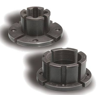

I use a Barracuda chuck (from PSI). They apply the name 'Alligator' to their deep jaws. They look a little different from the Axminster O'Donnel jaws, but they are functionally equivalent. One interesting characteristic of the PSI deep jaws is that they come in two diameters.
The Nova equivalent is the 75mm 'Longnose' jaw set.
Chucks are convenient, and my experience is that deep jaws are generally more convenient to use than their shallow counterparts - they get the workpiece a little further away from the chuck body, providing more working room on the back side of the workpiece and minimizing the risk the chuck striking a knuckle (ouch!). That said, they are usually not essential. Unfortunately, the jaws that come with chucks are the standard (shallow) versions, so if you want deep jaws, you have to buy them separately.
