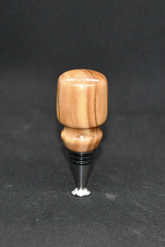

Gluboost showed up today. I'm lucky to live semi close to Penn State Industries so its usually only 1-2 days. I can see how I might need a little more activator. Im sure this will take some learning curve. But Wow! What a better finish all around. the combination is great. Attached is the resulting bottle stopper.
Do you use blue shop towels to apply or something else? I know someone said bubble wrap but just wanted to get a general idea of whos using what.

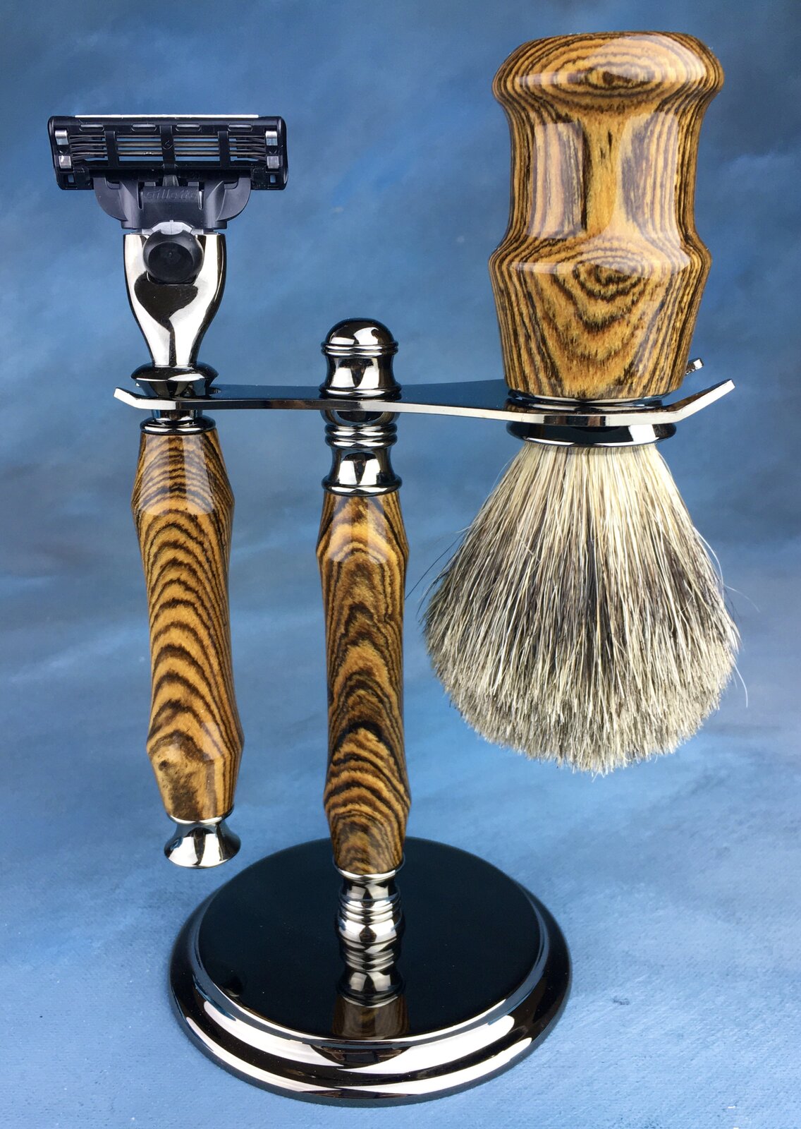

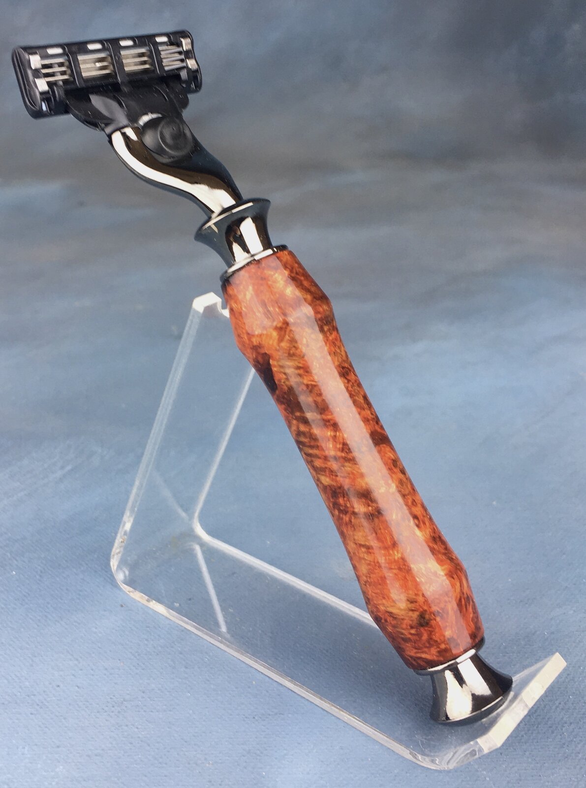

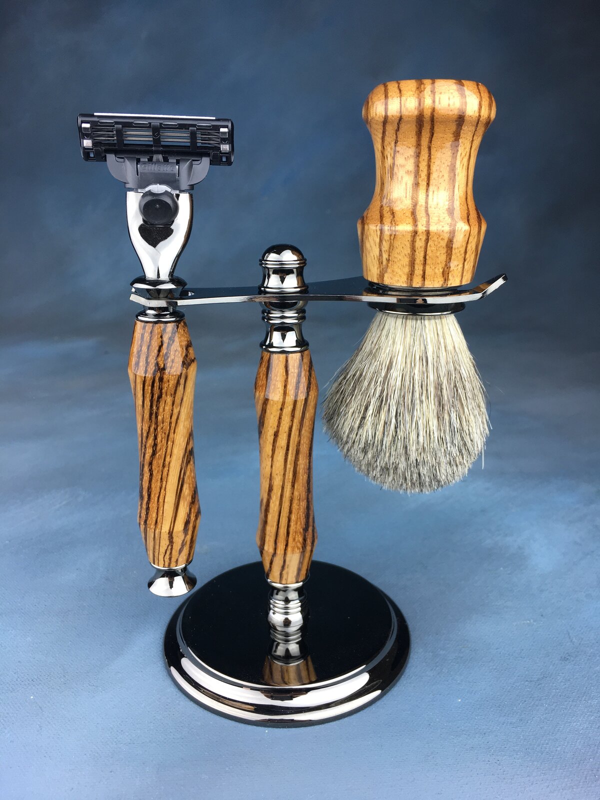

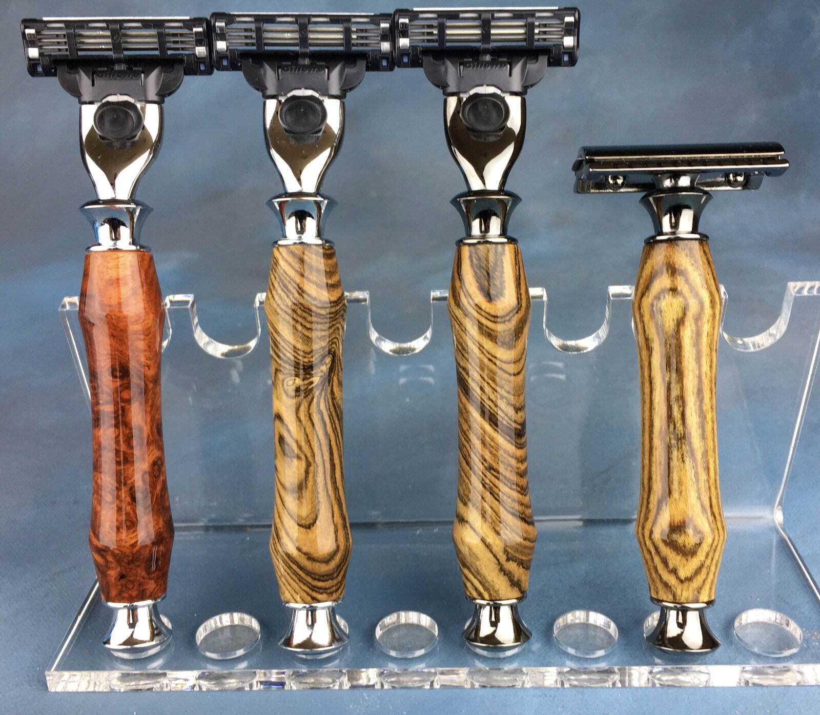

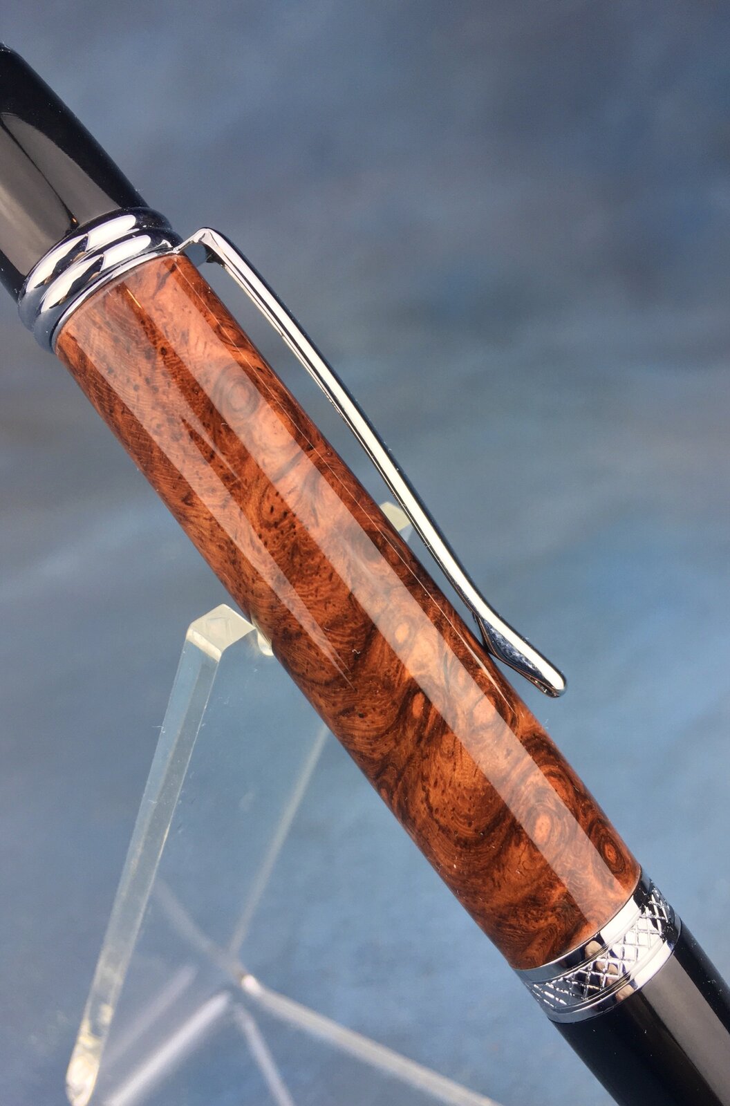

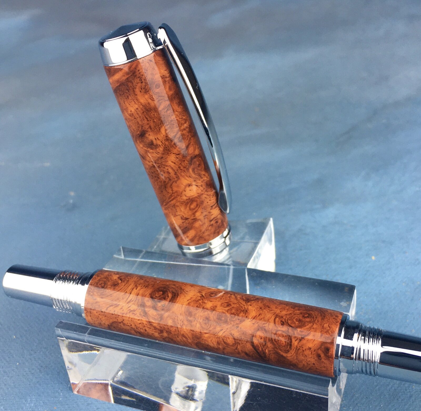

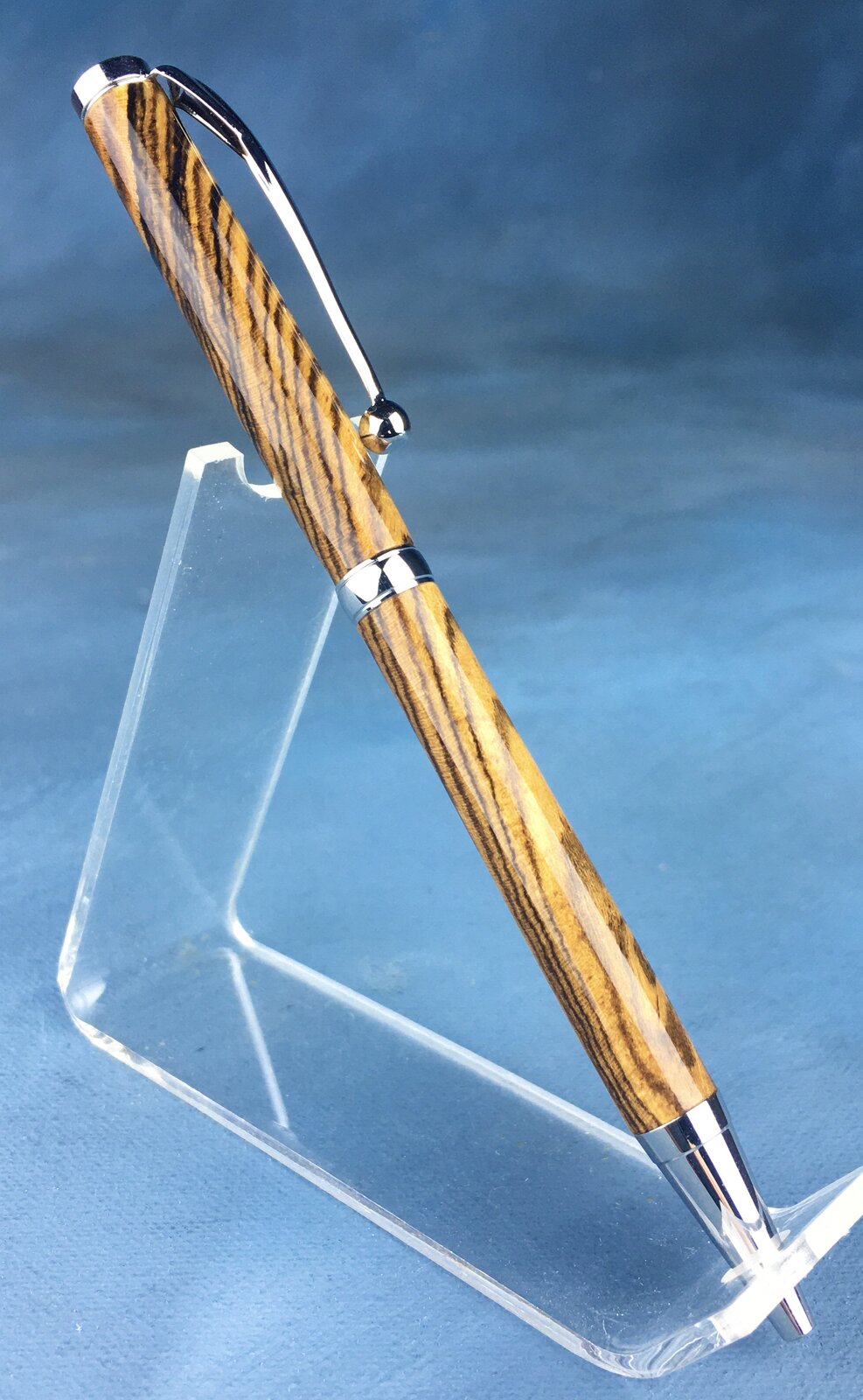

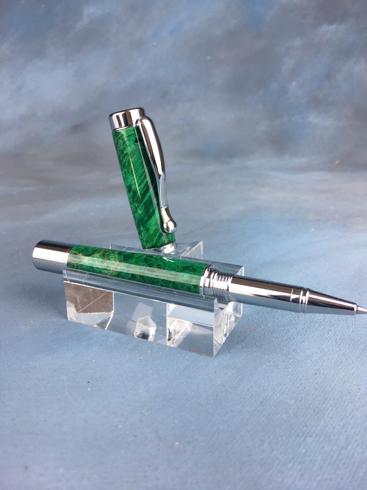

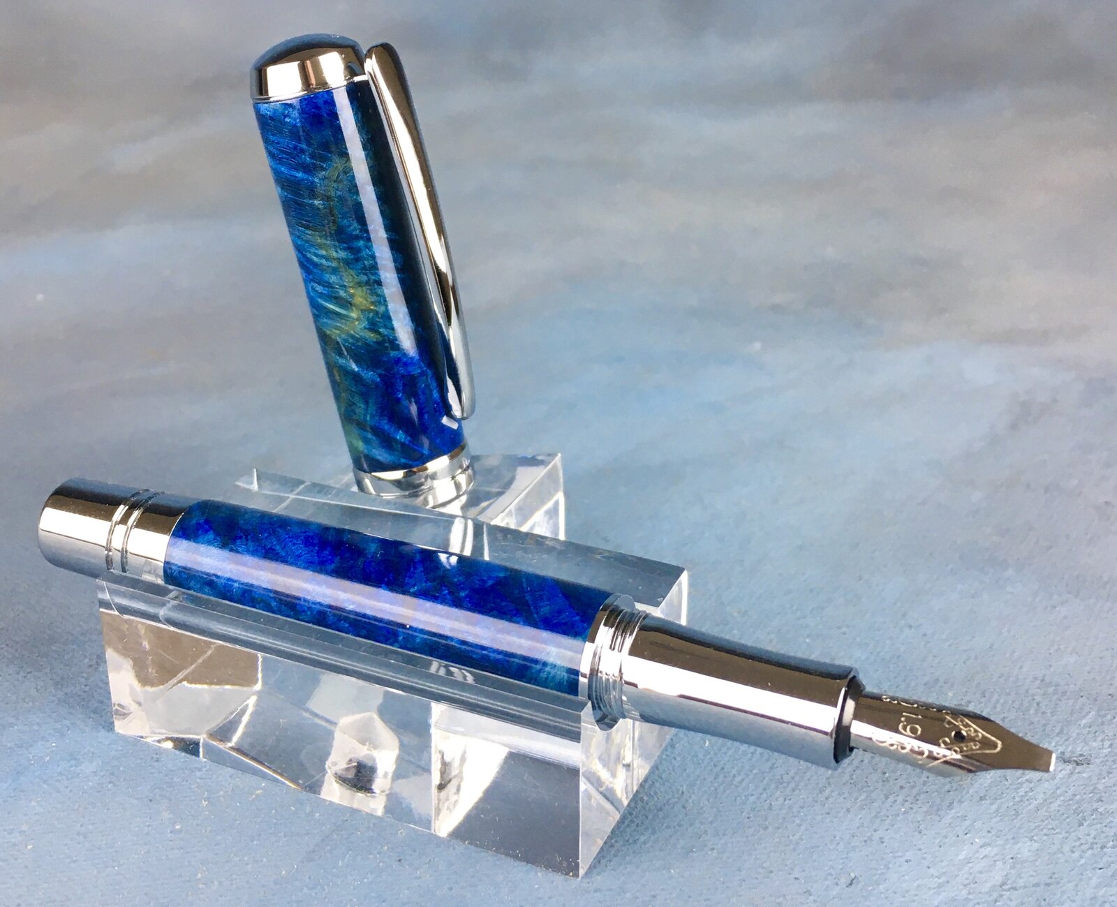

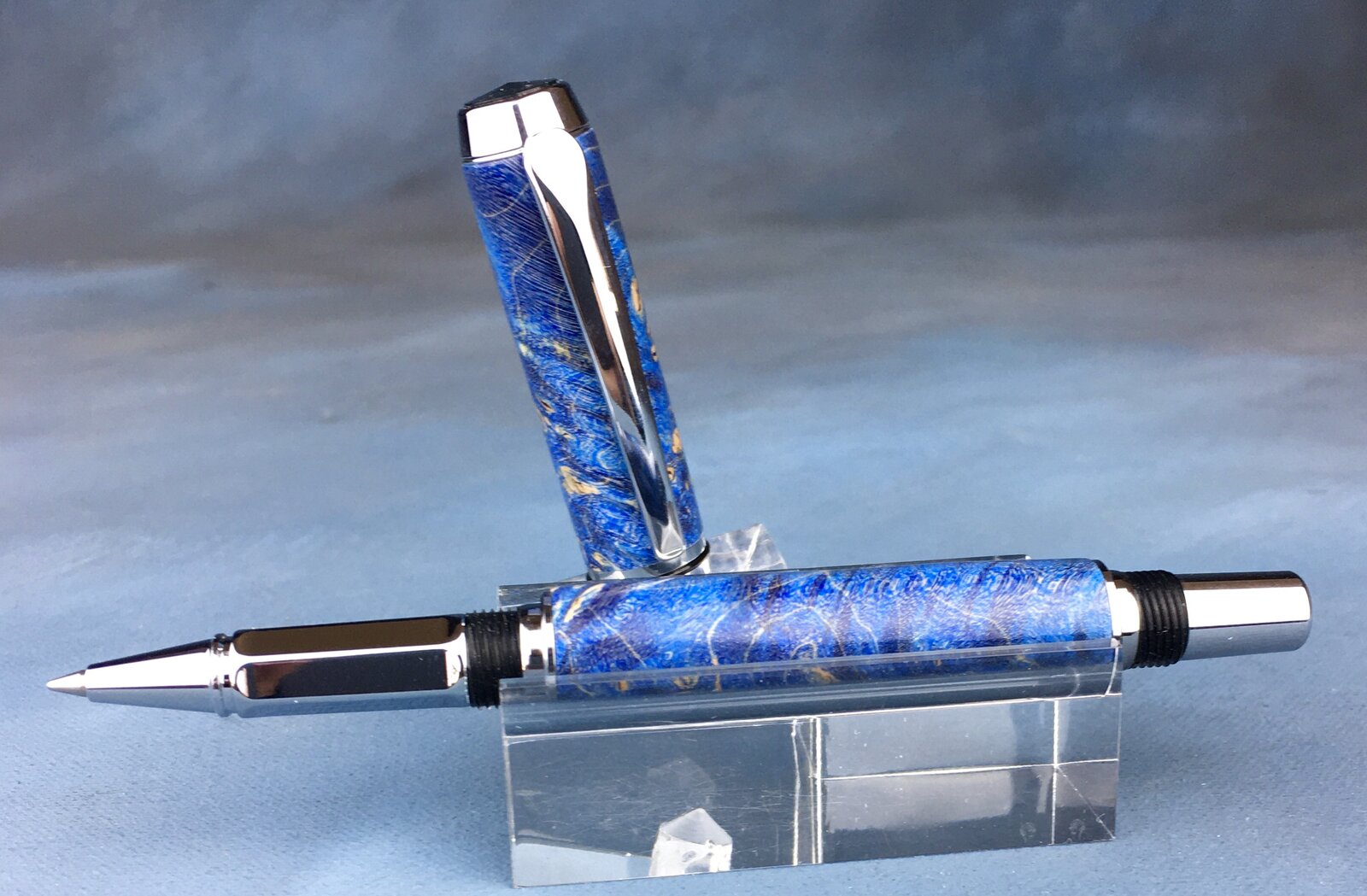

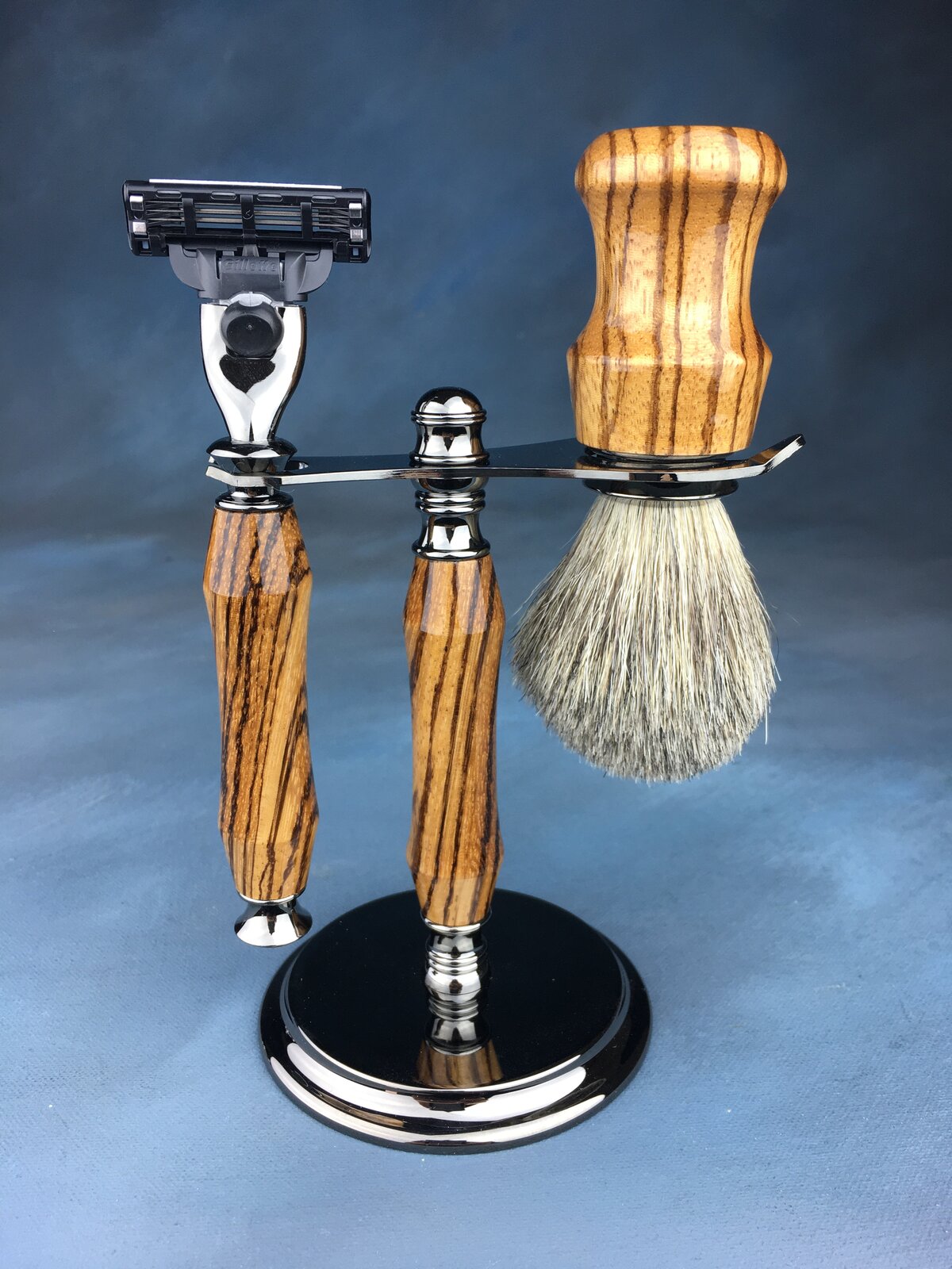

My 2 cents
I have tried five different CA glues but not Gluboost. I get very saleable pens, bottle stoppers and shave sets every time with EZ Bond CA. I've stopped switching and kept to a rigid routine. I think everyone that can't get finishing to work changes too many things with each attempt.
Stop it!
Try changing only one thing for a while. Think about it every time until you get it right. Be precise and extra careful until you get good results. Stay with that even if someone in IAP has the new Kool Aide. For them it works, you maybe not so much. Resist and make great pens consistently. Change is not always good.
Proof! - the photos below.
EZBond thin 5 cps four coats
Stickfast accelerator LIGHT! Spray
EZ Bond 50 cps or medium 8-12 coats
Stickfast accelerator LIGHT spray after each coat
Let cure for one hour or overnight
Sand with 400 grit
Buff with the first two wheels in the Beale Buff
Admire your work and sell it
