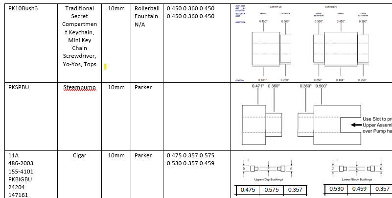

There's a bushing and tubes spreadsheet in the library that I use whenever buying a new style kit.
I look up the bushing size of the new kit and compare it to the bushings I already own to see if there is a match.
27 Complete Suppliers Bushings & Tubes 1-1-2021.pdf
Example of my tracking
