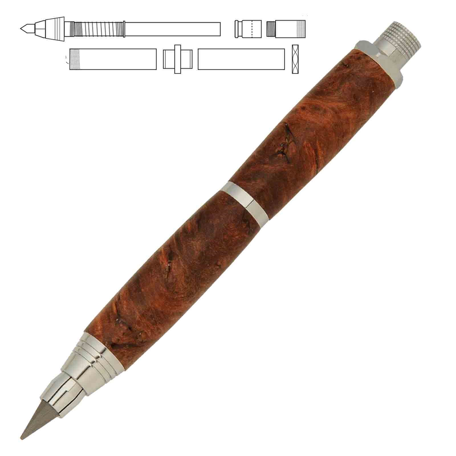

7mm is pretty big being over a 1/4" thick. 5.3 or 4 is the biggest I know of, workshop pencils take them. Are you actually wanting a .7mm lead?

Best I can suggest 5.6mm Sketch Pencils that Penn State sell. There are other platings I think. Just pulled up the first couple I found.

Hey guys thanks for your response. I meant to say .7mm lead instead of 7mm lead. My bad, I don't get many requests for pencils.
